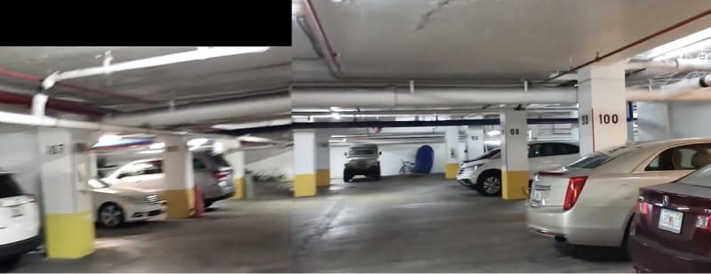

The column in the foreground is labeled for parking space 96. It is a red column. There are a number of these in the garage walkthrough video and they all have a small box on the front (facing the driving lane) that may be either a fire alarm or an intercom to security; I do not know.
I combined two stills from the other video that had a garage walkthrough, to show this area before (which includes the column that unfortunately blocks one of the lanes when you get to the NW corner - parking in this area must have been a challenge). This view faces north and is the westmost area of the parking garage. You can see the column with 96 but a car blocks the red base of this column. However you can see the box on the front of that column and also the large dark pipe that runs E-W in front of this column seen in the rescue video. The parking garage numbers followed these rules: only two sides of a column were numbered. The numbers on the sides of the columns always faced the direction a car would be driving if coming into the garage to park. They always indicated the space before that column. The other numbers faced the front of the column and indicated the next space (on the far side of the column). In this image you can also see a fire extinguisher on the column past the 96 column but the 96 column blocks the view of the missing column next to it (seen in the rescue video) that is not on the garage floor plan. However we know it is there because that parking space is wider. Above the car behind the 98 column you can just see the column that is labeled 118.

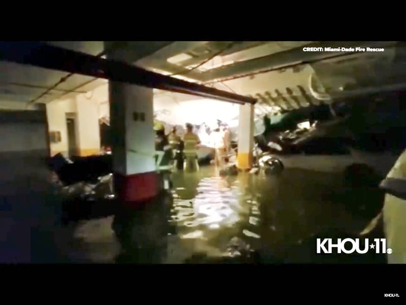

This is another still from the rescue video showing the column labeled 117/118. The 117 is on the side and the 118 on the front facing the lane.

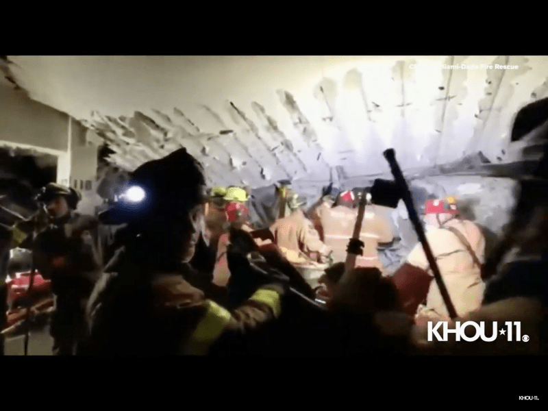

This view shows the view to the collapsed portion of the building with the fallen ceiling on the east, and is underneath the 05 and 04 units. The 05 units were the corner units and the 04 units were just to the east on the north-facing side of the building. I have marked up the garage floor plan below to indicate the view seen here. This is not a view towards the lobby and does not provide any information regards collapse in that area of the building. I have added to the floor plan the fire extinguisher, missing column, direction of the parking spot numbers on the columns, the point of view of the camera which is looking to the northeast. I included a second floor plan showing the line between the collapse and the remaining building, which is how I was able to note this location on the garage floor plan.

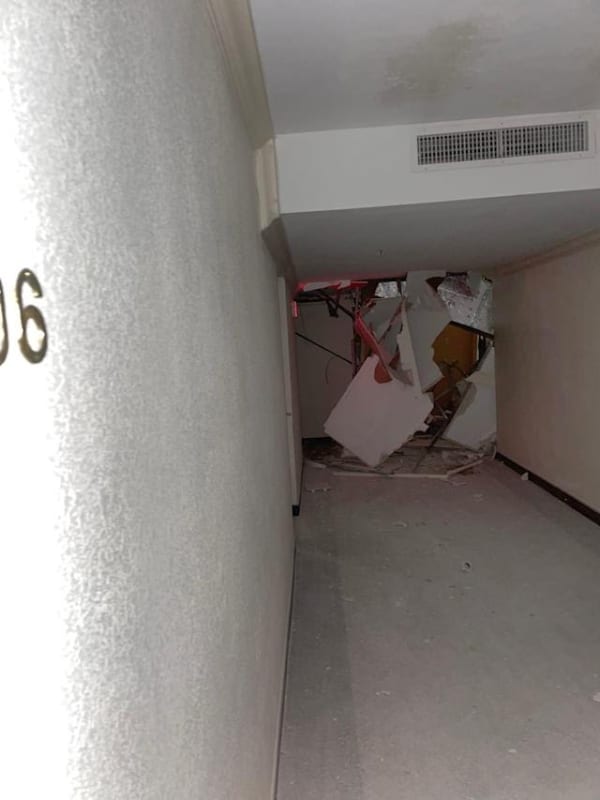

Found this pic that was taken just after the collapse by a resident on the 8th floor in the part of the building that remained intact:
To my knowledge, this is the only photo in the public domain (for the moment) of the interior post collapse. Story here:

There's also this photo of the building internally too btw, taken by the resident in 705.. I think the door on the left is 704 -
