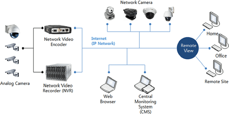

Santos - does this cover all channels? How long are these kept, and what kind of cost are we talking about? Is it full resolution? Does it obviate the need for an in-person guard?
I’m aware that this is possible, but as you said, not entirely common. Regardless, I can’t imagine a modern system with the storage on site but separate from the monitor.
Js5180, The modern ones are actually the opposite.. they're more likely to have a monitor that isn't near the actual storage. Storage in AWS is crazy cheap these days too.. as long as you're only storing around a week of data, you can store a lot up there without paying much. Storing a TB up there is only around $25 a month, and that'll get you pretty far.
I'm used to working on systems for much larger companies really, but a modern system could look something like this. Although I don't think the server has to be an NVR, it could just be a regular computer too. But yea.. even the CMS doesn't actually have to be next to the monitor up front.. or to the storage on the backend. Usually all of this stuff though is stored in a locked network closet somewhere.. sometimes with the HVAC systems. Could be up front, who knows.

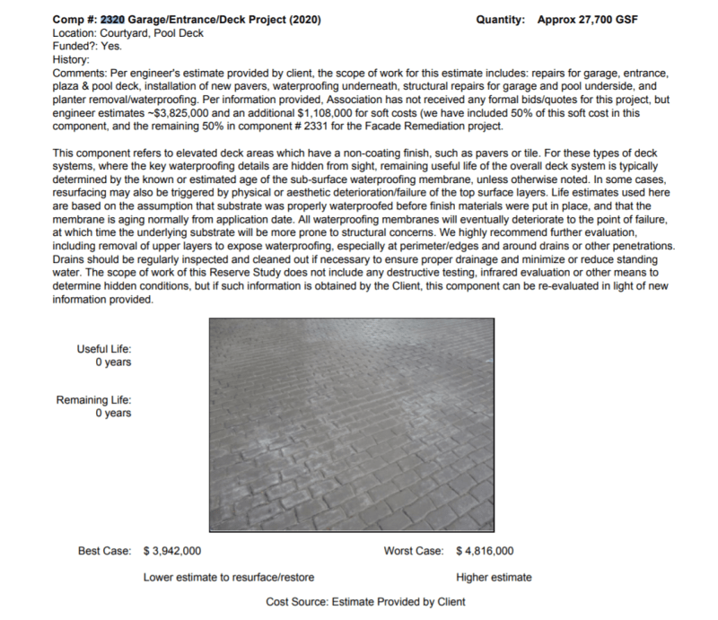

boo1 said:
Where is the major structural work?
"#2320 - Garage/Entrance/Deck Project for 4.4 Million" listed on page 3 of the executive summary.
Page 47 "structural repairs for garage and pool underside, and planter removal/waterproofing"
I'm sorry, but the "Planning For The Inevitable" (trademarked!) at the top of the report made me laugh/cringe when I read it. They might want to come up with a new catch phrase.

Couple other interesting items of note in the Reserve Study report:
It states the security surveillance system is from 2017 but still recommended replacement due to advancing technology, and inadequate resolution.
It confirms the fire alarm system has 27 flow sensors, which should have triggered the alarm when flow was sensed in the sprinkler system. Question remains why the F/A didn't activate when sprinkler lines broke in the garage. Speculation here, that these devices either weren't working or were deactivated to prevent false alarms.
Yes. The fire pumps should have activated when the system lost pressure through the broken lines. The sensors were most likely not flow sensors, but low pressure sensors. Flow sensors might not trigger on a slow leak that might even drain the system after awhile. Pressure sensors don't distinguish between pressure lost due to a sprinkler activation by fire, or due to a broken feed line. Low pressure by any cause activates the alarms and turns on the fire pumps (if there were pumps required in that system, probably so for that height). It seems the fire system should have activated to flood any line breaks, if not from pumps, just by the city water pressure alone.
Kind of points to feed water break at supply source, or the entire fire system was deactivated, not just the alarms.
