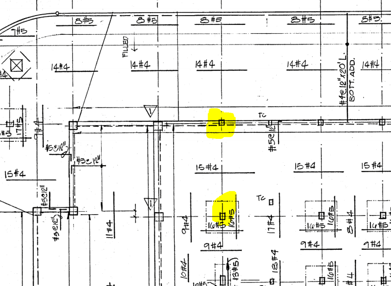

Great computer 3D models with critical columns circled. This collapse theory is from the bottom up and that there are no beams in the building above the first floor, which allowed an extra floor to be had for the same profile height as all the other buildings on the street. In Spanish. I'll do a translation later, or if Geezer is around ... his translation the other day was perfect, so maybe he could help out till I get back to it. Gotta run right now.
One thing that is useful to estimate sequencing is that wherever we see the lines of rebar ripped from a slab soffit, we can infer that the adjacent slab collapsed first. That should be act as a sort of compass for the investigators to follow towards the initial failure point.
Jbourne,
I’ve been struggling to reconcile the 711 video for the reasons you’ve mentioned. The wall as appear to show that the left side of the room has descended. The dust shows the opposite. The table movement could be either - it could be pushed rightward up the floor by the out-of square wall at the left, or it could have slid rightward, downward.
However, the biggest problem I see with column 27 falling with no significant precursor on the roof is this:
If column 27 and those above it descended, we should be seeing the penthouse roof directly over it forming a V. That slab is the thinnest in the entire building.
The initial images indicate that the penthouse roof west of that column stack is 15 feet or so further down than the roof to the east, despite being supported by the exact same column.
While I agree that column 27 may be the main cause here, the differential collapse at the penthouse level needs additional explanation.
I’m thinking that what we’re seeing in the video is a cloud of dust, directly over the x11s, where the western end of the penthouse has collapsed prior to the main collapse - perhaps by only milliseconds, or possibly minutes, but earlier either way.

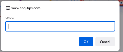

Click on the Quote Icon.
Now you will see;
Start typing or pasting.
You may add a name, a title caption, an attribution, or any comment that you wish or you may click OK to leave this blank.
Then click on OK.
Now paste the quote.
To finish move your cursor out of the quote.

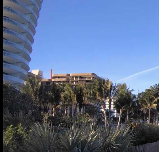

Part of the building's roof has certainly already collapsed in that surveillance photo before it starts, but I can't make much sense of that really. That's probably why we don't see that clear V you're expecting at the roof line though. You can see it on the mid-floors around those lights that are on once you add in some level parallel lines for reference.
This is the closest before shot I've seen to their surveillance video, and it makes it clear how that roof line should have looked from that angle when it started - The difference between where those white lines that go up end (at the 8th floor near the x11 rooms, with the two room lights that are on in the surveillance photo around the 8th or 9th floor) and the roof is strange since so much of it seems to be missing. But it still seems possible that they just collapsed a bit early because of the stress the missing column in the garage was putting on them.. the 711 room seems to almost twist internally as it starts to lean to the right, and the penthouse had a lot less columns supporting it. When that video starts column 27 is probably already collapsed. The person who escaped 611 also said that large cracks were starting to form, and this seems to be around when the tiktok video was shot and before the ring video started.
The way that everyone describes the incident it's not really clear how much of the pool deck has collapsed when they look at it, or if that slab failure line in the pic was actually collapsed before the building fell. The force it would have taken to pull the slab cleanly from the fence seems to hint that it didn't detach from that spot until the building fell. Cassondra in 412 was right next to it and didn't think it looked urgent enough to evacuate right away. It's possible that the pool deck collapse was much smaller then. Even from the lobby they should have been able to see over towards the edge of the x11 rooms and the entire x12 stack.. and a missing planter was probably obvious from there. There's a good chance that 111 ran from the building because of the odd state it was in too, with popcorn ceiling raining down, rather than just how the pool deck looked alone. I swear her daughter mentioned the ceiling raining in one of their interviews. It's odd that if the initial cause was punching sheer failure, that this first column that collapsed entirely in the tiktok video wasn't puncture sheered. It seems like that might be more of a symptom that the weight the missing column put on the rest of the pool deck. Could explain too why there's no slab material stuck to the tops of the columns if those were puncture sheered with great force as the building collapsed too. It all just looks so strange it's hard to make sense of.
I think if Mike Bell's reenactment was correct too, we'd see that entire part of the building collapse at about the same rate. Instead just the portion under the failed column in the tiktok video dropping at a much quicker pace and the rest dropping slower. It also seems to be the simplest steps that could have caused this. And sure.. popcorn ceiling doesn't always fall straight down, but it would have to be at about that angle for the table and camera to slide to the right. If you tilt your head as you watch the ring video to keep the popcorn ceiling falling straight down, it all seems to line up. The video is pretty horrifying when you view it as being during the collapse.

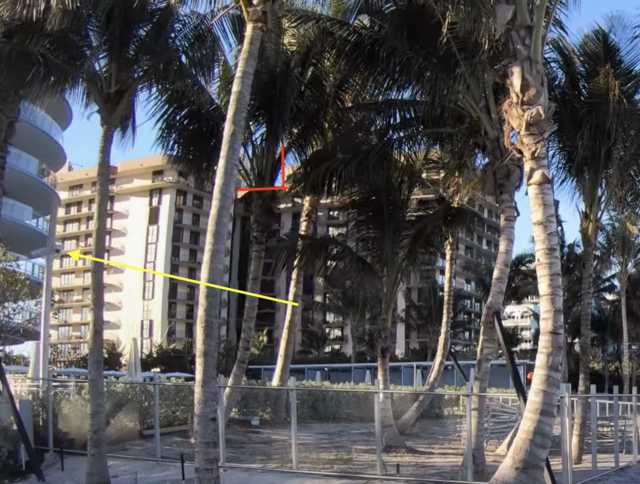

I don’t think the YouTube shows the “before” from the camera’s perspective. Here are some I pulled from a video taken from a walking tour. The red lines are mine, the yellow arrow points to the camera that caught the collapse. The step down in the roof, I think, is far more profound than people imagine:
I believe the CCTV footage starts after the facade has dropped approximately 1 floor. The video from inside 711 suggests to me that the M line of columns (right hand wall in the 711 video, right hand side of x11 balconies in CCTV from South) dropped maybe about quarter to half a floor ahead of the L line.
The KLM section for the x11 stack basically falls together, but M leads a little to give the slant in the 711 video. The stairwell resists at the north of M, N initially resists at the south before failing well behind the KLM collapse and leaving O–P as the sole bay to briefly survive at the south. The I columns in the x10 stack also possibly lagged by about quarter to half a floor.
