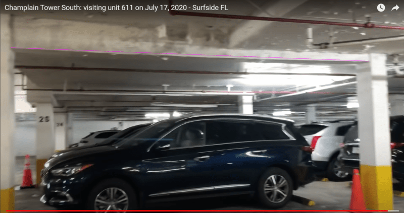

And I still see the beam deflection, sorry. The stains on the left third of the beam do sort of suggest some nominal level of flexural/shear cracking as well. It may be nothing, but it's another data point in the area of concern.
That deflection is towards the center of the photo.
Of two general types, that would be “pin cushion” distortion, rather than “barrel” distortion.
A showing that barrel distortion is inconsistent with the camera would prove the point. And I’m pretty sure a phone camera distorts away from the center, in the barrel shape.
Speaking of that beam, is it just me, or does it look like natural concrete when the rest of the columns/ceiling are painted white. Is it possible that this was an older repair?

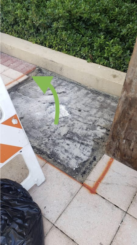

This pic comes from the report Pengawin linked above. It’s the test probe area in front of the 111 planter…
Is it just me or does there appear to be some sagging near the edge? Is that normal?
“NOOK-yoo-ler. It’s pronounced NOOK-yoo-ler.”

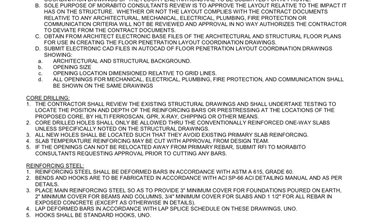

You are correct. I’ve been reading too much way too late at night. I don’t like that they drilled through the bar. From my understanding, the plans show parts of the pool deck that have #4 and parts with #5 at the planters and column areas.
Reading the notes on the repair drawing they have a section that shows they are supposed to take steps to prevent from drilling through bar like that in the “core drilling” notes. I’m not seeing this note in the 2020 document, but since it’s a memo it might not be displaying all the pages.
