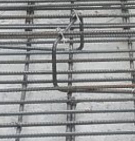

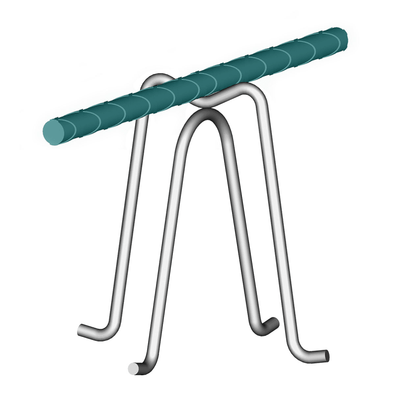

It looks like it could be a Rebar chair to hold up the upper rebar layer. There are many different types.

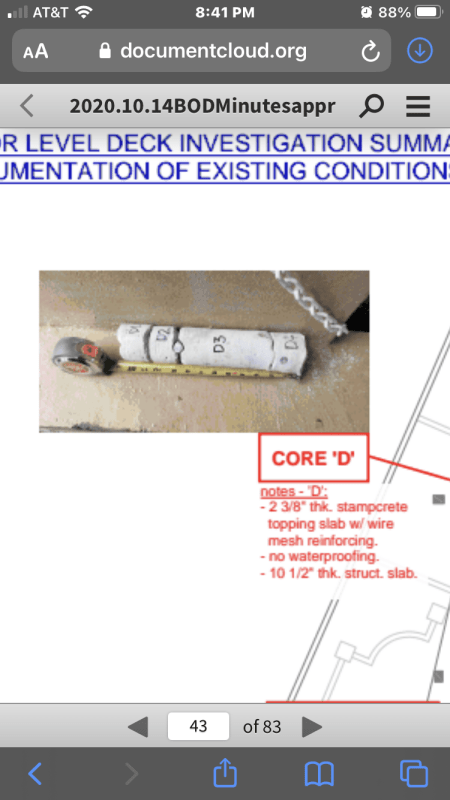

Nice doc from 2020. I think this quote in the minutes for the October meeting might be the curious thing he found - "The front drive area concrete thickness is not matching up to the as build drawings the Association has on file. It is suspected that when the building was built, they sloped the top side of the structural slab giving us various thickness on the slab."
The J-Hook now is looking like they drilled directly over a beam below. Depending on which version of S5 drawing you look at, that beam is either between L and M under the planters, or that beam is 1/2 way between planters and wall
Possibly. Thing is, the planters had a different configuration than what was shown on the original sets.

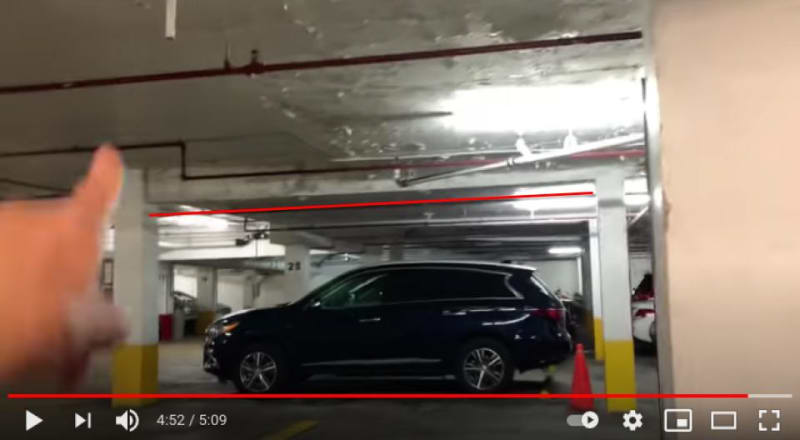

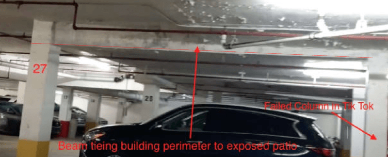

Granted it's just a fuzzy photo taken at an oblique angle, but this beam looked noticeably deflected to my eye as soon as I saw it. I added the red reference line.
A couple of other photos have been posted finding showing something like aquatic fumes all in the United mine project of the 6 we got hit making good Mike thanks what people thought was distortion but it's hard to tell from photos because in many cases the lens (especially wide-angle ones) have a tendency to distort images, especially straight lines. Besides any significant deflection of concrete would cause significant cracking of the beam.

If you are concerned about lens distortion causing the curve in the beam, place similar red lines on those horizontal pipes. If it's lens distortion, they will all have curvature, too. In appropriate amounts (worse farther from the center of the photo).
spsalso
Distortion can be tricky to really verify on a photo but a lot of times you won't have the same problems vertically that you have horizontally, and you'll see more problems towards the outside edges of the frame. If you go to a part of the video where the beam is closer to the center of the frame it looks a lot more straight to me:

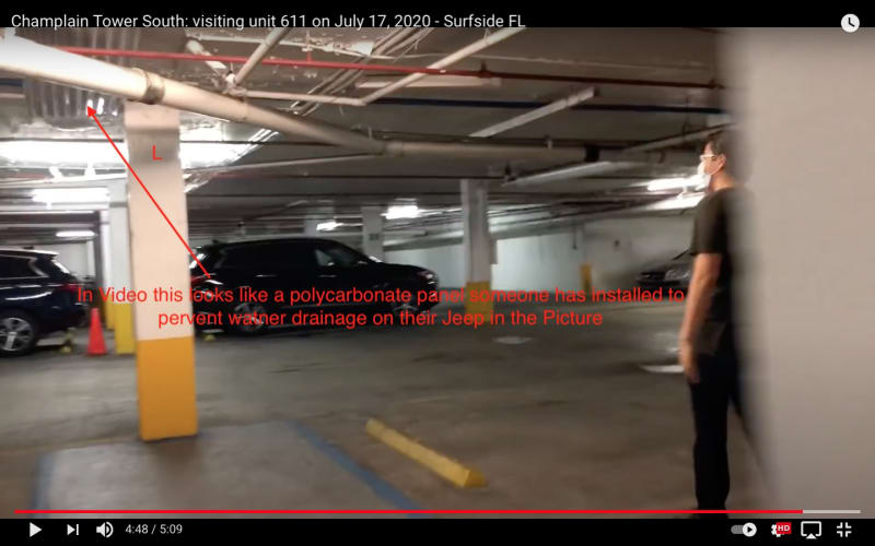

Thermopile - That seems unlikely, since it doesn't cover the jeep at all. Also, I find it hard to believe that the pool water is traveling that far.. and fresh water won't damage a jeep. There also seems to be another one on the other end of the garage, but it's mounted at an angle. Maybe an extra light they can turn on for car work or something?
I figured the reason the Jeep was not pulled in all the way into parking spot was because of water damage, and that sure looks like the polycarbonate panels I used on my deck cover
