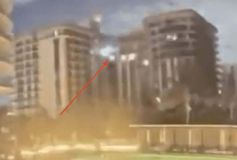

Not sure if anyone noticed this, but slowing down the video, I noticed that a light in an x10 room was actually turned on during the collapse:
I've also noticed that some of the lights appear to go out in synch with the blue flashes going out, but not necessarily the ones directly horizontal to them. Someone mentioned three phases. Are different floors on different phases? Would this mean that appliances like stoves and dryers are 208v, instead of 240v? Would this also mean that every third floor is the same phase, or is that unpredictable?
(EDIT: added arrow)

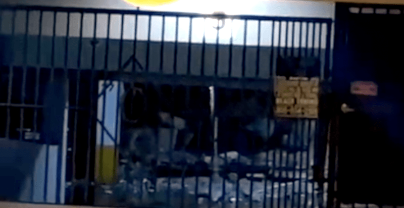

As far as I know, the original video is the tiktok video. It's only 1.59MB on the tiktok site itself though, so it isn't a lot to start with really.. this is a tiny video. Anyways, I went through and stabilized it as best as I could, and cropped it down. This is the full video, but it blurs out whenever she moves the camera too fast and there's not much that can be done to fix that. I didn't do any sharpening, lightening, etc, because that tends to just degrade videos. Here's my stab at it -
Some interesting things I noticed.. there is a flashing light on the left wall, so clearly the fire alarm did go off. It looks like the reflection of a strobe light to me. Also, I think on the bottom part of that broken column it looks yellow and changes color in a few frames.. I'm pretty sure we're seeing the bottom of column 28/M12.1 there and it isn't attached to that horizontal broken slab/column/beam.
This frame is sort of interesting too, I'm pretty sure we're looking into the very back of the garage inbetween those last two pieces of the gate grates on the right. Seems like it's probably either the bottom of a wall or a shadow under a car, but it doesn't seem to have any rubble or be part of the collapse yet.. which matches up well with the lighting too. I applied a filter to this pic so it's a bit easier to see.

bones206, Yea.. that makes sense. I was surprised to hear that too.. but I can't seem to find that in any interviews. Is there a link to the audio/video somewhere? In this one he mentions they heard a loud noise in the garage, but no cars -
MaudSTL, I think this progressed a lot quicker than you think. It sounds like the entire collapse starting with that pile of rubble in the garage took about 3-5 minutes total. It sounds like they were in the elevator at the start of that, so they probably saw nothing. They couldn't have driven past the rubble, as it would have been in their way on the way to the elevators.
Exactly my point. Vazquez didn’t mention any collapsed columns, and he couldn’t have driven to his parking space if the rubble Sarmiento videoed had already blocked the entrance ramp. Based on his description, which I hope someone with good Spanish will translate, the garage collapse on the ramp happened behind Vazquez/Accardi, as they were about to get into the elevator. But when they exited the elevator into the lobby, he talks about seeing smoke, dust, and “sunken cars,” and hearing auto alarms before they ran out of the building. He says it all happened within a few minutes.
Actually.. after looking at this tiktok video a bit more, I don't think that is the strobe of the fire alarm light on that left wall. The lights are only on the outside of the building and stretch all the way to the sidewalk. It looks like a car alarm was going off, and it's their back lights that are blinking. Seems very strange that a car alarm picked this up parked so far away though. Maybe just from the boom of the M11.1 column collapsing? Although even that seems odd through so much concrete..
