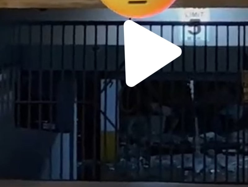

I prefer looking at the un-enhanced photo to compare to the enhanced version. It's also good to go back to the video that is posted in "Miami Beach, Champlain ..., Part 02". You can get a better idea what you are looking at as the camera moves and the light changes slightly on the objects in the garage.
I wish someone could edit this video and just show the garage opening. Remove all the rest and just play the video with all of the motion removed.
Here's my screenshot. Sorry about the TikTok "Play" button. The image is a bit clearer in the attached downloadable file in my next post.
Does anyone know if the cars that were towed away were the ones parked next to the pool, in the area that became the ramp for the equipment? It looks to me like at some point they removed the pool slab in that area, and made it into a ramp. I'm theorizing the cars we saw towed away were those parked directly under it, and in the way of the ramp they needed to build.
