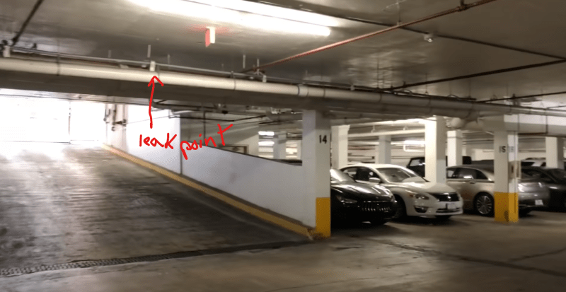

I guess I am totally confused. The video with the water streaming down was taken from the north side of CTS. How did anything from the vicinity of the elevators get into the garage and break a pipe on the north side of the building?

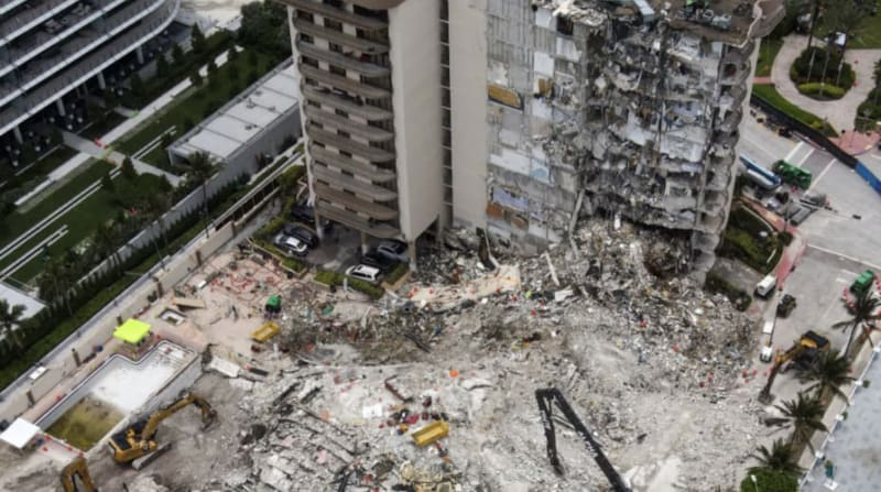

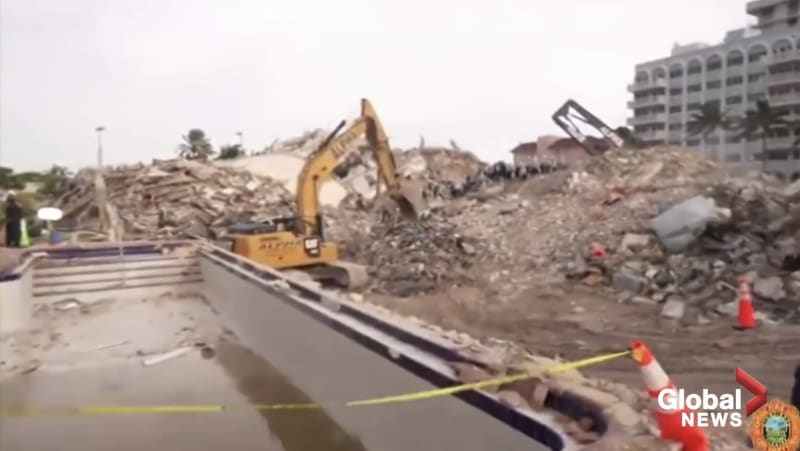

Video still from the Miami-Dade Fire Rescue behind-the-scenes look from yesterday. I wonder what will be left to analyze as it does appear that the area of interest regards the collapse has/is being addressed with heavy machinery and cleared. The picture quality of the video unfortunately was poor and I have been unable to find a better quality image. But this does show continuation of the clearing of the plaza deck area to get down to the garage level, removing the vehicles and all the debris.
Another photo to explain the area near the pool has looked like this for some time…this is an image taken prior to the 4th when the rest of the building was brought down. Again photo quality not the greatest.

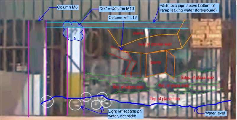

It's taken from the north side, but you're seeing all the way through to the south side. On the left of the ramp, the full height wall is the stairwell, and the far side is aligned with the central corridor. The column at the end of the half wall is M8, in the middle of the south side apartments. The column beyond that is M9.1, and the southern wall of the building. The pipe break is roughly in line with the southern wall, below the x11 apartment stack balconies.
bones206, they look more like rocks in the video itself than they do in the photo btw. Also, the columns were an equal distance apart.. including that one on the ramp itself.
Just watched the video, and agree with you those white spots are stationary objects. But I still see the water level the same as in the photo.
Sym P. Le did a nice job earlier showing the perspective of where we would expect to see column M11.1. It's pretty much exactly where I see it broken into multiple pieces. It's not the exact angle or perspective, so it's slightly off, but it leaves little doubt in my mind that we are seeing the remains of column M11.1.
Also note you can see the white license plate of the same car in both photos.

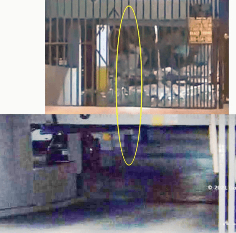

bones206, that picture isn't of the CTS garage btw.. and it's also not lined up properly. Note the center of the second column (27) in both photos.. it's not centered, which pushes the rest of the columns further right.
It seems plausible that the missing column could be hiding under the large planter area though.. although it makes no sense that it was pulled in that direction when we know nothing collapsed over there. But I'm definitely not a structural engineer.
NOLAscience, can we avoid the witch hunts in this forum? Leave that part to the cops. It's one thing to suggest that a car crashed into it, but it's another thing to start throwing names around. We know almost nothing about these people.
I believe that photo is from the CTS garage. See Sym P. Le's post on 10 Jul 21 22:58. If you account for the difference in angle, the columns would look to be spaced closer together in the viewpoint of the tik tok video as compared to the google earth photo.
