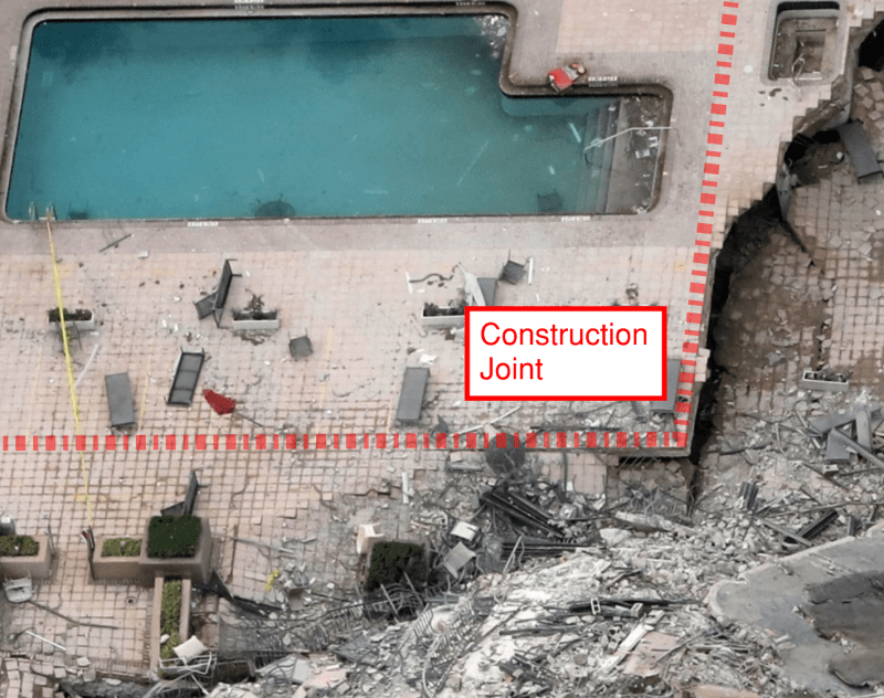

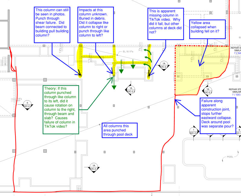

I sketched down some of my thoughts on the pool deck collapse, trying to tie together what is known. More questions than answers. Seems that there are at least one too many variables right now, which cannot be answered without further video, eyewitness testimony, or forensic evidence. There should be more information once they get to the bottom of the debris pile. One thing is certain when they remove the debris, they should be able to quickly rule out/in a sinkhole below the actual building foundations. Either the pile caps below the garage slab are still there or they aren't.

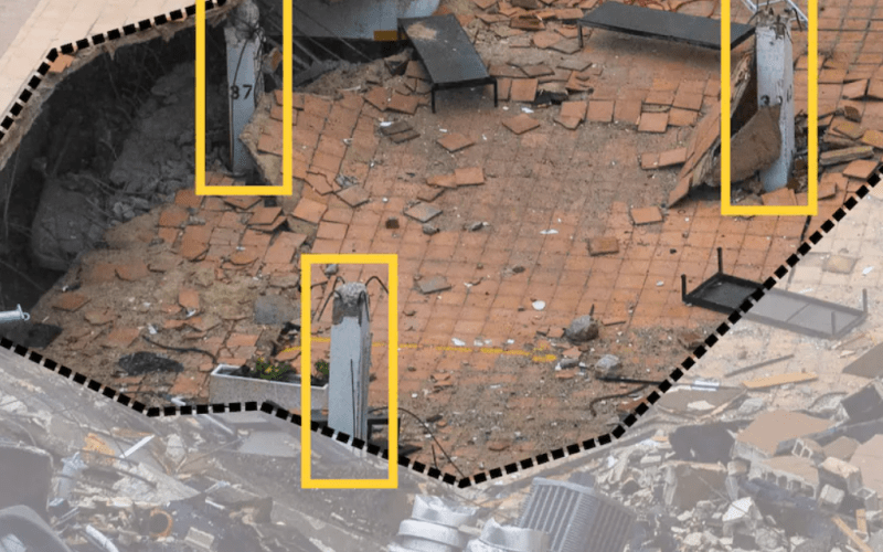

I wouldn’t expect to see columns laying intact or even in pieces on the ground. They have rebar at both ends. That isn’t really a likely failure mode for RC columns. If this was a stone church, then yes.
The missing column is curious, but there are many possible explanations for it. First, it could be hidden by all sorts of non-reflective debris, like topsoil or plants. Second, it could be hidden by a hinged piece of slab. The picture is simply too grainy.

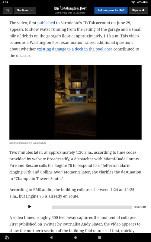

Hello all, I've seen it mentioned over and over that no alarms were sounded until the building was in active collapse. However, it was reported very early on that there was in fact an alarm that sounded prior to the collapse, and this is why emergency crews were already en route when the final collapse occurred. Whether this was an automated alert or someone pulled an alarm box, I don't know (anyone familiar with Jefferson alarm services?)
I know I saw this reported on multiple platforms in the first couple of days afterwards, but it wasn't repeated much as more information came out, I had to go looking go find it.

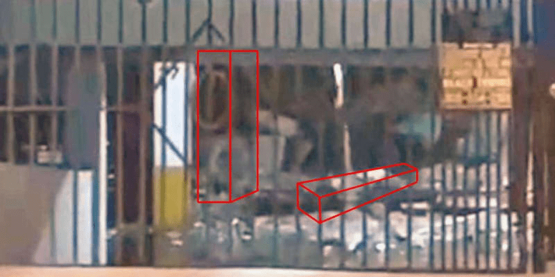

Has it been 100% confirmed the column is missing in the tiktok video? Just because we don't see it, doesn't mean it's not hidden behind a fallen, hinged section of the upper deck, prior to the failure of the structure.

My point is that 1) the 1979 FA riser doesn't show a waterflow alarm of any kind in the garage, 2) there is evidence of significant damage in the garage before the collapse, and 3) there are no reports of a fire alarm going off until during/after the collapse. That's not ironclad, but taken together, those facts are one more piece of evidence lending credence to the initiating event happening in the garage/pool deck area, not anywhere else.
Js5180, there just isn't enough debris to completely hide the column. Do you have any ideas on what else that white object could be? I find it curious that some people think they can see rolls of roofing paper in this photo, but not a column. I just don't see how anything falling from the roof could detach a column from it's rebar at the base, and throw it too far away from that spot to be identifiable. Also, I think it's really obvious which column descended first from the ring video.
arbitraria, I heard they were already in the area, and Gabe Nir was the one that called 911 at 1:19 to alert them. The only reports of the fire drill going off seem to be after the collapse. Maybe the security guard pulled it, but it didn't sound across the entire building because of a short in the basement or something?
Demented, If you watch the 2020 tour video.. that's exactly where it was. They were all an equal distance apart and are the same size there. It's definitely missing. We also can't entirely see column 28 even though we know it stayed standing, which hints that the object above it is the pool deck and it hasn't completely collapsed down to the floor there.

As for how a roof collapse would take place, I believe that at some time before the first frame, the penthouse roof collapsed, hinging at the column M line. This could have happened as late as the second before the video starts, but it’s very difficult to prove that it didn’t happen at some point in time. The penthouse roof slab has clearly separated at the M line. Did it shear off and drop straight down? Did it hinge?
Had that event happened independently of the main collapse, the parapet wall was definitely a weak link and it would provide enough energy to damage the pool deck in the manner we see and then weaken the beam between 10 and 11.1. In fact, if there had simply been a strong enough vibration nearby, I’d expect the parapet to be the first major piece to fall, owing to its position way out on the cantilever.
I am not backing or discounting any theory. But, if a car /truck hit the column with enough force to completely detach it from the floor, wouldn't it have followed the column? In other words, why isn't there what is left of the vehicle resting against the thrown column? I keep getting drawn back to the unknown cylindrical object where the column should be. But my mind can't make it look like a car part. I must be missing something.

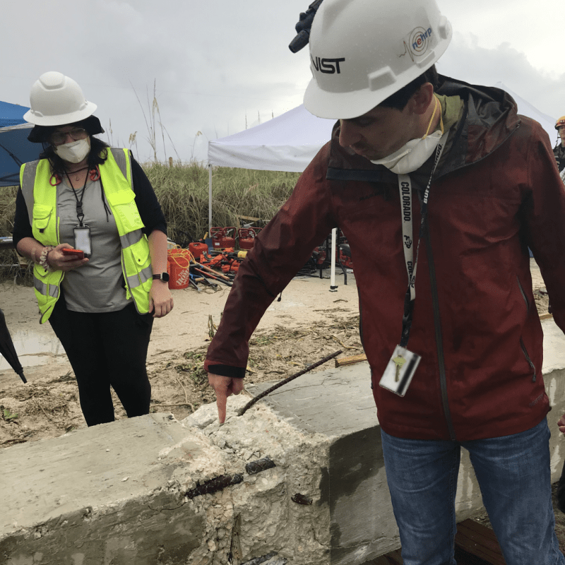

JR97.
What I found interesting in the above photo:
Yes, the two heavy rebars meet at the joint. Perhaps it is acceptable practice to do this for one of four bars passing through vertically? Concrete guys, of which I am not, would know.
But also:
It was posted on June 30. That means that some or all of the parts of the building were being relatively carefully kept off site, for evaluation. As you would expect, but ya never know....
Also, of course was the amount of rebar going horizontally (formerly) through the joint. I can see only one piece coming out of the (now) top, with no places evident where it had been snapped off cleanly. This then looks like one piece of bar where there should have been six. The facing side seems to be similar. Again, perhaps the location of this particular joint only demanded a small amount of rebar. Concrete guys?
So far, this is the ONLY photograph that I've seen with good definition and up close to the subject.

Thermopile, 28 is the one that puncture sheered and was still standing. The missing column is the one between 27 and 28.
I do understand that is where it should be. My point is it's too grainy of a video and there's no actual distinguishable items other than possibly a planter, and rubble that appears to be pavers or CMU. It is possible it his hidden on the other side of the decking that collapsed. There is very obviously debris behind the column location, closest to the garage ramp. If the decking collapsed and hinged behind that column, especially with little light and shaky grainy video, we very much likely wouldn't be seeing it at all.
If this 5 seconds of zoom in is the only proof currently of that column being missing, I think we need to all take the missing column theory with a grain of salt.
Sorry quoted wrong column number, but I still see top of column siting on rebar cage from where beam interfaced into it
update: Definitely gate bars are giving me an illusion of the vertical column corners, so not sure anymore what I see
