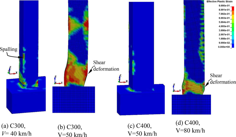

I know of one person who's backed a car into a column at 20km/h, it was a massive bump even at that low speed. I think people think these columns are super strong. They hold a pool deck up, how strong do they have to be? They might be very strong, but the connections to them aren't going to be that strong at all. Shear at the bottom is what I am thinking. Research itself points to this, with clear lab testing.

To all of those saying a car hit the column, are you saying it came down the entrance ramp? Did it come from the west underground side of the building?
In which position could the car have come from, with enough speed to obliterate that column and leave it laying towards the west in any way in the way everyone is claiming to see the column?

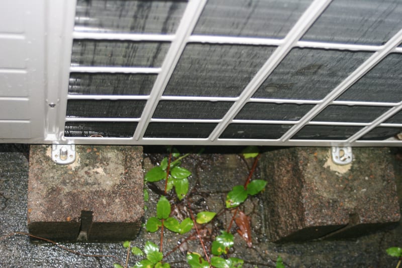

waross posted a picture of a Rheem tie down strap for a split system AC unit. Looks almost home made. Here are pictures of hold downs on AC units installed at my house:
1. Picture of one of four bolts holding down a 3.5 ton Carrier (Factory provided holes but the top grill has to be removed to install). Replaced the Carrier w Mitsubishi.
2. Mitsubish Mr Slim heat pump with factory tabs (two on each side) to hold down AC unit. Prior to installing nuts on threaded rod embedded in concrete blocks that elevate the unit above the original slab. Blocks also anchored by rod into original slab.
I have a 2 ton and a 3 ton a/c on the concrete roof of my single family home in a hurricane zone. I have no doubt they would've blown over on the first windy day without being bolted down, but chances are the tubing and wiring would have kept them from going far. Plus they weigh maybe 100-150 lbs. Does anybody really think something of that weight could cause a collapse? Would a human body falling from the roof cause a collapse?

I just posted due to one poster saying AC units are top heavy (they're not and fan motor typ. only weighing 20 lbs with heavier compressor at bottom of unit)) and other posters saying AC units aren't bolted down. Absolutely should be in huricane areas and AC manufacturers have provided mounting holes forever. All units I've been involved with have been bolted down and I'm inland. Commercial building codes require it and I'm sure residential codes in many areas. Just good practice at least to deter copper thieves.

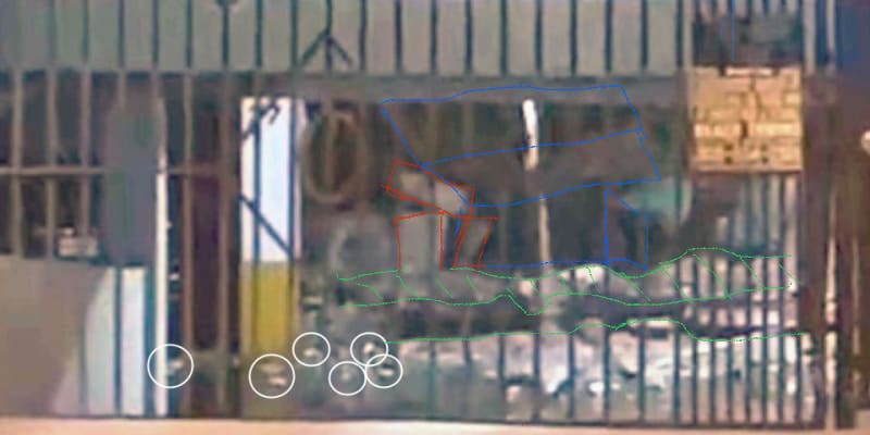

Since we are all taking turns squinting at the time tok video stills, here’s what I see: planters tilted on their side, with foliage facing the camera (outlined in blue). Planters resting on the plaza slab which has cracked in half. The exposed cracked edge of the slab is facing the camera (outlined in green and hatched) and the darker area below is the bottom of the slab. We see the top of the plaza slab in the foreground (broken edge outlined in green). Red outlines may be remnants of column M11.1 and possibly part of the beam, but I’m less sure about that.
That's pretty much what I see as well.
