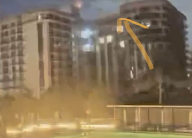

There is evidence that the pool deck collapsed, but there is no evidence as to its cause. It’s also several minutes prior to the main collapse.
There is also evidence, in the very first frames, that the roof parapet has fallen much further than its adjacent slab to the east. That same visual evidence shows that it sheared free of the M column row, while the next portion of the slab to the east stayed up, supported apparently by the M columns.
I don’t think any of the above is disputed, but if it is, please correct me. The above doesn’t mean the roof fell on the pool deck, necessarily, but I’m trying to line up the undisputed facts first.
I am not invested in a particular theory, but what’s problematic to me is that the lights in some units below are still on, despite the suggestion that the x11 units had already fallen 2-3 stories.
What’s also problematic is that Josh/Building Integrity attempted to disprove an early roof event by claiming that the electrical runs are vertical from the basement. That is clearly wrong. The rest of his theory could turn out to be correct, but right now, it’s going to need some maintenance (which I presume he will do as he’s done before with changing facts).
So that leaves us with an unexplained absence of a very specific roof slab and parapet in the early video frames, along with an unexplained pool deck collapse. How did roof slab K/L/M shear so completely from roof slab M/N/O/P at the M column lines, if M10 had sunk several stories?
Yellow arrow points at M boundary between those slab areas:

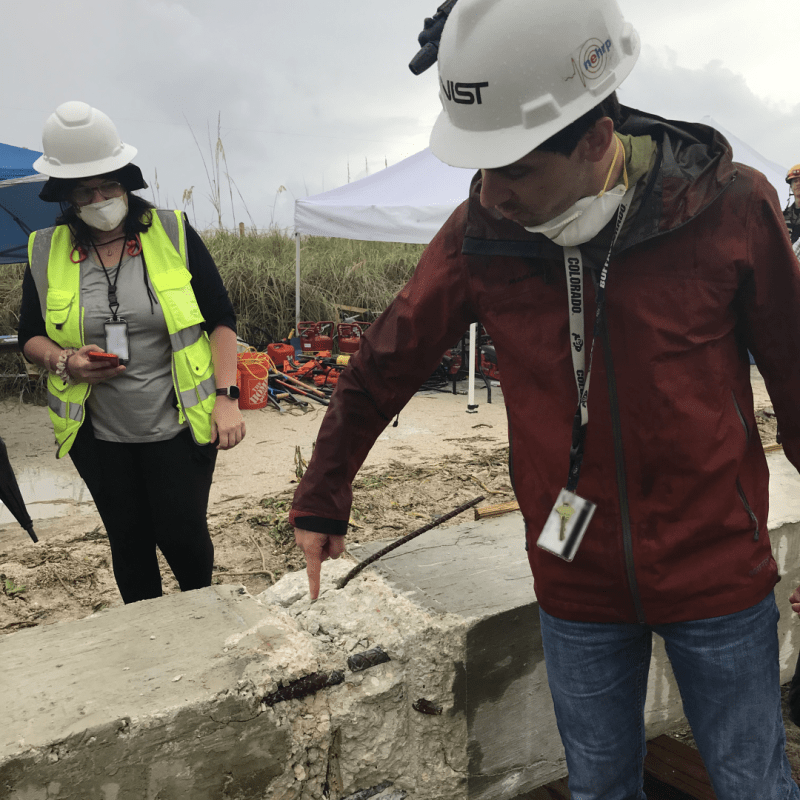

It is known that the concrete and the rebar in the columns was severely degraded.
The objections to the vehicle strike theory may be based on a column of normal strength.
These were not normal strength columns.

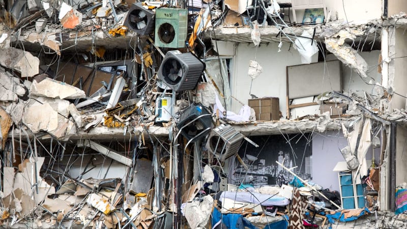

Js5180, I see parapet and perhaps penthouse cantilever missing, and perhaps the lower paraphet, and cantilevers in the middle area. I have studied similar picture angles of building before collapse, and I see the middle cantilevers and parapets in plane with the East ones.
Regarding the HVAC units falling theory, the great number of units dangling off the still-standing wing, by what appears to be their electrical or refrigerant lines, indicates that they wouldn't readily roll off the roof. Even the sudden jolt these experienced as they were tugged between their roof attachments and their elec/freon lines wasn't enough to bring them down. Perhaps something else rolled off, but the HVAC units seem unlikely.
