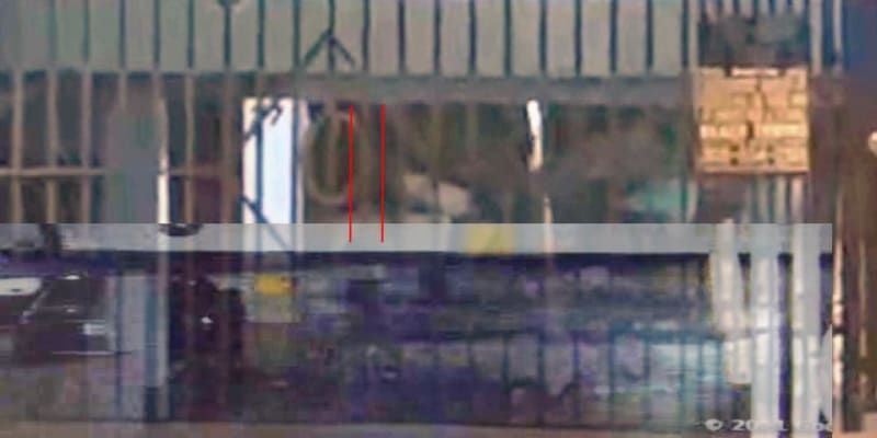

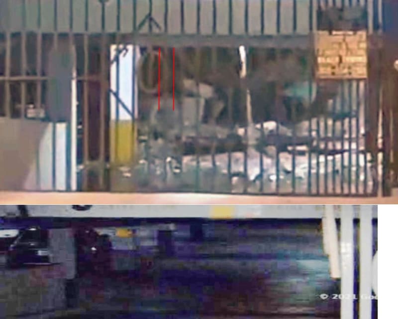

Ah yea, he says that's from the north garage there. The garage layout is a bit different there too btw. Personally I wouldn't bother comparing these two images as they're from such different angles.. drawing it out is more likely to be correct. But this is more how the photos look when you center the columns and flatten it a bit so they follow a similar angle to the tiktok video:
They overlay perfectly then too, and it's pretty obvious about where the column was, and 28:
But yea.. it's sloppy and I don't really like that way of drawing it out myself. The way this is flattening the image makes the CTN garage columns much skinnier in this pic than they actually were too, so it only marks the center of the column.
Crazy enough too, I compared it to my earlier drawing and it's perfectly centered.. I wasn't actually expecting that because this style of drawing is so sloppy.

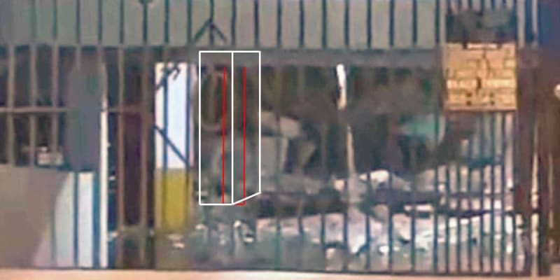

jbourne8 - I didn't catch that it was the garage of the other building. That does makes a difference...
I kind of buy what you're showing for the alignment. Just for argument's sake, what if column M11.1 broke and toppled to the right? Couldn't that conceivably match what I outlined as the broken sections of M11.1?
Ok, it didn't take out a column (though in the condition these columns were in, who knows), but perhaps it jarred the column and the (1) insufficient rebar that has been deteriorated over time, (2) lack of drop panel and additional rebar connecting column to deck, (3) overloaded deck (from heavy vehicles and water from recent rains in 3" of pool deck over waterproofing collapsed a slab, or at least created a crack. He says to himself, "I am not sleeping in this building tonight."

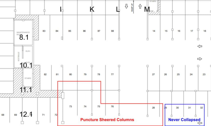

I was having a hard time following the letter/numbering for the columns really, since I don't normally work with building plans. I think a few other people might be having the same problem too, and I do make a lot of quick and dirty diagrams for work.. so I drew this one up so I could follow along with that part:
And hm.. it seems too far back in the room to be M11.1/the missing column? I can't quite make sense of it laying across the top of the planter from the other side if it is M11.1. Seems like it'd make more sense that it's under the planter/slab and out of sight.. or it's that white object laying on the ground to the right. I'm sort of convinced that those two pieces of broken column or slab aren't actually the same column and they just look like they are from this angle.

If it toppled to the right, wouldn't the column be under the pool deck, and not visible as debris in the stills or video?

Jbourne8,
See the column inbetween parking spots 27 and 28?
This column is M11.1 its the first column not under the building structure. Which is why its got the .1 at the end. Can you see how its rectangular in dimensions? Its 12 inchs by 16 inches.
It has a tri shaped piling under it into the ground. At the top a beam connects it with M10 along the roof. Which is under the planter boxes.
So on vehicle collisions, its normally the bottom which shears out due to the vehicle being low to ground. So perhaps the beam further pushes the shear at the bottom by holding extra strong at the top?
Also someone should be able to answer whether there is a cold joint between piling and column. This and rusted rebar at the bottom make the bottom shear a high probability.

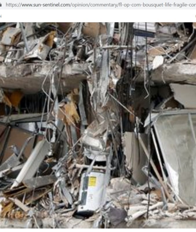

This place was built in 1981. Tankless water heaters were as uncommon as mobile phones in those days. And I found a water heater in an image of the remaining structure. See:

NolaScience posted "This place was built in 1981. Tankless water heaters were as uncommon as mobile phones in those days. And I found a water heater in an image of the remaining structure"
Can't argue with picture of tank in debris. Only thing is that water heaters only last 10 years or so so that water heaters in each condo have probably been replaced at least 3 or 4 times. Some condos could have tankless units when replaced if electric service is a least 200A.
My house was built in the 60's, had at least three 40gal electric water heaters, then a heat pump wtr heater w 80 gallon tank, then five years ago a 21 kW tankless. The heat pump water heater worked best. Tankless not enough capacity even at 100A, 21kW.

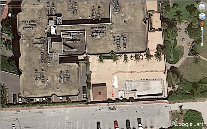

Looks like some pool deck remodeling done around 2013? PVC pipes topside? Maybe the drains were being fixed? Planters still has palm trees here. Palm trees were changed sometime in Q4 of 2017. (Image grabbed using Google earth Date and Time filter)
