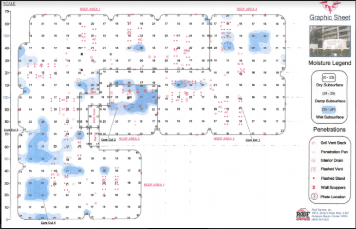

-There was also significant water damage on the roof, right above the failed column in the garage, and Sabino clearly heard water around the elevator to the extent of where she knew it was substantial enough to report, and from there not being corrected or alerted for it doesn’t seem like it was a “normal” event to be occurring at the time.
Roof results of significant water damage documented:

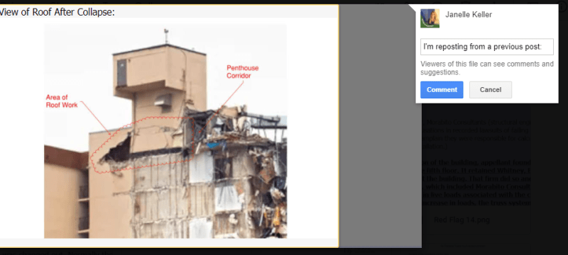

2) Crashing was reported initially as being from above - if individuals attested for crashing coming from above, wall cracking coming from above, it was probably coming from above. Now talk about simple conclusions. (Quote: In a video interview her 15-year-old daughter Chani said, “I went to take a shower and I came out of the shower dried myself and I was about to get dressed and hear like a big boom and I was like oh no something’s not right and I just ran out of the bathroom and I checked and I thought the whole ceiling was like collapsing.” )

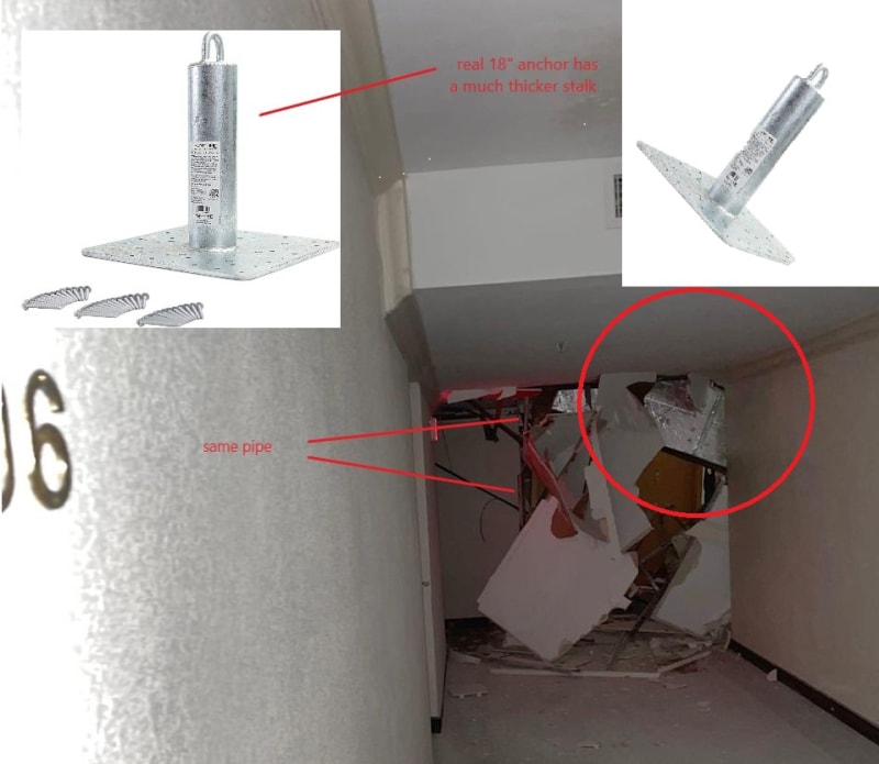

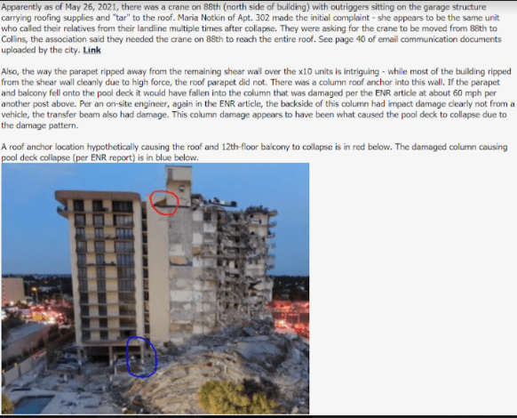

The wall appears to have been torn at an angle of destruction, given the triangle hole, and restating from a post a few weeks back, a cantilever and/or balcony area could have actually torn away from that spot, given a roof anchor was just test loaded :
Ironically, a roof anchor crashed into the still-standing adjacent 8th-floor hallway wall which indicates that the "roofing event" dislodged from above could have stayed almost flush to collapsing straight down into that nook along the wall - hitting the compromised pool deck - but again, the initial boom event was probably not watched due to the time of day. And unfortunately, those who may have seen the roof event and have the answers were not able to make it out in time.

Can someone please explain how those roof anchors were intended to be used? You could not work on the exterior with a safety line or worse an abseiling line tied off at the roof and going over a rough parapet of unknown competence and at those angles. It seems unthinkable.
The anchors are for fall arrest and have to be strong enough to resist a load of 5000 lbs (22 kN).
AusG
Based on 30 years in Metal Building Structures, where we install those type of personnel tie-off anchors, they are used to work near the edge of the roof, say approximately 10' wide zone all around the roof. Not for suspension work over the edge of roof. One Anchor One person, maybe two persons tied off. Simply fall protection tie-off.
Jim
Sure, I get how the bolts work. it's what happens to the line you tie to it I don't get. The lack of a clear path for the rope or cable or whatever.
Edited: ah OK, Jimstructures, thanks that's clear. They had previously been discussed in terms of high access work over the side, cages and the like.

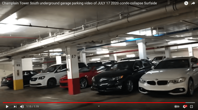

"It appears this would have been by the lobby entrance area, on top of the deck? 2 ton tar tank (~800-900psf if left full for next morning as is typical of the area). This wouldn't have been parked under ground in the garage would it have been?"
The position of that Camry appears to be out of place. Possibly due to the rush to remove debris from the collapse site? In the parking garage video from last year, it was parked here:
