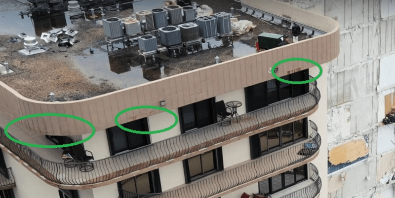

I just want to make it very clear, I don't believe in roof first.
It appears the image Optical98 posted of the roof actually doesn't show the roof sweeper. I thought it did, but while looking for that trailer I spotted this in an image I circled of the roof leak and drains that don't do shit but flow once the roof is fully flooded.
Same colors, different machine. Typical of industrial tools.
Optical98, thank you for this picture!

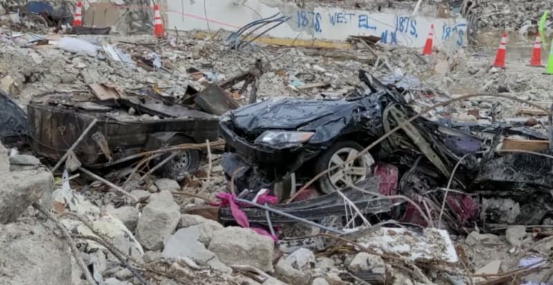

It appears this would have been by the lobby entrance area, on top of the deck? 2 ton tar tank (~800-900psf if left full for next morning as is typical of the area). This wouldn't have been parked under ground in the garage would it have been?
It's right around the intended maintenance parking:

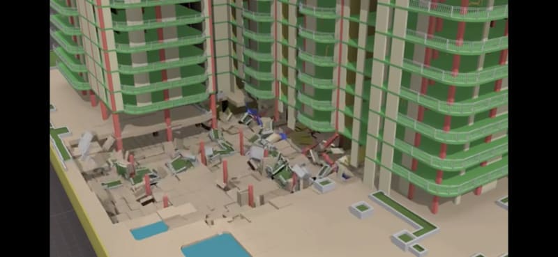

I initially thought collapse along L, then along M, and have come back to L line. Two main reasons. L is more central to the collapse in the video so makes sense the collapse originated in the center. Two, the observable deformation of the room in the ring video is much closer to the L line then the M line. I don't see how the L corner of the room is deforming if failure is occurring along M. It's true though, the progression of the collapse is a discussion of "how", and the real mystery is the initiating event which I still think is rooted in the deck with some combination of bad design, bad construction, and neglected maintenance over 40 years.
The simulation seems to show the first elements collapsing are the ground level wall panels. I suppose that would sound like a wall collapsing. I wonder what their basis is for initiating those wall panel failures.
Also the view of the rubble heap from within the garage matches closely what I saw in my squinting analysis of the tick tok video, showing the edge of the slab, planters and the broken M11.1 column and beam.
Edit: looking at a different angle in the video, it seems they have M11.1 remaining standing (under the planter) while M10 collapses early on. This doesn’t match what I believe the tik tok video shows. I’m not sure they accurately accounted for the beam connecting those two columns.
