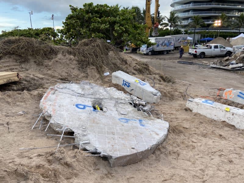

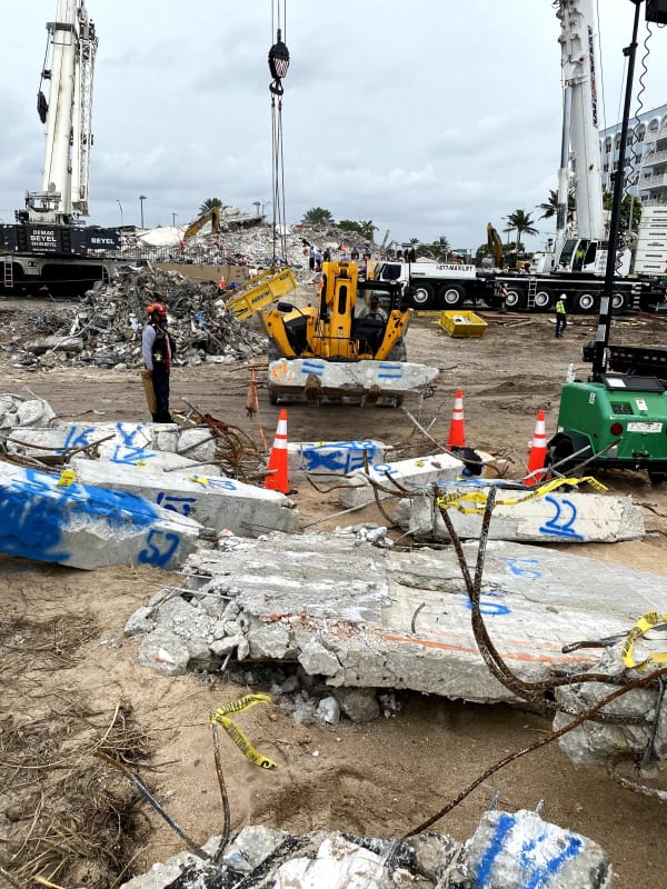

I was going over some of the NIST photos and found a few things of interest:
It looks to me like this was a pool slab with original tile on the right and a planter on the left. Look at the concrete deterioration under where the planter would have been.
This one shows another piece of slab. I am assuming that the rebar loops are beam stirrups and that this slab may have been at a slab step. What bothers me is how clean the 'fracture' is. This looks more like a crack that propagated over time than something that happened suddenly. If they are beam stirrups, the beam must have just turned to rubble.
Possible punch shear and more bad concrete under a planter?
I don't like the dark gray surface where the floor connection would have been. Again, this looks like something that was like this for awhile, not a sudden fracture.
Any thoughts?

I don't think any slab with remnants of tile and grout lines like that would be from the pool deck. The pool deck slab had a waterproofing layer, a layer of sand, then pavers (and maybe other layers), but not tile that was attached directly to the slab.
In fact, the second-to-last photo looks like a balcony slab to me. The corner seems to be curved just like the balconies, and again, the evidence of tile on the slab would be more consistent with a balcony (or perhaps an interior floor). But the curve to me is a big indicator that this was a balcony slab.

Possible punch shear and more bad concrete under a planter? Any thoughts?
Link
This is the same chunk featured in the first photo from this post. It's number 9 with a number 12 near it. If it's from a balcony I would guess the hole was cut in it to facilitate lifting.

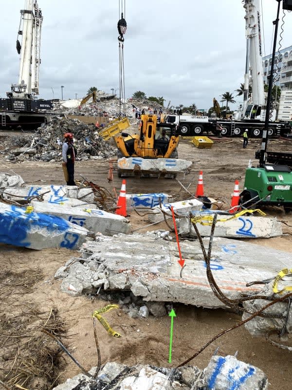

Edit the more I look at the image below, the more it looks like the rough raised area is part of the slab step down, and this is where the first patio was outside 111. It may have had tile in that area next to wall, as that was unit 111’s private patio area.
Or more likely from 211 floor and cantilever above? I think it has been posted there were beams between floor 1 and 2?
Edit 2: The crack Sara Nir saw could have been the outside wall peeling away from inside walls as column buckled between Unit 111 and 211.
I keep saying to myself, I will not do another post, but then Tropment makes an excellent post, and then the photo below is posted.
Here is what I see in the photo with my 'Vintage Peepers'
I believe this is a cantilever slab coupled with some of the slab from inside a condo unit. The red arrow points to a rebar like you would have if this happen to be a cantilever with a poorly tied parapet wall sitting on it. Or perhaps this slab had a masonry wall sitting ontop of it where the rebar is?
The green arrow points to where the slab cracked between possibly a condo wall/column line and the outside cantilever deck. It looks like thickset maybe was floated on the inside portion of the slab fragment.
I too think the grout lines indicate cantilever that had tiles mortared/adhesive bonded directly to top of slab with no water proofing layer in between.
I also think thickness based upon the other pictures is around the 6-8" mark vs the 9.5" patio slab.
I also see the bottom rebar appear to end at this fracture point, and not be continuous thru this possible joint or to termination say into an unreinforced CMU wall?
Edit: If you zoom in close, it appears there is one top rebar showing above the bottom rebar, so perhaps a column line at the crack and the rebar is a column tie on top of slab?
Edit 2: The holes at the curved portion in the other picture look like where handrails were inserted into slab...

If I am not mistaken, that balcony slab belongs to unit 511.
