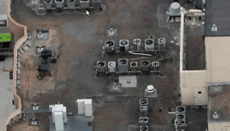

So where's waldo, ups, I mean the tar kettle? Forgive me for being old with bad eyes, but I've been scanning and scanning the high res you provided, and not coming up with anything?

The reference from Nukeman (aka Roofing Contractor's Ins agent)was that the roofing items may have been on the "still standing" roof prior to demo. My thought was that there are ample photos of said roof, so I added the pic. But it doesn't transfer over to this site well enough to zoom in as clearly as I can see it on my compy.
My point was that the items are not seen on the roof prior, however there were some smaller kettles up there. I am curious as to where the larger kettle was found, I don't think it was on the roof btw.
Below zoomed in on small kettles -

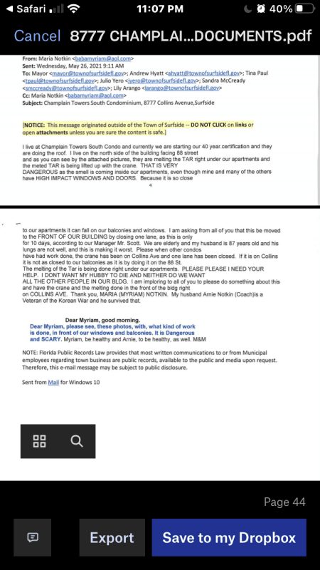

But I'm not speculating about the complaint from unit 302 Nukeman, it's contained in the documents. I will find it and add it to give you more CONTEXT.

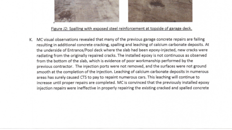

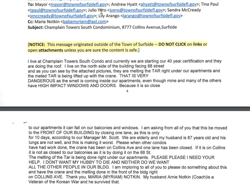

Miriam Notkin and her husband from Unit 302, filed a complaint to the Town of Surfside regarding the horrible odors from the roofing operation, she wrote about the crane and kettle being very close to the building.
Link
In chrome translate to english..
Nicolás Vazquez "The smoke, dust, and " unbearable weird smell " also prevented them from breathing normally."

Reading through everything I’m leaning towards the pool deck being the start of the failure. The 2018 report notes that there were repairs on the slab and that the cracks were continuing on from the repairs. To me this signals that the slab may overloading and previous repairs did not address the root of the problem. It also notes that the areas under the planters as being noticeably worse then the other areas.

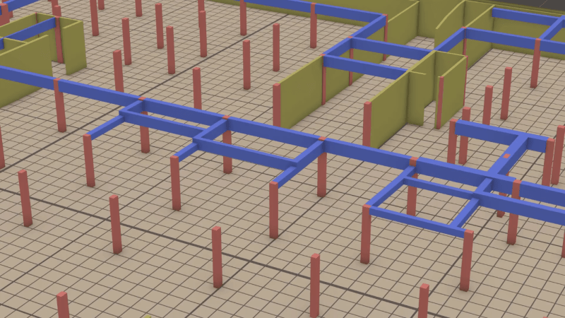

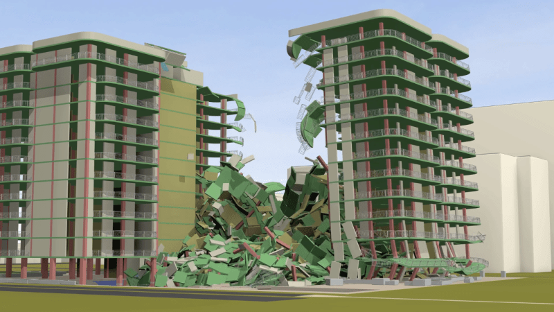

A simulation of the collapse has been
posted to youtube. Description text reproduced here for discussion:
Published on Jul 17, 2021
On the 24th of June 2021 at night, the Champlain Towers South, a 12-story beachfront condominium in the Miami suburb of Surfside, Florida collapsed partially. This collapse simulation was made based on the presently available data, eyewitness, and video accounts.
The authors are independent researchers and impartial hoping to constructively contribute to the fact-finding. This study demonstrates the collapse mechanism assuming the following plausible hypothesis:
According to the data, the basement deck showed signs of extended soaking for many years. The problem was locally insufficiently patched and not rectified in its entirety. The wetting caused the deck ceiling to be weakened to such an extent that basement pillars punched through the deck where additional load had peaked at the planter area.
The authors hope to not distress relatives of victims with the application of dummy dolls in this simulation that have the sole purpose of tracking victims in potential cavities within the debris.
The Bullet-Constraints-Builder simulation software is open-source, it was developed within the EU FP7 funded INACHUS framework.
Kostack Studio was supported by Architect Oliver Walter with the data analysis.

Some frames of interest from the simulation:

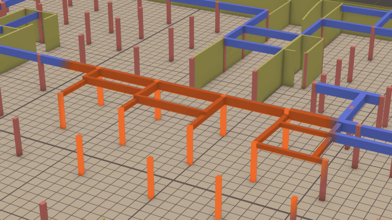

The presumed origin of the collapse, with pool deck and building shown:
Same view with deck and building hidden, revealing structural members:
Bright red presumably highlights the elements that will fail (have not listened to the audio):

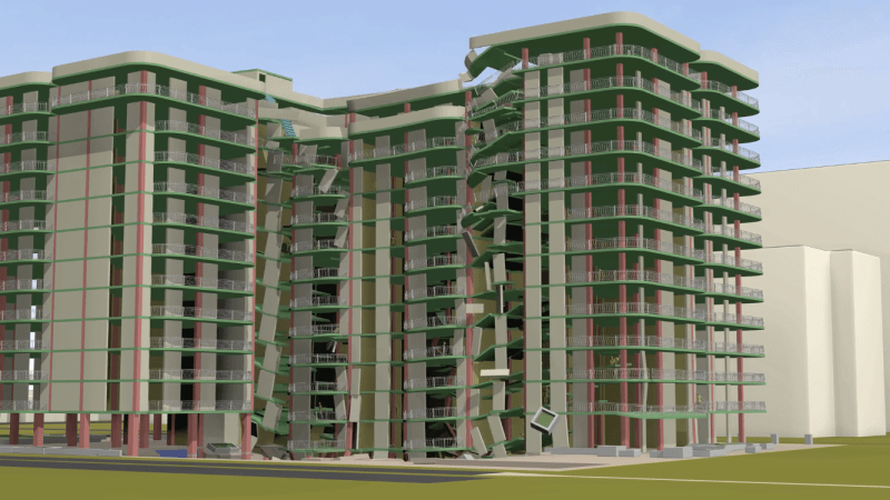

Center section has collapsed, still-standing eastern section begins to tilt westward:

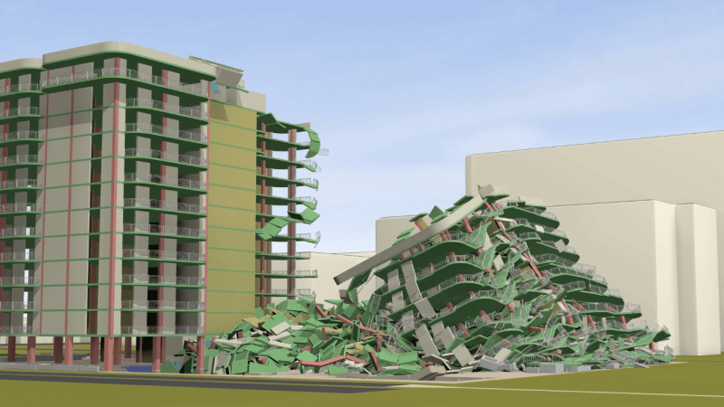

Collapse of eastern section well underway:

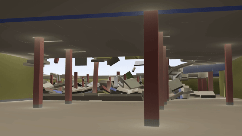

This camera is the closest one to the Tiktok video that I could find. Someone else may be able to identify the columns. I believe the vertical yellow surface at left is the eastern stairwell shear wall; we are looking south-southeast as though parked in the northernmost row of the garage. The ramp should be obscuring our view to the left. I may be misinterpreting the view.

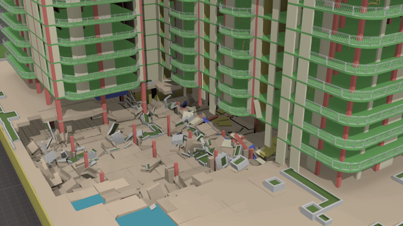

The pool deck has punched through and almost come to rest.

I am not sure I see the “step” in the slab that is shown on the drawings. Is this area modeled correctly?
The collapse progresses without delay in the simulation. I would love to know how much they had to fiddle to get it to look this close to the actual collapse, or if it readily produced this outcome given the model that was provided.
That is a well presented simulation. The view from the adjacent balcony gives it relativity to me.

The slab steps are in the model but they appear as beams when the slab is omitted to show the framing. Only the vertical portion of the step is shown. (In the shots that reveal the framing.)
I did notice the beam38's are missing from the east stairwell.

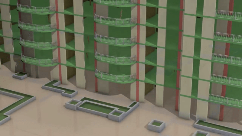

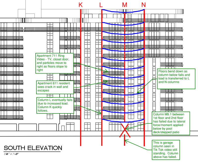

It's very interesting that they show some initial failure on the north side. Starting at about 4th floor down to lobby level. Makes me wonder what information that is based on.
I wouldn't discount the possibility that limited analysis of root cause was done in producing this model. Working out which column likely failed first isn't the hard part. Working out WHY they failed is. And although it is a very impressive model this is a model of HOW not WHY.

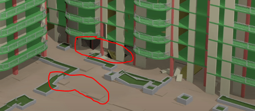

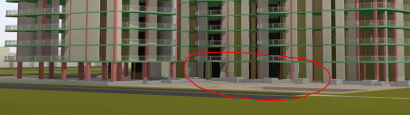

Interesting that their very first visible movement is a rotation inwards and falling away of some facade panels on the ground floor. I guess the unvisualised beam failures below them freed them up to fall.
The deck slab fails inside the footprint of the building next, the pool deck columns are just starting to punch at that stage. I think they have moved the locus of first failure a half-span north from most analyses here.

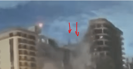

Nice picture, but the building clearly fell in three (3) parts, that shows two. There is probably little to no real physical accuracy there.
