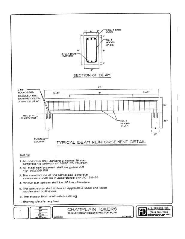

Have you any idea where the callout for the concrete beam is? Best I can gather is it's a BM1, BM34, BM36, or BM38.

#Demented, My memory ain't what it used to be.. I just found info I now remember seeing say a week ago?
Here is the replacement concrete beam drawing.
Question for my feeble mind is how do you support the 2003 temporary steel beam that was left in 2003, with COLUMNS, while you lift it slightly to remove old concrete beam, and build formwork to pour new beam, and hopefully reinforce it?
I can see crane lifting say steel beam perhaps, and another crane say lifting old concrete beam off roof, but that temporary steel structure has to be supported while you are forming, reinforcing and pouring new beam that rests on top of columns. And surely they wait at least 7 days if not 28 days before loading new concrete beam???
Edit so new concrete beam weights 5300 lbs or so? Which is way heavier than the 1/2 load it is supporting? Does this make any sense? Why not use Steel and just paint it often? A lot faster in and out, and less expensive too... And neither steel or concrete seem to fair well on reclaimed Ocean?

As for the concrete beam, it was removed in pieces by hand and bucket. Jackhammers or hammer drills likely to be used. It started as exploratory but turned into full concrete bream replacement. Small jacks could have been carried up. sections of beam. 2 little barrel jacks could do it along with scrap sections of beam or wooden blocks. This work was known to have gone on unsupervised and the slab fully poured and job completed before inspection, so I can only assume the forms were removed and the load was placed right back on the concrete beam, under the assumption the temporary support beam would be enough. This repair work was done by the same crew that did the balcony and column repairs.
It is all very confusing.
Edit: 4800lb beam assuming they just left out all the rebar.
Demented, I understand two bottle jacks and some wood cribbing you can do it, and I guess no issue to put load directly on slab and not over columns them self. Growing up my dad owned a trailer park, and I am far better at blocking a trailer up than I want to be.
I was just thinking no concern for shifting load onto jacks without supporting down 3 floors???
Steel temporary beam does not look long enough to provide end support with a couple of bottle jacks and cribbing.....
Barrel Jacks are Bottle Jacks in my State.........
If you jack it up for just long enough to do the work and lower it, no harm no foul right?
5 second rule?
Never under estimate the creativity of a LAZY Profit Driven Contractor!
Let's lift 1/2 of platform lift with no wheel chocks, flat bed too close behind fork lift, and I am sure I am missing more...
So this ingenious idea also does a 4 piece W14x43 so that each section can be hand trucked up the elevator to the roof, rather than having to have a crane show up to put a proper steel beam? Beam is 25 foot long, so perhaps a special order length?? And of course welding on roof, if they actually did that at joints. Joints just increase rusting versus continuous beam...

It appears the original beam in that location would have been a BM38. Why would it increase to 12x24, and how? Did they concrete around the original? If you did that, you wouldn't have to lift the steel beam and you could easily pour it from the top.
