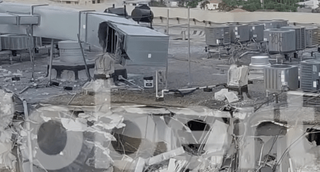

We don't know what was happening inside really. But, strangely underneath that red beam that to my tired eyes looks like the temporary support beam for a was a complete concrete beam replacement that went uninspected and approved. The unit appears to have been fully supported on columns, but why are there solid modifications to a temporary structure that has zero function and was engineered to be as light and easy as possible to support a much smaller unit? That's just bugging me is all.
If those additional beams were installed under to stiffen the support structure and were resting on the roof surface, that would be interesting. Having trouble finding permits for this.
A possibility is the building began to collapse on the interior before making it's way to the deck.

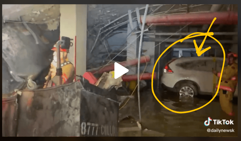

That CRV looks like it took a decent hit from something.
I can't remember where I pulled this close up view of the roof from -
The columns that fail first just happen to be at the bottom of the ramp. They line up perfectly with a car collision. Ignore the eyewitness accounts. The timing is unknown. Car hits column. Enough said. Prove it wasn't a car that destroyed the M11.1 column.

If it was a car that took out a column, they've would have pulled out a car from the rubble with significant front-end damage consistent with that of a car hitting a tree. So far nothing like that has happened.

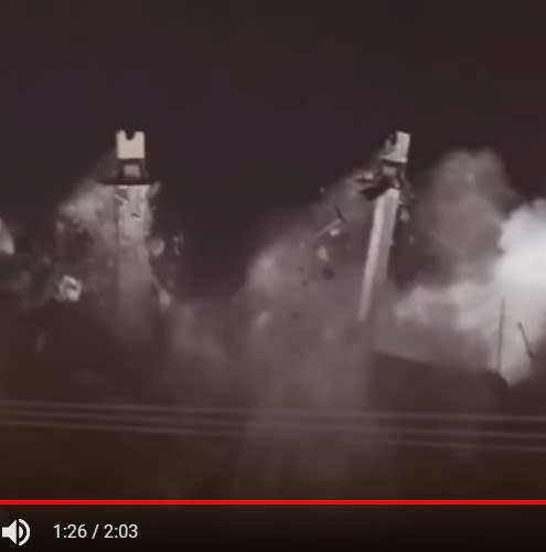

What were these two trunnion-like fixtures (one open, one closed) atop the columns used for?
At 1:26 in
I did a cursory look through the plans, but didn't see anything like that.
