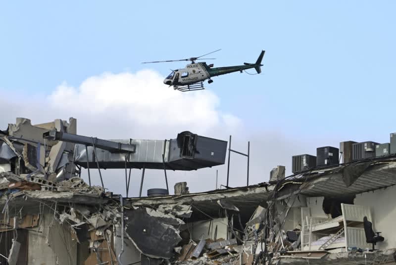

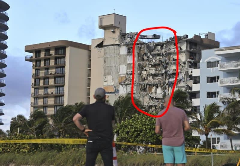

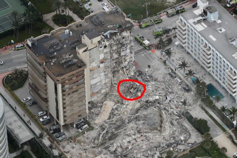

Demented, that red beam is haunting, because we know once the east end of it lost it's footing, that huge unit took a long bite out of
the #4 units, pulling down everything in it's path.
That's an unlikely sequence. Columns E2 and E4 (west side of HVAC beams) survived to the very end, actually defiantly poking out of the top of the controlled demolition as the building fell below them. Columns H2 and H4 (east side of HVAC beams) fell as part of the collapse (the second phase of the tower collapse, delayed maybe half a second by the row 4 columns and eastern shear wall). The 04 units would have been collapsing ahead of or simultaneous to those columns, with the HVAC unit following the columns. The HVAC unit won't have helped, but it shouldn't have really done much more than ridden the collapse of the 04 units down.

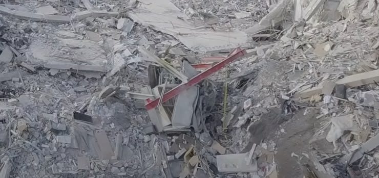

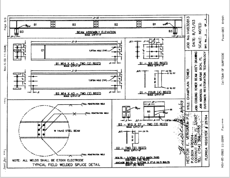

Demented, the HVAC beam in the collapse may not be the one in the permit drawings. The cover letter says that the steel was temporary shoring for the HVAC plant, to allow replacement (implied to be substantially like for like) of the original RC beams. At some point, the new permanent beams changed from RC to the steel we see in recent aerial photos and in the heap. At some point between temporary and permanent, it's not unreasonable to suspect the design may have evolved.
The 2018 inspection shows a photo that indicates the temporary beam is still located on the roof. A section of the bolted and welded area is photographed.
It was designed in such a way that it could be easily carried up the stairs, or service elevator, in sections. Once in place on the roof, it could be assembled (cut and predrilled in the fab shop) and then final welded with a generator/welder combo or a small transformer and access to a 30A breaker. Once welded, would require torch cutting most likely or hoisting down via crane for removal.
Demented, What I see in picture is not a beam assembly, but rather a length of monolithic beam..... And it is on top of Cooling Tower, not under it...
And I see no permanent concrete beam...... in picture
@Thermo
Same. I'm just not counting out lost pixles because potato camera.
I see the beams on top too, but all the beams are on top. It did a barrel roll off the building, kinda like a portion of it was on the still standing section.
The two primer colored beams welded to a red painted beam, in the location of the new unit. Eh. Maybe, maybe not.
Agree, so concrete was never used on roof beam replacement, and they were messing with cooling tower beams during roof work and anchor work?
Or rather they were replacing crappy concrete beam replacement with steel? Duh.....

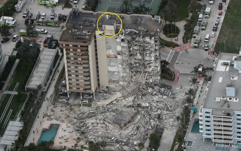

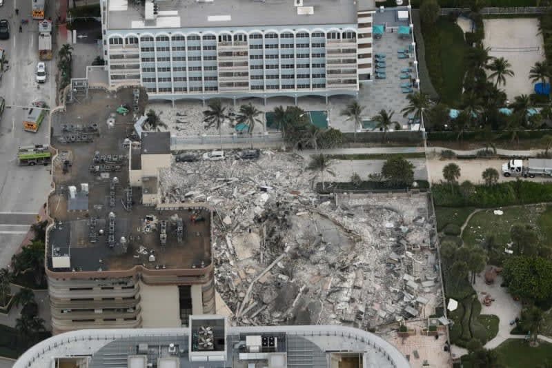

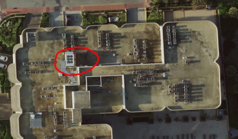

warrenslo said:

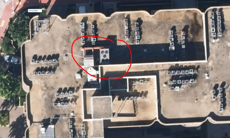

The building changed its HVAC equipment sometime after 2019. This equipment was on a red steel platform with corners sitting on concrete columns clearly visible in aerials. The equipment flipped over the platform as it fell down the building, this tells me it didn't ride down the building but may have been the reason of the collapse - falling first. The new equipment was on sitting the portion of the building that is still standing yet fell. There also is a large gash in the remaining portion of the building under where the equipment sat.
Furthermore, initial reports confused 135 and 136 units, it appears at some point the "Penthouse A" was added (possibly during construction) as the flyer from 1980 for the building only states 135 units and 12 floors. The penthouse is the 13th floor and 136th unit - it was recently sold and the listing noted marble floors. The penthouse and HVAC unit appear to share a column at the SE corner of the HVAC platform that seems to be the source of the collapse.
I wonder if they placed any additional equipment on or near the HVAC platform prior to collapse and if the building was structurally designed for the penthouse. It is also possible the platform itself failed if it was not designed for the new equipment - it does not look like they replaced or strengthened the platform when the new equipment was installed. To me, this does not look like a sinkhole but a progressive collapse from the roof for the first portion that collapsed as it did not tip over, followed by a failure of a low level (possibly garage) column due to debris causing the second collapse where the remaining building essentially tipped over on top of the first collapse.
Note: I have not been able to access assessor or permit info for this building on the town or county websites, it seems to be blocked - which is pretty unusual.
-W
2019 aerial (old equipment):

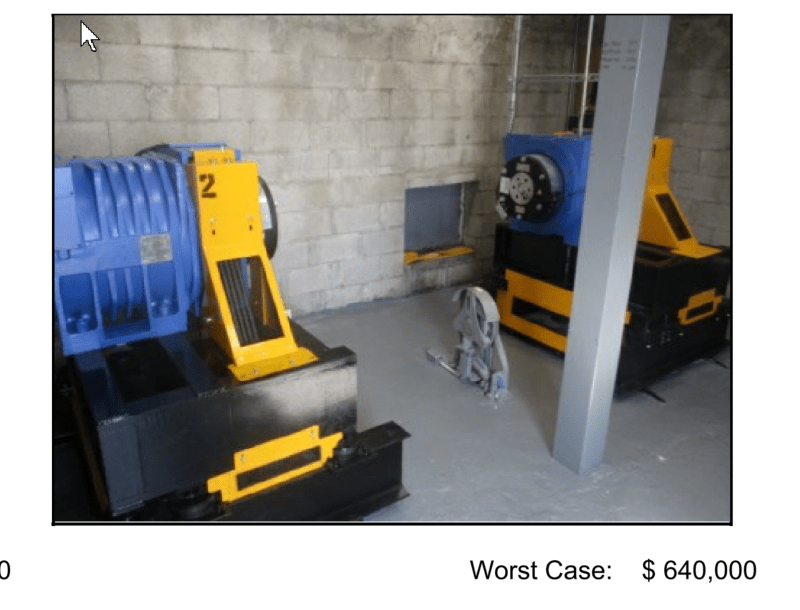

I'm no expert on elevators but the only picture I've seen the lift motor room looked to me like the basement, plus I thought the elevator car went all the way up to the PH... some plans showed a secondary lift too, not sure if that took place either.
Demented, I could also argue that the barrel roll was caused by loss of East side support when that part of building collapsed. The collapse perhaps pulled the steel beam down on east end, thus caused the barrel roll of the west equipment???
Optical98, they extended elevator shaft up with the Penthouse addition. It is a pain to look thru Surfside's out of order drawings on a laptop. What is really needed is to print out documents on large scale printer and then sort in correct order. Elevator room looks normal to me....
On the plans, there are numerous references to an elevator machine room on the roof.
