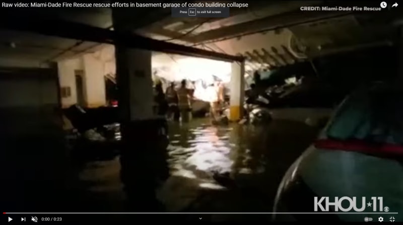

I think so, and the red pipe is on top of Supra. We can see end of open pipe on top of Supra in other pic.
If you go thru the pain of looking back in the forum, you can find some nice overlays of parking spots in relation to where they are at lobby or ground level, along with lots of other good orientation stuff
But wouldn't you see those tail-lights on the CRV, they're not high and wrap around the side?

Right rear.
I'm so confused right now. Them be airbags, dust, or a sunvisor in a parking garage?
Optical98, Please post a link to that video again, I need to watch it closer....
I think it is an old GE Mil Spec Compressor from a Trane, back in the day when "It is hard to stop a Trane" was a valid advertising statement......[laser]
Demented, Could that red pipe on top of car caused the air bag to deploy? Could be sunshade too...
But sure looks like two different air bags to me......

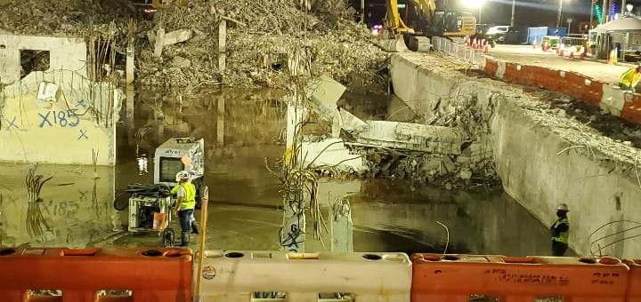

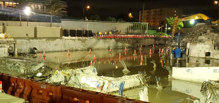

These were posted before, taken by one of the crane operators on site. Of everything removed, they left that rubble pile, and those 3 beams. The rubble pile stood out before to me but I passed it off as nothing. I know the car thing is more interesting however.
I highly doubt it. Usually a massive jolt to a parked vehicle (such as a building collapse), can make the tilt sensor send a "hey we flipped over" signal to the ECU and deploy all the airbags. But airbags and Honda are a different engineering failure thread on their own. I have personally seen Honda's leave the factory with airbags, but no means of the interior trim or dashboard allowing the bags to deploy through (This was in 2008-2010). It's very likely Honda changed to make it super easy for airbags to deploy in light of the whole ZDX fiasco where they missed almost all the laser etching.
I thought I saw the tidy bowl man in a rowboat in that pic. Ok I'm done with humor for now.

Demented, that red beam is haunting, because we know once the east end of it lost it's footing, that huge unit took a long bite out of
the #4 units, pulling down everything in it's path.
I'm still trying to find the exact beam that was replaced. The field reports are not fully, or correctly filled out and it seems half of the pages are missing. That could just be the parking ramp; a 20ft section give or take.
Edit: @colostruct
That's why I've been trying to add up all the weight of the added layers of tile, marble, etc. There was a lot more gravity on those columns than there should have been in spots.
Edit 2: @Optical98
If you look at the beam too, those welds are anything but acceptable. There was no joint prep it seems, and the single pass of 7018 seems to heavily favor the plate. I doubt there is any meaningful penetration on the beam itself. The likelyhood of the mill scale having been ground away so white metal is visible is very slim too. On the beach, you leave that millscale on. It helps with the corrosion resistance.
