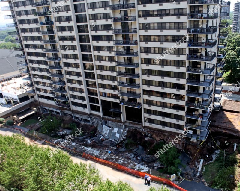

There was a long parking garage attached to a high rise condo building collapsed in 2010 in Hackensack, NJ. The building had much better structural support than Champlain tower, and the collapse stopped at the building line. Residents weren't allowed back about 6 months while the structure was being assessed.
