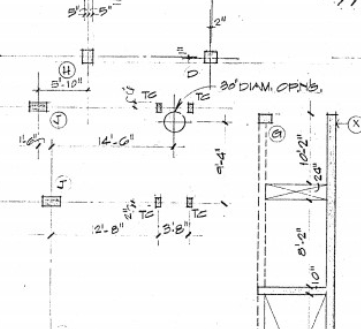

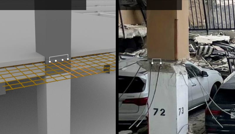

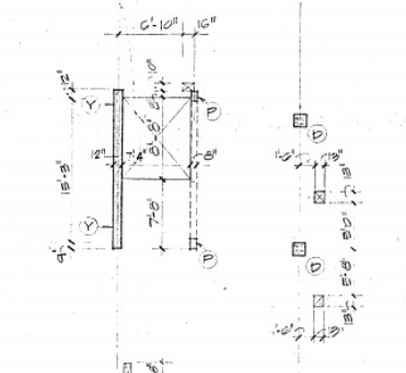

Miami Beach, Champlain Towers South apartment building collapse, Part 12 60
How could the load of a slab possibly applying a cantilever moment and load to a concrete column holding up about 800kips cause a building to collapse?
The south side of the building did not collapse as the slab failed in punch shear and damaged a small area of the column.But there was a beam there tie it to another column. The pics show the column with chunks missing.
So a beam attached to M11.1 tore away from the column and left it crippled. Seismic wave propagated to the weaker columns on the upper floors and punch sheared.
The main step beam needs to be examined as this actually held up the building.
If a joint ran through it that would be the smoking gun.
Also a planter box BM A could have smashed into M11.1 and severely damaged it.
Also the video looks like the collapse starts at the top 5 floors and caused the columns to buckle.
I wonder what shape the piles are in.
SFCharlie said:
...there is an 8" by 12" column called out under the letter "P", that is shown to be used on floor basement thru 11th.
I'm not very familiar with the plans, but I can't find where this column is used.
Scroll up 7 pages to S7 and look at the East side of the East stairwell.
That 8x12 column you are looking for is gridline Column E on the "Basement Level Dimensions drawing", page 33 of 336. On that page look to where the vestibule is in the garage, and out in front of the elevators to the left you'll see the tiny columns with 8" next to them. These also appear on every other floor level page, sometimes with TC next to it, not sure what TC means
Those 8x12 in the middle of the lobby would not be trash chute, they are too small. The trash chutes are inline over the dumpster room
The only photos I have of L, M, N are in our friend Fiorella's garage video walkthrough of the Champlain Towers South last summer. In there we see the Beam between L and M, which I pointed out in our video seemed bowed.
Jeff Ostroff said:
Those 8x12 in the middle of the lobby would not be trash chute, they are too small. The trash chutes are inline over the dumpster room
Those things marked TC are right next to a 30 inch diameter hole that ends at the trash room on the first floor. It looks like they are in the corners of a room that you enter to toss your trash so the trash chute opening is not right in the main corridor.
You might be right then, I got a better view of it of Morabito's plans for the 40 year certification, here is the screenshot I grabbed, and it looks like TC is indeed the trash chute. On the architect plans from 1979 that I looked at it was not drawn as clear as this drawing is.
What are we looking for Charlie? A column by the elevators or over to the east side? Is it a smaller column, I might have a pic of it?
Jeff Ostroff said:
You might be right then,
Thank you.
Page 219 of 336 screenshots of trash chute and the "P" columns Charlie asked for:
Edit to add: TC is not an abbreviation for trash chute because I see TC used in other locations on these prints. I don't know what it means.
Just be careful with this, because page 219 is the Champlain Towers North floorplan. Likely the same, but would have to spend more time looking between that and a real Champlain Towers South pages like 9/336 or page 10/336 or page 20/336, but none of those pages shows the 8x12 columns like the eengineer's drawing that I pasted above.
Jeff Ostroff said:
Just be careful with this, because page 219 is the Champlain Towers North floorplan.
You are correct. Try page 29 of 336.
Edit to add: TC stands for tie column. Page 38 note 9.
Nukeman948 (Electrical)3 Sep 21 01:16 said:
Scroll up 7 pages to S7 and look at the East side of the East stairwell.
Jeff Ostroff (Electrical)3 Sep 21 01:24 said:
That 8x12 column you are looking for is gridline Column E on the "Basement Level Dimensions drawing", page 33 of 336.
Nukeman948 (Electrical)3 Sep 21 02:39 said:
Page 219 of 336 screenshots of trash chute and the "P" columns Charlie asked for:
Jeff Ostroff (Electrical)3 Sep 21 02:44 said:
...spend more time looking between that and a real Champlain Towers South pages like 9/336 or page 10/336 or page 20/336, but none of those pages shows the 8x12 columns like the engineer's drawing that I pasted above.
Great post!
Nukeman948 (Electrical)3 Sep 21 02:54 said:
Quote (Jeff Ostroff)Just be careful with this, because page 219 is the Champlain Towers North floorplan.
You are correct. Try page 29 of 336
Thank you all for the help!
Optical98 (Computer)3 Sep 21 02:32 said:
What are we looking for Charlie? A column by the elevators or over to the east side? Is it a smaller column, I might have a pic of it?
Thank you, for your offer!
I didn't know, that's why I asked!
SF Charlie
Eng-Tips.com Forum Policies
O S, now I C D gofish.
Between M and N, 2 & 4...
Woo! I'm glad I wasn't a construction supervisor on this job.
Page 42 of 336 near the elevator actually has it spelled out as Trash Chute, confirming the location of those 8"x12" columns.
Jeff Ostroff said:
Page 42 of 336 near the elevator actually has it spelled out as Trash Chute, confirming the location of those 8"x12" columns.
Well yes, but actually no.
My first post on this subject had all the correct information Charlie asked for.
Your first post, after mine, was the wrong columns, then you continued to try defending incorrect information and told me to be more careful about where I found my information.
"P" columns are different from "TC" columns in the amount of rebar and concrete strength for each floor.
And here you are still defending the wrong columns.
We done?
