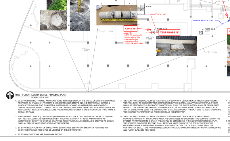

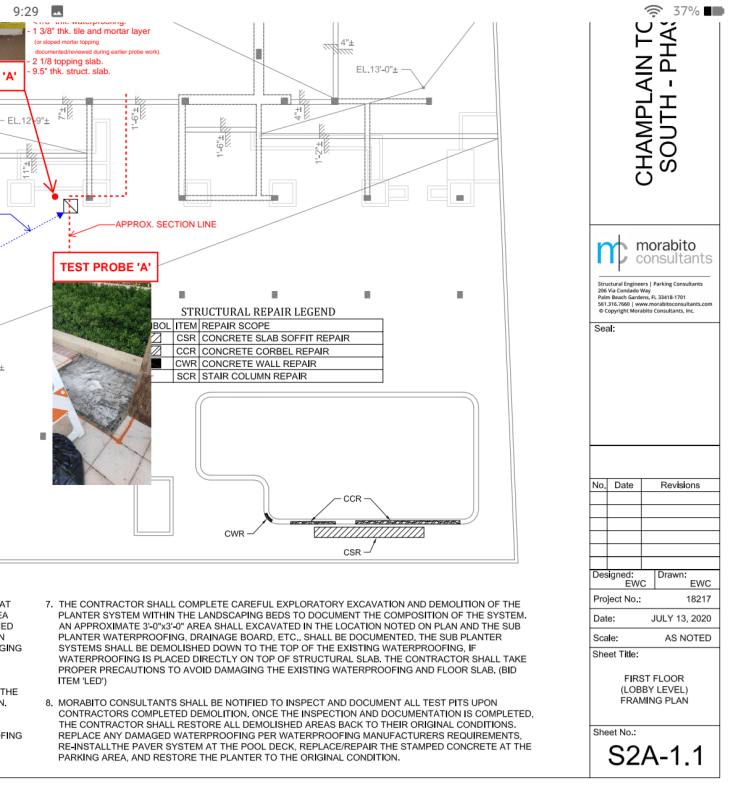

From the document "20201014bodminutesapproved", per Morabito's memo dated October 13, 2020 (Re: Champlain Towers South Condominium – Phase IIA, Summary of Work Performed) "At completion of the investigative work CPR restored each exploratory (and core) location back to its original condition." The attached and marked up plan sheet S2A-1.1 is more detailed in the scope for each core sample site, GPR wasn't mentioned. I'm not sure if that's what the memo refers to when it says "The
results of exploratory demolition and the additional core work are summarized in the attached “CTS Test Probe
Notes” file" or if that's a document that hasn't been released? I don't recall having seen it but that doesn't mean much.
The rest of the notes from S2A-1.1...I can't extract the individual sheet at the moment, I can do so later on today for anyone who doesn't want to go on a pdf scavenger hunt.

arbitraria (Civil/Environmental)7 Sep 21 14:10 said:
"Properties East of Collins Avenue Structural Assessment Recommendations Letter" dated July 7, 2021
