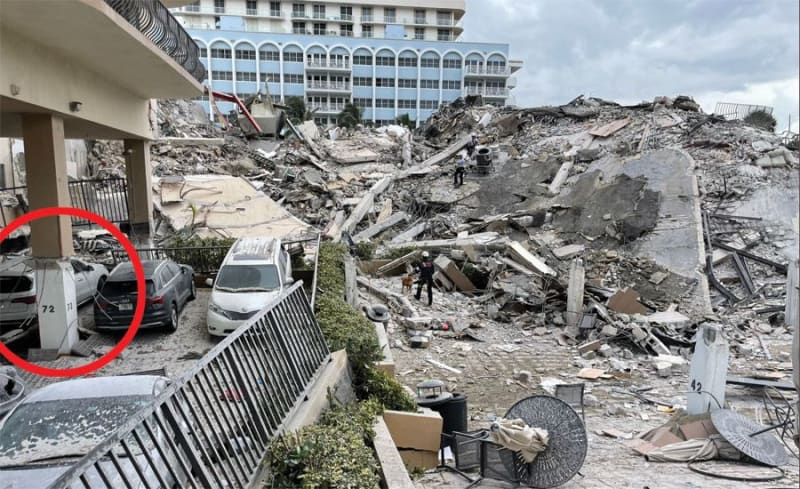

> The unusual pencil-sharpening of the columns is to me a critical feature.
It's certainly atypical for a puncture shear - normally the slab shears and leaves a piece of itself behind, but here it almost looks like it was the column that failed first. And the slab's rebar should have run through the column and made that clean failure impossible, too.
Well, the columns, in most cases, are still standing, but if one looks at the fracture of the top of the column, it almost looks like a cold joint. It is not, if one zooms in, one see the barest hint of white aggregate. The planar failure reminds me of the core samples. The failure stretches from rebar to rebar. Spalding?

Charlie - I think you are onto something. Most punching shear failures leave concrete from the slab on top of the columns. The pics of the UK parking structure show that. Four way flat slabs have tension on the bottom face, and therefore probably cracks, over most of their area, due to the positive moments. And they have tension on the top face at the columns, due to the negative moments there. The probable tension zones are reinforced to address/resist the moments, and that means placing reinforcing near the top of the slab over columns.
Compressive stresses in concrete can assist in resisting the entry of water (but not make it impermeable). Tension cracks welcome water.
While the slab over the top of the columns was the high point (unless drainage slopes prevented this) the overlay materials and the low slopes to drain could have created cases where the slabs over the columns were saturated also. The cracking there would have allowed that moisture into the slab and caused the concrete to deteriorate. If that deterioration led to the loss of strength in the concrete the negative moment strength would be reduced.
Now imagine, if you will, the reinforcing passing over the top of the column, and being pulled downward by the anchorage in the slab - and finally reaching the point of being an anchorage to the catenary tension in the reinforcing. The bars pass over the columns and the corners of the column must support the load in bearing - and maybe fail from that unintended force.
So the corners become "rounded", if you will, and demonstrate the effects of spalling..
Just speculation, but maybe it will provide some mental image of a possibility. We can see the results, this is what I think is one possible reason.
I am perhaps misreading this, but it sounds like the corners were "rounded" by the bars passing them as the slab descended.
If this were the case, there should have been those bars still connecting each "side" of the slab. They would now be found surrounding the bottom of the columns.

This one has both rounded column and dropped slab preserved, at least until they collapsed the remaining part of the building. That visible lower loop of rebar may be a culprit for ripping out the side of the column, but who knows?
