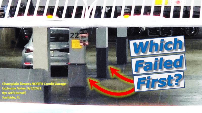

I just uploaded my video this evening where I drove over to Champlain Towers North who has the same garage, next door to the collapse site last week, and recreated the tourist video in the daytime and even got cars coming out of the garage and the gate opening up so we could see all of the columns very well lit and back to the back wall to show like wherre the debris field was in the tourist video, which was shot 5 minutes before the condo collapsed. Here is a screenshot I made showing the columns:
Jeff M11.1 is rotated 90 degrees in north building. This column is 12 by 16. At south the wider 16 inches would be facing the ramp. In north the 12 is facing the ramp.
Technically this would require a much higher speed of vehicle impact to bottom shear the north M11.1 column. All the 11.1 columns are rotated in the north building.
Did they learn something in the process of building south?
Easier to park if you rotate the columns?
spsalso
There must have been other reasons to rotate those columns, you only gain 4", not a big difference in parking

Jeff Ostroff said:
Which failed first?
Well it can't be "22" at CTN, (which is "27" at CTS), because it was still standing in the tik tok video.
