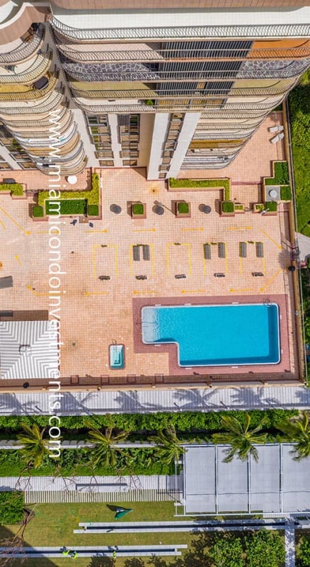

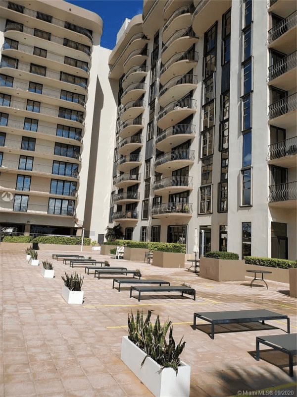

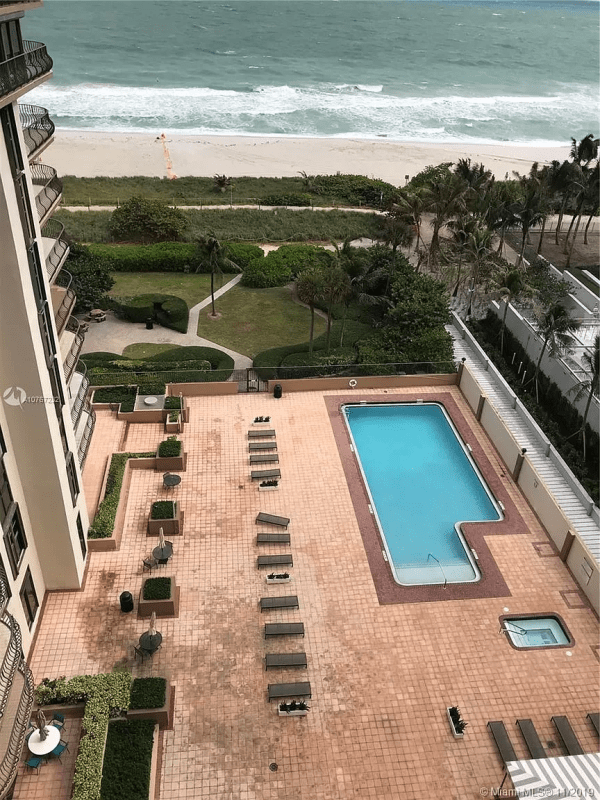

My former condo 7 miles inland has all sorts of rebar rusting and spalling and it is nowhere near the coast. So while salt intrusion might be present I think the far bigger threat is the freshwater rains of any water type that soak into the concrete. Any pool deck that is over a garage and not built on the ground is not seeing salt water intrusion from the water table, because it is elevated off the foundation below it. Plain and simple this pool deck had water pooling for some time, we even saw numerous MLS photos I have shown where water was sitting there on sunny days with nowhere to go. Everyone wants to keep blaming it solely on the ocean, but think of it as only a contributing factor. Note these photos below showing standing water or stains, and pooling water on concrete is worse than anything else because concrete is a sponge to water.

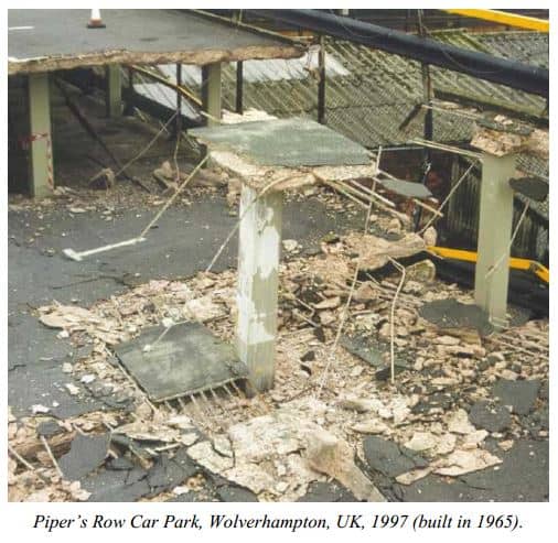

Charlie - notice the size of the remaining slab atop the column - particularly relative to the column ? It appears the Piper's Row Car Park slab had drop panels at the columns.
Note that image having what looks like a 4 foot square section of slab remaining and compare that to any of the columns at CTS pool deck area after the slab dropped.
There was likely the delamination and rusty reinforcing as you suggest, and ( I suspect ) VERY weak concrete likely due to the effects of chloride damage to the slab.
I await compression test results of core samples and a chemical analysis to show the chloride content. I am not sure the concrete I have seen in the pics can be effectively analysed using petrographic examination.
Thanks,
Theres a number of parking parkades here in Calgary showing seriously exposed badly corroded rebar. Calgary is 1000 kilometres from the ocean. I dont think anyone has suggested salt in the air is the cause. Might want to revaluate how critical / relevant this salty discussion is.v
Piper's Row Car Park did not have drop [panels, they had the typical punching shear perimeter at each column, which Champlain for example had 16 #5 rebars in a line across each column if I remember correctly. Piper's Row Car Park used a lift slab method and anchored to the column with wedges.

What makes that standing water situation worse is the fact that the drains on the deck were known to be inop damn near all the time, especially when the building next door was being built. Water pooling for days on the deck, especially in shades areas closest to the building, was a constant resident complaint.

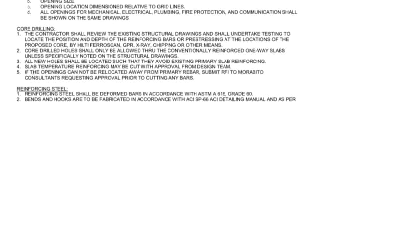

ChiefInspectorJ said:
A main reason for the slab failure and then the building was months of vibrations from the new Condo being built next door. Basically continuous seismic loads microscopically cause loss on rebar bond strength.
I guess that explains why they have never successfully built buildings close together in New York City.
The unusual pencil-sharpening of the columns is to me a critical feature. Poor concrete, poor rebar placement or something else. It stands out and has to get a mention in any logical assessment of the collapse.
Re the core drilling. Morabitos specs for core drilling stated (somewhere) that structural reinforcing should be avoided. This below was posted by Lizard7709 back in thread 4 but the exact source was not stated
AusG (Petroleum)8 Sep 21 01:51 said:
Re the core drilling. Morabitos specs for core drilling stated (somewhere) that structural reinforcing should avoided.
This is from:
8777-collins-avenue---preliminary-review-plans-for-40-year-re-certification.pdf (sheet 2)
Which can be downloaded from the City of Surfside Champlain Towers Public Records & Media Information
Use the Sherlock Homes looking glass to search for "40 year" for example.
SF Charlie
Eng-Tips.com Forum Policies
"...requesting approval prior to cutting any bars."
Bars appear to have been cut. Was there approval?
I ask not because I think it contributed to the fall, but because I would really like to hear about someone involved who did a Really Good Job. I like people who do Really Good Jobs. Warms my little heart, it does.
