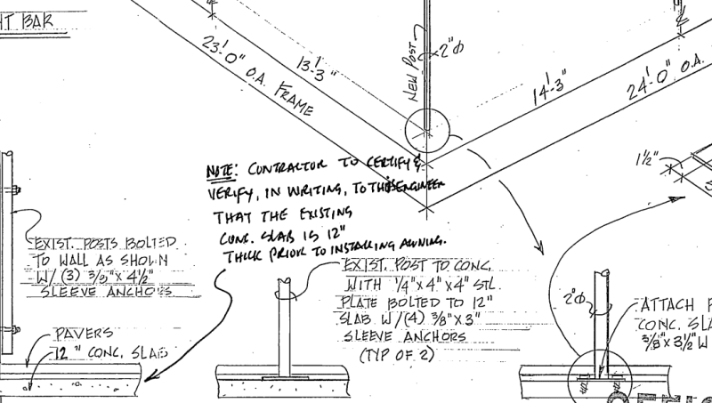

 https://files.engineering.com/getfile.aspx?folder=a395e775-4ceb-4490-934e-a7de2e9ba9ff&file=318-71_1976_supplement_chapter_10_pages_7_-_8_of_29.pdf
That specific note, sometime in July 2004 likely.
Permit 04-00000469
SFCharlie said:
Wow, do we have a date?
WOW? I thought we were expecting 9.5 inches of structural concrete, then at least 2 or 2.5 inches of topping concrete?
So if it's less than 12, call the engineers so they can evaluate it seems like pretty standard stuff to me.
Then they chip off the tile and sand and bolt directly to the 11.625 inch slab.
If I was the contractor I would just call the Engineer to get a clarification of what he expected and what I found.

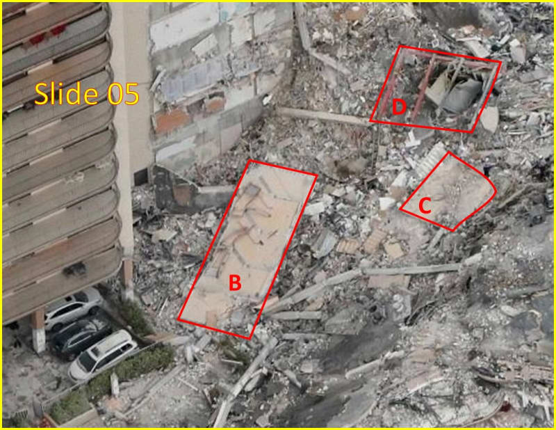

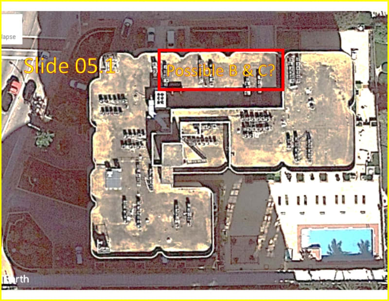

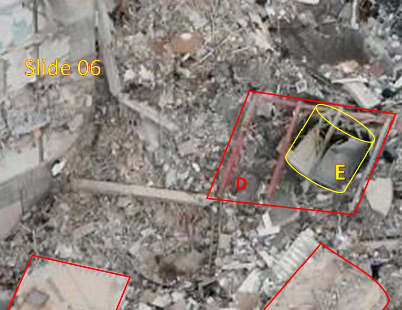

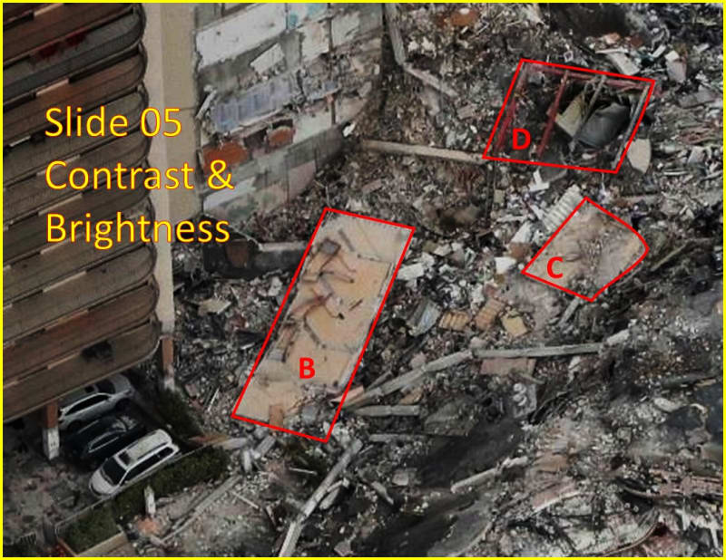

Optical98 (Computer)2 Sep 21 03:16 said:
Also, did we ever decide what these items on the roof were, this is a satellite photo est date 6/22/21, showing the roofing crane as roof work was still in progress.
What is that large round silver object?
Did we ever get an answer? UFO?
SF Charlie
Eng-Tips.com Forum Policies

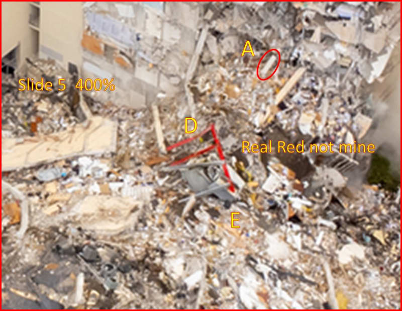

SFCharlie
Now...10 days later you're asking me this? I didn't see a response. But the picture I added with my question wasn't high res to say the least.
So Unidentified Object, Not flying.
Isn't E just the HVAC unit which sat on top of the red framework (D)?
Note the red framework has been flipped upside down (the short beams running up/down the page hung under the long beams running left/right across the page).
Unidentified object E is then the HVAC unit, smashed and split open along the seams.
Check the photo provided by Demented (3rd post, part 9) for reference.
