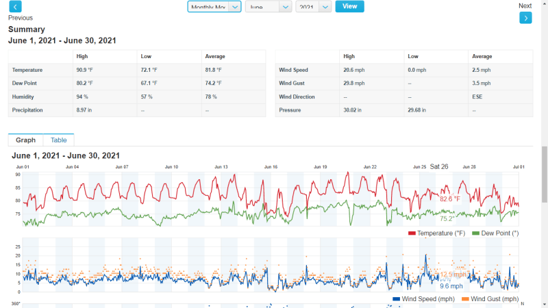

That day, under .2" if I recall correctly. Workers on the roof did leave early due to weather, but it was also very gusty that day.
Rain was heavier the prior days.
Demented, where’s the best place to look at the rainfall history, please?

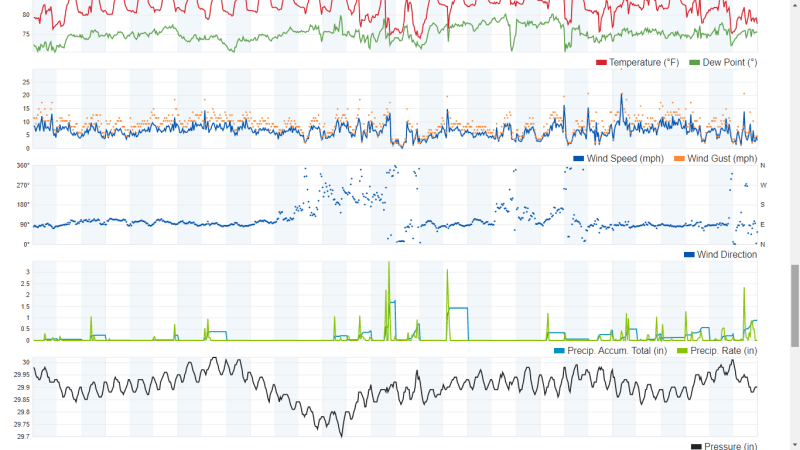

At the airport, precipitation from 6/10-16 was 1.6” and from 6/17-23 was 1.94”. 1.1” of rain fell two days earlier, on 6/21. It was very gusty prior to the collapse, going all the way back to 6/14. So for two days before the collapse, there was a lot of water sitting in the deck at the same time as the roofers were drilling into key columns and the wind had been gusty for nine days. It rained heavily on 6/24, after the building had already collapsed: 0.58”.

There was a weather outpost a block or so from CTS that had rainfall data I looked at but WeatherUnderground doesn't seem to want to work for past history anymore; keeps using the airport's data but that's good enough for the 2 days leading up (though 3 days before the collapse the contractor who was there inspecting for pool work stated he saw standing water all over the garage level floor.

I figure around 91,424.49 gallons of rain water fell on the structure over those two weeks and that is close to 726,843.4 pounds of dead load. That is roughly 7,724.37 pounds per column. Where did all that water go? Why have there been no reports of 1.94 inches of standing water from any of the eyeball witnesses? Did it all soak into the pool deck? (those are rhetorical questions)
Concrete is not a sponge capable of absorbing unlimited amounts of water no matter how cracked and poorly maintained it is. Even with the poorly designed drains and the flat pool deck, most of it still flowed down those drains or simply evaporated.
Rain water certainly added to the list of reasons for the collapse but calculating the previous weeks rain out to the hundredths of an inch without even trying to determine how long it took to be removed or how much was still there at the time of collapse seems pointless. This building survived 40 years of rain and hurricanes and the last two weeks weather is not going to play a major role.
I just verified that the second link I provided Maud (Point lake - KFLMIAMI597), works. Scroll to the bottom of the window and then page up to the top of the graph. If one wishes tabular data, click "table".
Surfside Florida - KFLMIAMI583
is another...
Full resolution attached below.
