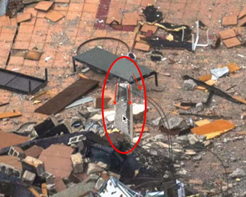

Am I missing something here?

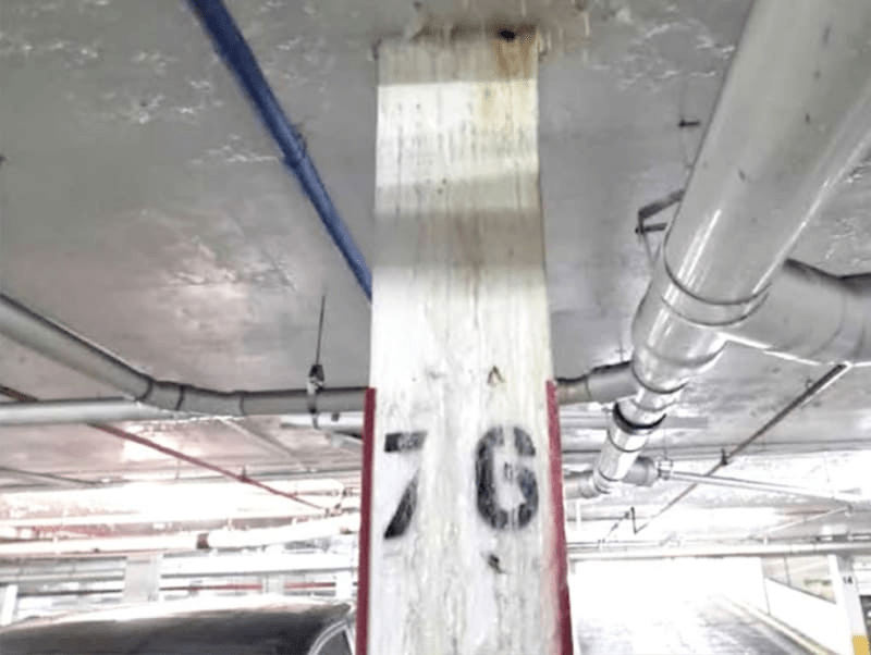

From the picture previously posted below, we know water was pouring down the South side of the column, so apparently already a crack on that side.
The compass heading to SW of that one rebar could be the tug from the parking deck area collapse?
Typical punching shear failures leave a piece of the slab hanging on the column head and more importantly do not cause damage to the column head itself. In this case all of the column heads suffered moderate to severe damage, even the one next to Jacuzzi that still had the back half of the slab attached to it.
I could picture 1 or 2 columns doing this but since it was every deck column, it points to a design or material defect in the columns as well as the slab.
thermobaric (Military)22 May 22 17:33 said:
Am I missing something here?/quote]
You probably see that as the deck drooped over the column, it bent the rebar down. What's being discussed is that the rebar appeared to have been running north south before it was bent down. I remember posts and video showing that the rebar in the deck also only ran N-S, Not W-E as it should have in the before construction plans.
Yes. There was much discussion early on, that the columns were too small, with rebar too close to the surface.
Of course they are bent down but they didn't turn to the north and south form their installed NE/SE/NW/SW directions. They weren't installed in the designed orientation. Not worth three posts explaining if it was even worth one.

EDIT on Two Way Slab Column Offset: The link below quotes ACI 318-11, and says column offset shall not be more than 10 degrees. Again, I think SFCharlie has the ACI Code from 1979, and could perhaps confirm what it said in 1979.
Under limitations, "Column offset of more than 10% of the span (in the direction of offset) from either axis between the centerline of the successive column is not permitted."
Construction Engineering & Failure Analysis is saying the bar is torqued because of the horizontal angle between columns. i.e. the bar is not orthogonal to the stresses. I'm trying to digest that.
Unlike "kai" (funny, but I don't remember that was his name, when his channel was actually called "structural engineering and wedding photography"), I don't have people paying me to correct my mistakes, so I'm not looking it up. Y'all gona hafta take his word for it.
