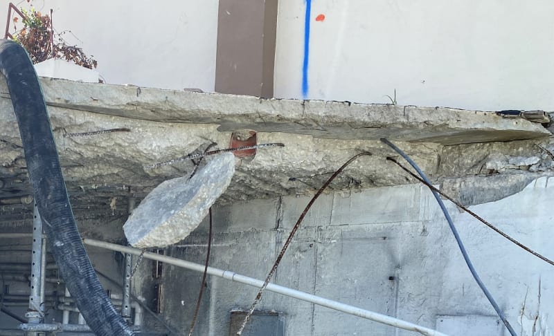

the image of the exposed top of sheet piles in area of interest,

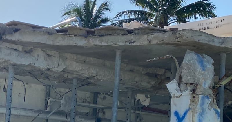

I'm interested to hear what others think but I think the feature highlighted in the image in my 21 May 22 05:30 post is closely spaced rebar rather than the top of the sheet pile.

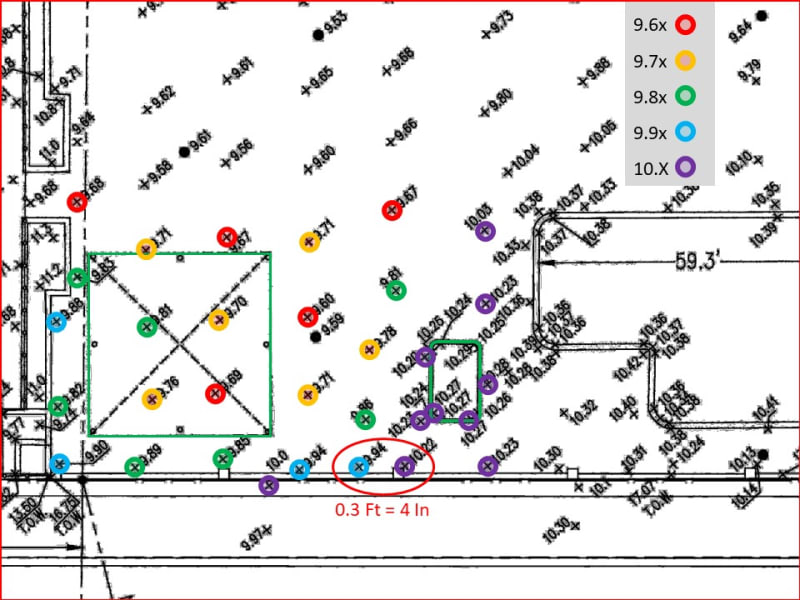

SFCharlie said:

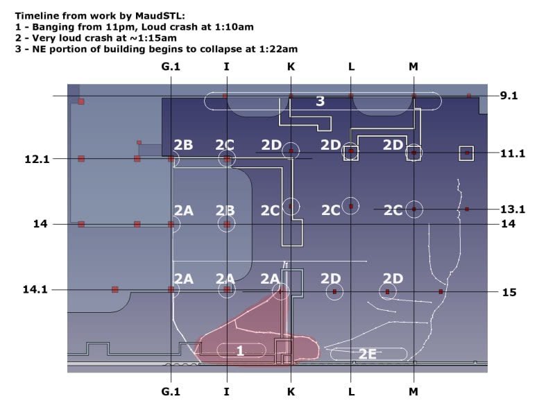

Here is my first attempt to visualize the elevations.
Thank you very much for taking the time to do that work SFCharlie, it is helpful.

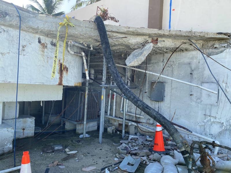

IanCA (Mechanical)21 May 22 05:30 said:
Quote (thermobaric)
area that appeared to drop into sink hole
Since the responders are looking over the wall at the debris, I assume they are standing on the gravel that the construction to the south replaced the street (and walk?) with.
The exposed rebar seems to me to imply that the construction changed the structure of the wall.
I bet they didn't analyze this.

Some more work in the South Wall Area:
SF Charlie
Eng-Tips.com Forum Policies

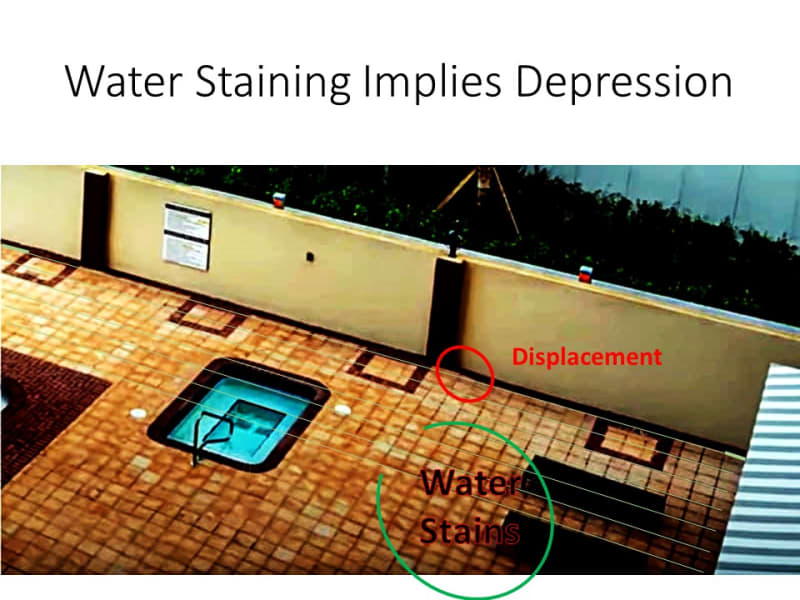

We don't have any information to conclude that the dip is anything other than a surface feature. A 4" step stemming from slab deformation would be immediately apparent in the garage and alarmingly so.
Note the significant amount of sand (or additional topping) under the tile in the area between the hot tub and the pool. In the first image, it appears that the sand layer tails off to nothing.
Thanks for the photos. Do you think that was done intentionally to prevent rainwater from draining into the pool and hot tub, perhaps?

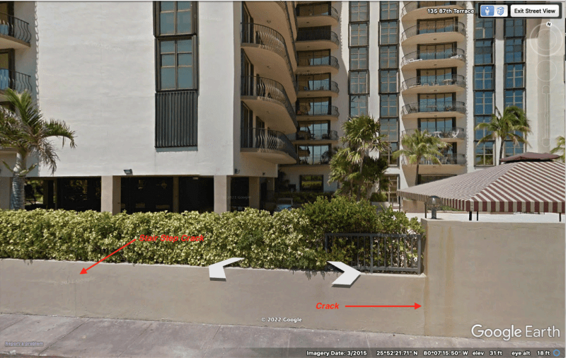

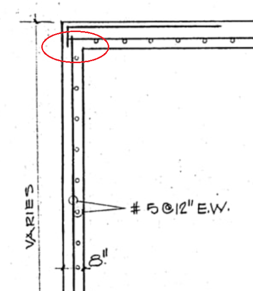

I agree with this in theory, but in practice, if design was weak (a single row of rebar at 12" centers, with minimal engagement), the construction was not well monitored (not considered a critical part of the structure), after years of corrosion, with regions bounded by construction joints, and the deck cracks as shown below (from thread 15), then the deck will be pulled from the wall.
Weak wall-deck connection:
Location of cracks and movement of deck matching photographic evidence (I hope you don't mind me using the version with your markup MaudSTL):

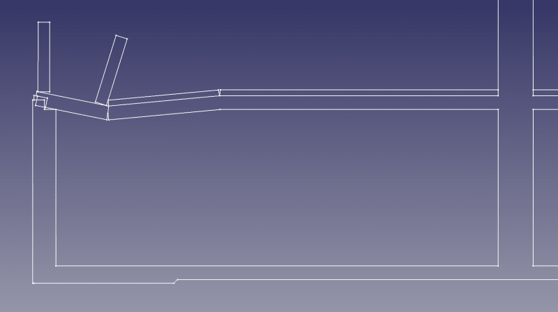

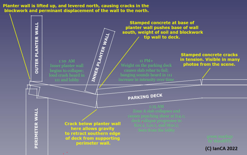

Edit: If the wall-deck connection was as strong as it should be in theory, why did it fail at all? I don't believe there is a mechanism that can achieve the tension cracks seen in the top of the stampcrete in the parking deck if the collapse begins North of column line 15. Can anyone sketch a sectional elevation showing the intermediate positions of the deck components that achieves those tension cracks in the top surface?
Unfortunately, from a physical standpoint, that sketch is not realistic.
Please can you be specific? I would like to understand more about your perspective and see if it can be improved at all.
It needs a support under the proposed break on the right side of the image.

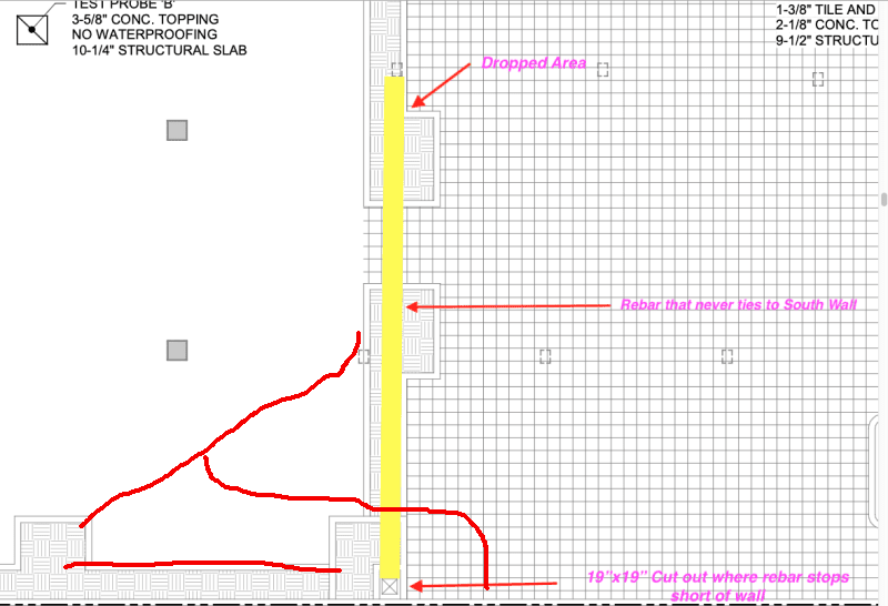

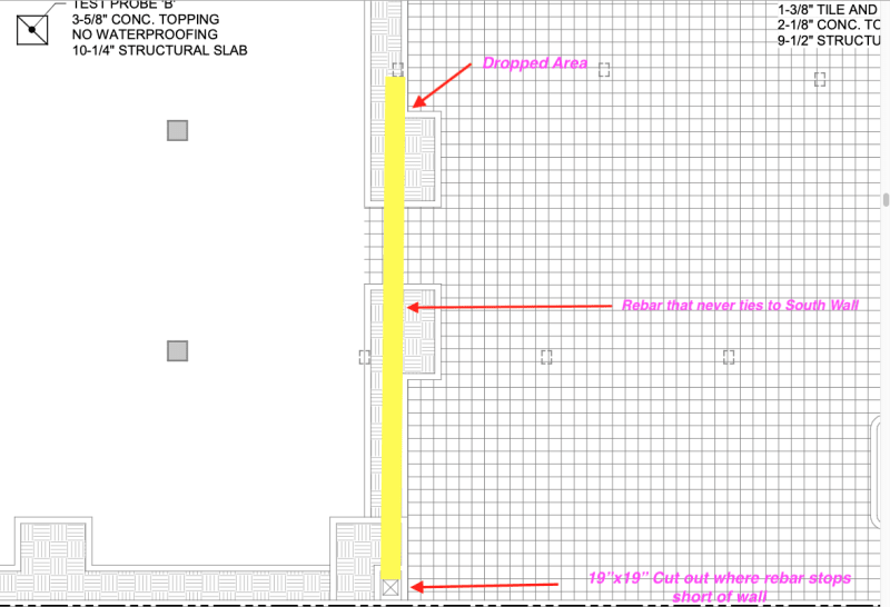

IanCA, I am not sure exactly where in your section view the cracks area located. Perhaps you could add them to the image below, where I show clearly the initial dropped area in MH released phone aligns with 19"x19" slab cut out for pool exhaust fan, thus no continuous rebar attachment to South Wall in North-South Plane which is the 'heavy hitter' of the two way slab... Thus could explain a more localized failure at first, and be source of your crack propagation?
That section of the deck is supported in cantilever by the columns to the north:
Remember the crack in the top surface in tension runs from the South-West at planter at column line G.1 to the North-East column at Column line K as shown in the diagram in my post on 27 Feb 22 18:29. Included again here for convenience.
Approximately like this. With the section on column line I.
And of course, there is a discontinuity E-W too, at 19"x19" Hole in slab.
