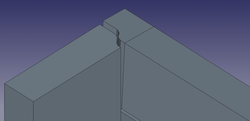

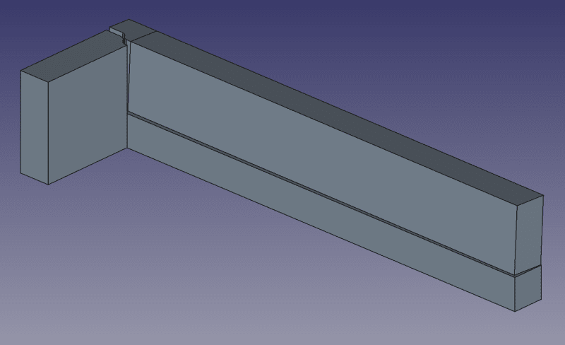

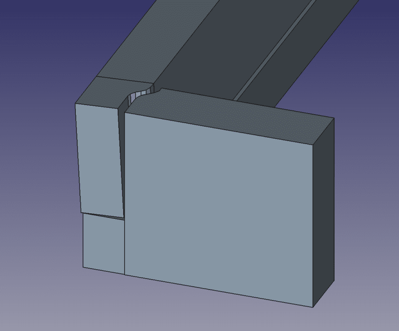

Are the images below a possible explanation for the apparent vertical offset at the planter?

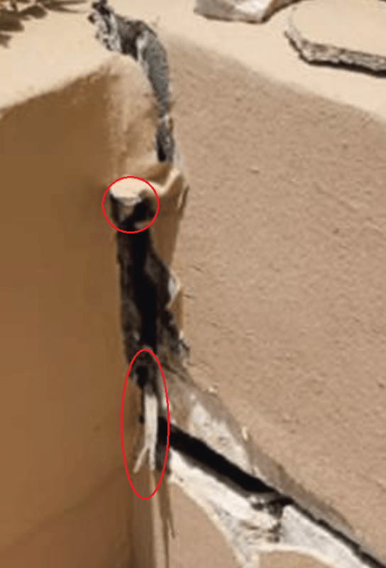

If you look closely at the gap you can see two branches emerging. Both have been torn off, the top one appears to have scrunched the paint up as it was broken off.

Edit: I think IanCA has identified that roots may have played a role in the separated planter corner, and perhaps that area had been trouble before and roots were cut back and it skimmed over and finally let go. I did see in some of Kai's video's where it clearly looks like the planters on both sides of the parking deck/patio gate were already sagging.

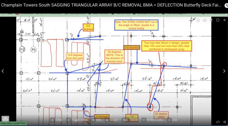

I would also like to note Kai talks about torque on two way slab created by columns that are offset and NOT aligned, and point out that the worst area in between K13.1(under East Planter wall) and K15 (parking deck west side of planters).
He cites ACI recommendations on column offsets and says design is not complaint even in 1979. I think SFC has a copy of those docuuments and could possible comment on that or provide confirmation of Kai's statements about allowable offset angles between columns on 2 way slab.

So per IanCA's graphic, the roots are raising one side of planter wall, while displacing East the other side.

I don't see anything about roots in IanCA's graphic?
The red ovals have been IDed as elastomer, possibly from a previous repair.

Thanks for your feedback SFCharlie. I will add further notes to the graphic.
I feel confident that the longer red oval contains a root or branch. It doesn't connect to other areas of elastomer, it has a different color, it has an outline suggesting fibers and less flexibility, and it extends from the crack, not the surface.
I did speculate about the contents of the upper red circle I cannot really see that clearly but I see the paint was scrunched up. That was possibly done by the object in the lower circle which sprang back down after being pulled up and broken off?

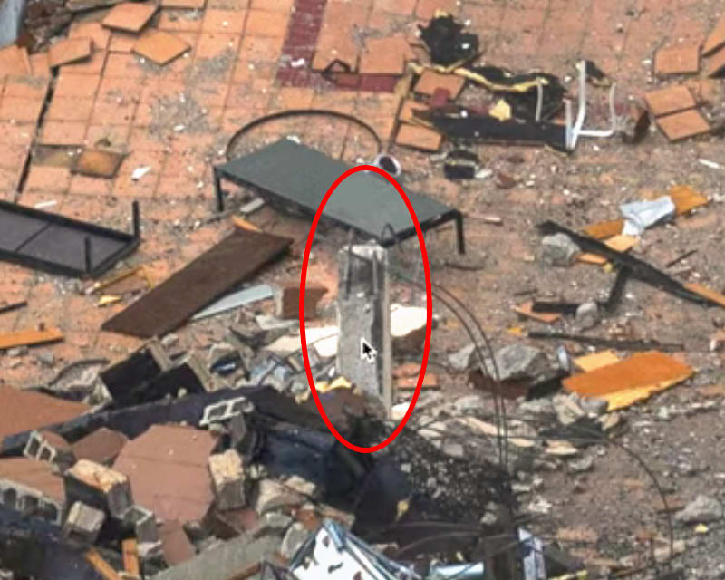

In the photo posted by Sym P. le (Mechanical) 17 May 22 01:30, we can see the joint after it was picked apart, and behind that, what it was like before it was picked apart. there may be small roots in the joint, but roots can't explain the large displacement including in the deck.

You make a good case. This might be an example of people seeing what they are most predisposed to see. Confirmation bias. Those darn photos. An engineer looked at the actual site and said it was roots. Why is it so easy just to dismiss that?
