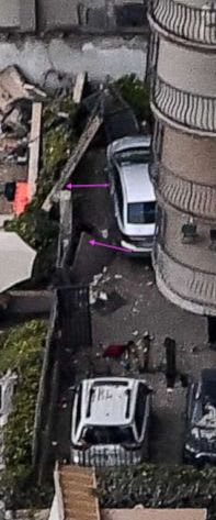

And area that appeared to drop into sink hole was a low spot, based upon drain locations and survey, and over loaded more.
The cropped image below, IMO shows movement towards the sink hole.
Edit: Actually rotation of planter wall may be more of the opposite effect, or indication of movement West at South wall end.

It appears to be in this photo.
Absolutely. The elevation survey shows a change of 3.36 inches (10.22-9.94) between two adjacent points close to the jacuzzi and the wall.

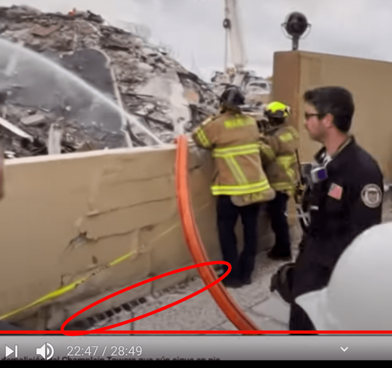

a) Neither model appears to make provision for the construction joints that we know played a critical role in limiting the area of deck collapse and also played an important role in the geometry of the deck after the collapse. For example, the linear depression that runs East-West through the pool deck gate.
b) Neither model appears to include the 19"x19" penetration through the deck that was formed to allow exhaust from the pool equipment room to be vented at the corner of the pool deck.
c) The Structural madness model does not make any allowance for corrosion of the steel or degradation of the concrete and we know they are both critical factors in the collapse.
d) Neither model appears to include any provision for as-built, or as-repaired, conditions of the deck at the Southern edge, as shown below:
Credit to Construction Engineering and Failure Analysis for originally posting that clip.
e) Neither model explains why there would be a dramatic discontinuity in the deck between the pool equipment room exhaust vent and the gate. The area identified by thermobaric in the image above.
