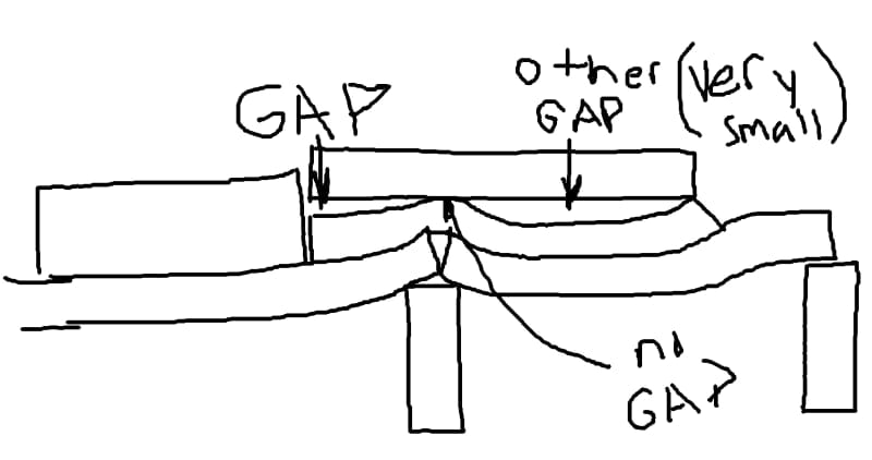

If that slab drop detail is in bending transverse to the 12" upstand, it makes for quite a good hinge.

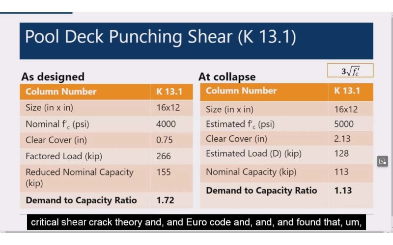

With regard to the pool deck punching failure, WJE suggested that using a coefficient of 3 instead of 4 may be better when considering critical shear crack theory:
I found an article titled "Addressing Punching Failure" that supports WJE's point. I am uploading it.

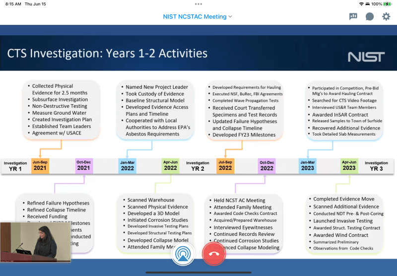

Very early in their overview, NIST stated that they have to date found no CTS security cam equipment/videos.
Effort to date:
They explain the involvement of MDPD investigation as a “death investigation that could become a criminal investigation.”
The agenda has been updated with links to the presentations.

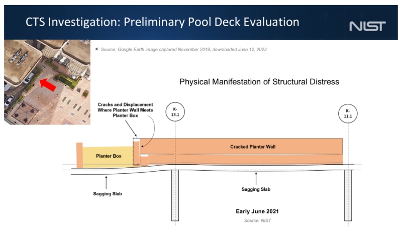

In the Concluding Remarks presentation, I t appears they are looking at K13.1 and the planter as the initial point of failure. Let’s see what Glenn Bell has to say when he does his presentation.
