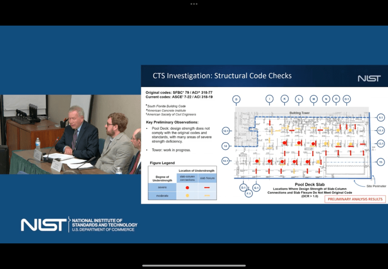

Also see slide 6 in the following presentation:
Thanks very much, SFCharlie. Incidentally, I noticed earlier that slide 2 of that presentation does not include the Jacuzzi. I sent a message to NIST to let them know.
And the pool profile is wrong.
I Think the point here is that they were comparing the original design against the code at that time, not the as built design.

SFCharlie, i think they are doing as built check as in talk on deck slab that the top of slab rebar cover was 2 " rather than 0.75" design cover and that it would lower the capacity alot for punching shear. I know that here was talk here should be larger cover on exterior slab because of salt sir from ocean.

Yes, I agree and can appreciate that, but the discrepancy isn't noted on the slide and wasn't explained in the presentation. It seems to be a rather academic exercise to study a design that is known to be significantly different from the design that collapsed. Is it fair to say that since the Jacuzzi and pool survived the collapse of the pool deck it should be possible to study the design with those features accurately modeled? That was not stated as an objective in the presentation. This also highlights the importance of retaining copies of the drawings which were approved for construction. It sounds as though NIST will be making some recommendations in that area.

In the third video, they talk about the contractor who did the calculations for the deck and say that they are still working on their calculations for the tower. In the slide it says “Tower work in progress.” So I think in six months we will see the results of those calculations and get more details on the tower’s flaws. The theme of this meeting, after the presentations of “this is what we are working on and how we do our work,” was “what we know about the deficiencies of the pool deck, which collapsed before the tower collapsed.” This meeting did not even mention how the pool deck could have caused KLM to buckle and bring down the tower.

WJE said the deck did meet code at the time even though the code was probably inadequate. NIST is saying most of the deck was never anywhere close to meeting code. Anyone know why there's a discrepancy?

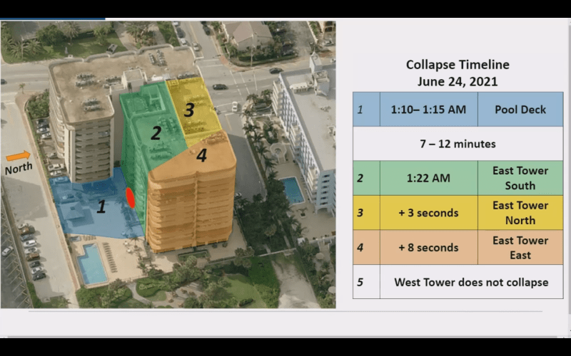

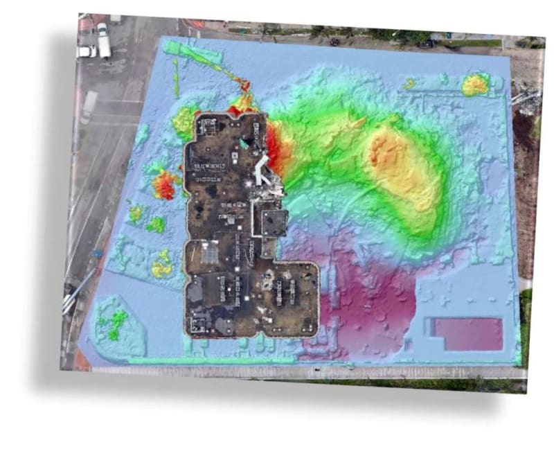

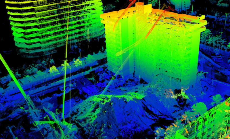

The WJE illustration shows 4 sections that collapsed in order from 1 to 4. I will ignore the pool deck for now. Please see the 2D NIST debris pile elevations.
(I am also attaching a similar 3D diagram.)
On the 2D diagram, the lowest elevations (i.e. the fallen pool deck) are dark red, while the surviving pool deck elevation is light blue. The next highest elevations are green, then yellow, orange and finally a rusty red. There is very little green within the footprint of section 2, which is mostly blueish.
It would appear that most of the debris from section 2 fell into the footprint for section 3. The first conclusion is that section 2 fell into section 3, thus causing its collapse. I am proposing that the debris from section 2 was subject to an unbalanced moment caused by the uneven collapse of the section 2 columns. The resulting moment then caused most of the section 2 debris to fall 20 to 40 feet further north than if it had fallen straight down.
