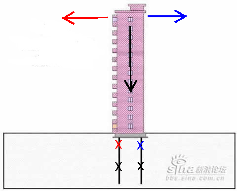

Please see the following illustration of a building in China that fell over. For illustration purposes, I am going to pretend that the foundation piles are "columns".
It seems logical to me that if the "column" to the left marked by a red X collapsed first and the "column" to the right collapsed some time later that the building would then be subject to an unbalanced moment that would cause it to fall in the direction of the red arrow. Similarly, if the "column" marked with a blue X collapsed first and the left "column" remained intact for a little bit, that the building would fall in the direction of the blue arrow. ONLY if both "columns" collapsed simultaneously (black Xs) would the building fall down into its footprint (black arrow).
Applying this logic to Champlain Towers South, section 2 would fall northwards only if the columns to the north of gridline 9.1 collapsed first. Most likely, columns on gridline 8 collapsed before columns on gridline 9.1. I don’t think that the collapse of gridline 8 and gridline 9.1 was very close in time, because the amount of debris that fell outside of the footprint of section 2 is very large. That means that a very large force was required to cause the section 2 debris to fall that far north.

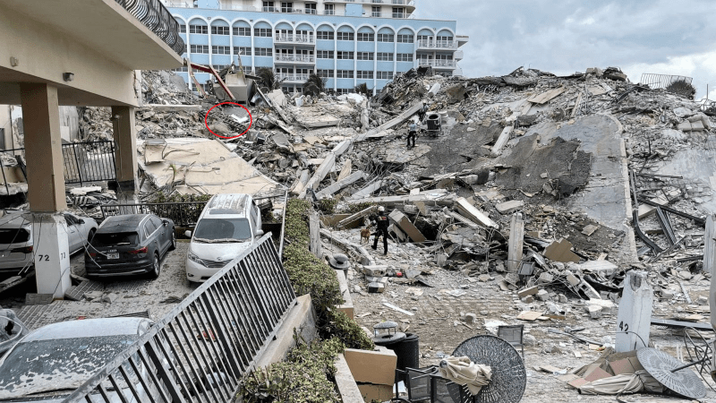

This high resolution photograph of the collapsed parking deck shows a ladder that provided access to the elevator machine room. The ladder's position is shown with a red line on the debris field overlay above. The ladder was near gridline 9.1 and ended up near gridline 4, a northward shift of about 44 feet. The ladder is an indicator of just how far north section 2 fell.
Honest question because I don't know anything about major collapses like this, but is debris (location, height, etc.) really that useful for failure analysis? Referencing an individual item like a ladder seems like a stretch to me, I mean things fall weird. I could see a general debris plan like you copied above being relevant, but I'm curious to learn how useful it may actually be.
The ladder is just an indicator. The 4.2 million pounds of debris (4,200 kips) that didn't fall into its footprint is what needs to be explained. It shows how the building fell, which, in turn, can provide a clue as to which columns collapsed first. The main point is that, if KLM9.1 had collapsed first, I think the debris from section 2 would have fallen to the south and NOT to the north.

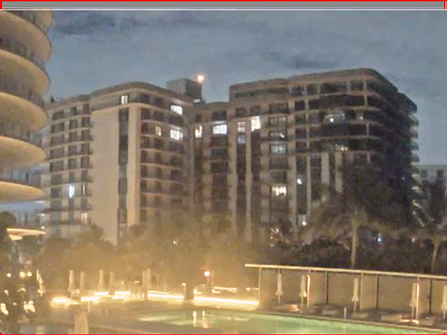

In part 17 on 12 Jun 22 at 17:15, you posted a gif using a slide from NIST, if I understood that correctly. Looking at that gif, it looks like the building is falling away by comparing the parapet of the penthouse with the facade of the eastern portion. You can also look at the machine room above the elevators. The eastern portion twist from right to left, as if section 2 is falling away from the camera. Maybe it's just an artifact, but it is intriguing. The ladder and the debris pile don't show section 2 falling straight down. Look at the blue lines you marked on the gif.
The camera is very far away and at a bad angle, as it would be easier to tell if viewed from the side. It's hard to tell from a distance whether something is falling a little towards you or a little away from you, but the gif you made is intriguing. It's one of the things that got me thinking.
