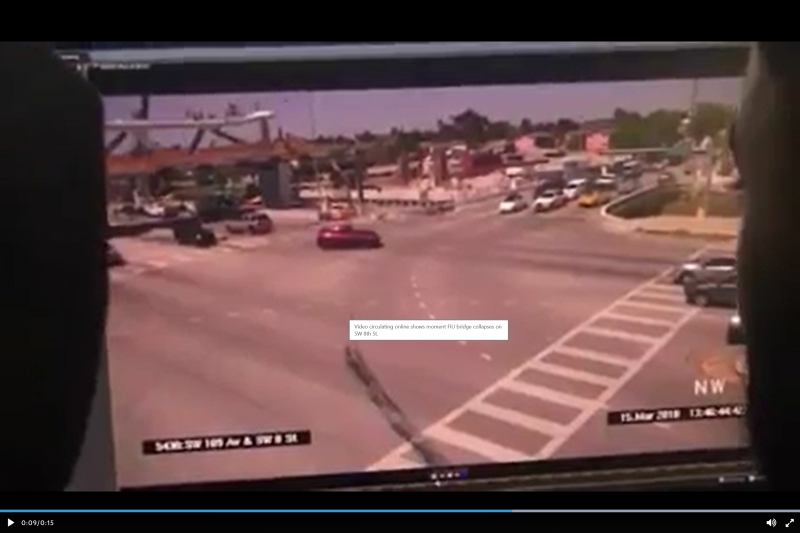

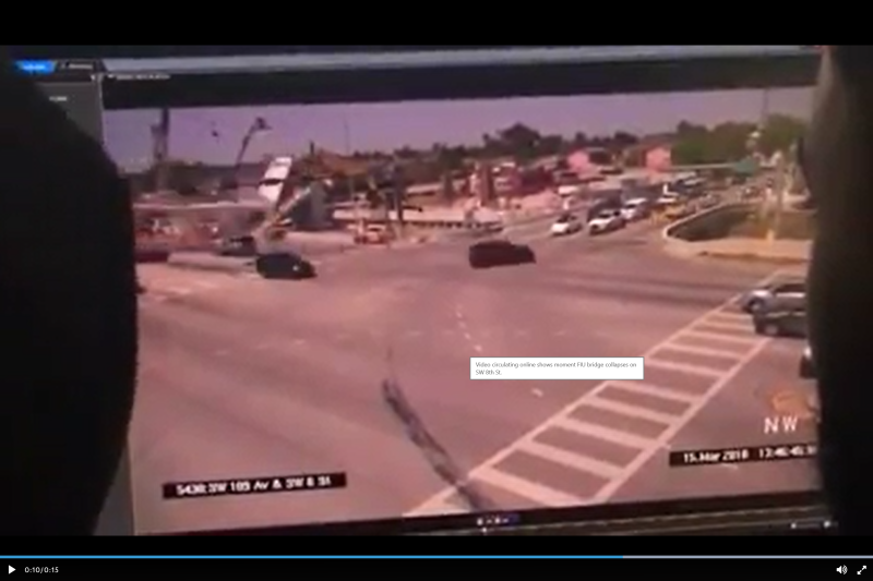

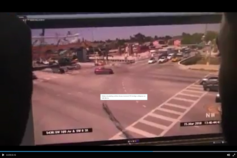

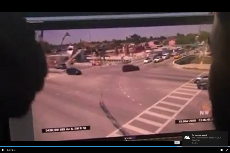

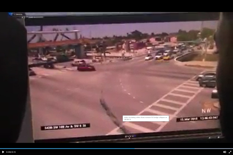

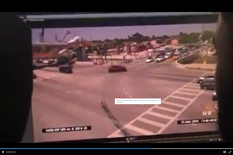

Break down of video:
Frame Prior to Collapse:
Not sure if it is the video or if the first diagonal is buckled and maybe the section of top chord between the first diagonal and end of the bridge:
First diagonal appears buckled and the bottom chord has collapsed:
Following Frames:

RFreund - Saw that yesterday evening as well but later when I looked at it, the video may have played differently. I'm wondering if the work on the canopy was to De-Tension Truss No. 11 on the north end. They may have been there for more than one purpose.
The original proposal had both sets of the Self-Propelled Modular Transporters spaced apart. Starting on the south end (FIU) the first rig was planned to be positioned directly under the south end of the span & the next rig 24 ft to the north. At the opposite end, north (Sweetwater)/Pylon, one rig was again to be positioned directly under the north end of the bridge with the final rig 27 ft to it's south. As it turned out this plan was too wide for the road way and they may have encountered a hiccup with uniformly supporting the bridge when driven over the center divider. It looks like they still had trouble driving over the center divider, even with the tandem Self-Propelled Modular Transporter arrangement. They stopped half way across and just sat their for a long time. Since the Self-Propelled Modular Transporter was no longer under the ends of the bridge, I wonder if they decided to PT the No. 11 Truss, with the intent to De-Stress the truss once the bridge was in place. It sure seems like it took a lot longer than 6 hours to position the bridge. It looked close to midday when they we finished. Link

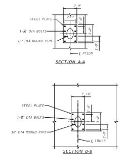

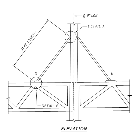

If anybody still thinks this was really supposed to be a cable stayed bridge, you should review the drawings as to how the pipes were to be connected. They were to be bolted to the concrete with end plates. That is not how you connect cable stays.
Lomarandil said:
Hokie66 -- exactly.
And another "exactly" from me too.
16" CHS/tubes with bolt on connections - hardly your high-tech strand stay cables!

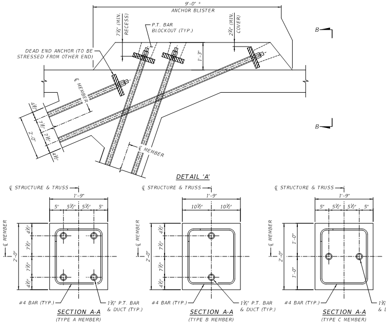

For those that wish to see the "PRELIMINARY 2015 - NOT FOR CONSTRUCTION" details, see the following:

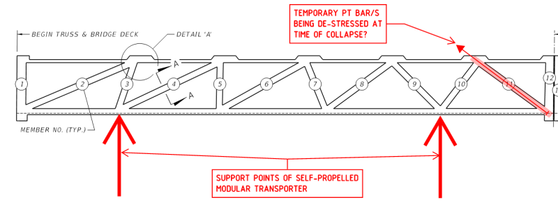

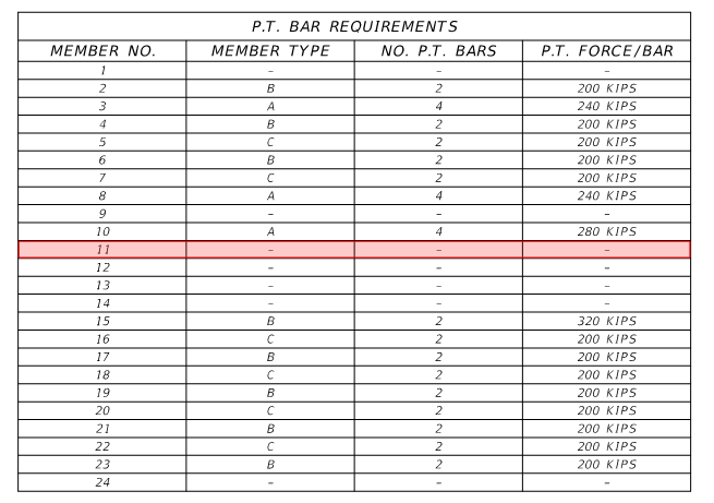

On page 115 of the submittal the PT bar schedule details ZERO PT for compression member #11, which I assume is for the final spanning condition:
I think this is most probable. During transportation/erection there was tension in member #11 so maybe they provided some temporary PT for this condition, and whilst this temporary PT was being de-stressed the collapse occurred. It is in keeping with the location of the stressing ram and de-stressing stool seen in the collapse photos.

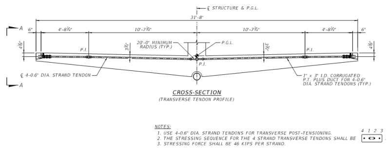

May be a dumb question, but can someone explain why the top flange has any PT strands at all?
If the cable stays are just for show, when would the top flange ever be in tension to require PT?
So the tower and cables (and truss web pattern) is all simply decorative? That's pretty wild.
For during lifting etc? as per diagram immediately above.
Also for bending of the top flange.

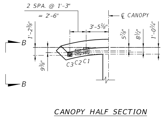

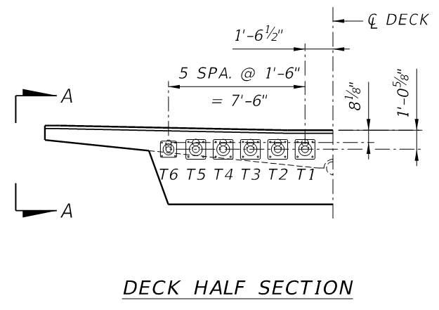

By way of summary of the PT that made up this bridge:
1. Transverse bottom-flange PT: 4x0.6" dia, 7-wire strands, GROUTED tendons @ 2'6" spacing. These tendons were fully stressed, capped and grouted BEFORE transportation.
2. Longitudinal bottom-flange PT: 10 groups of 19x0.6" dia, 7-wire strands, GROUTED tendons typically, except T6 were 12 strand tendons. These tendons were fully stressed, capped and grouted BEFORE transportation.
3. Longitudinal top-flange (canopy) PT: 4 groups of 12x0.6" dia, 7-wire strands, GROUTED tendons typically, except C3 were 7 strand tendons, GROUTED. These tendons were fully stressed, capped and grouted BEFORE transportation.
4. Truss diagonal member axial PT: 1-3/4" PT bar (probably Grade 150 ksi), probably full-threaded. I would expect that the majority of these PT bars would have been stressed, capped and grouted BEFORE transportation EXCEPT for the temporary PT in the end diagonals.
The so-called media reports of "loose cables" having to be re-tensioned is highly suspect. All the photos that I have reviewed of the collapsed bridge show black-colored grouted end-caps (at the ends of the bottom and top flanges), and none that I have found to show any with 'stressing tails' exiting the ends, EXCEPT for the PT bar being de-stressed to diagonal member #11.
Ingenuity,
I don't interpret that as zero PT in #11, but rather as "ditto", so 280 kips.
I find all those numbers to be incongruous. Member #1 will have more force than Member #11 once the truss is erected, as it is not as steep.

It looks like zero to me. Same symbol as #1.

If that was true then how much PT was to be applied to Member #1 - the first scheduled member and with a "-" for all PT data?

Member #1 is the end-vertical - I think you mean Member #2 - the opposite-end, first diagonal, that is flatter than #11. However, Member #2 [in the final 'faux' stay-cable configuration] is in direct line-of-action of the last stay cable [so may see some tension under some load cases ?] - whilst #11 is always in compression in the final configuration.

This makes some sense as to the buckling of the concrete strut - the rods in the preliminary plans are off-center. If one fails and the other is still under tension there is a moment introduced into the member.

Per the original plan - there was no PT to be applied to #11. Not only is the tension "-", there is no member type (A, B, or C) specified to tell where the tensioners are to be placed in the member.
