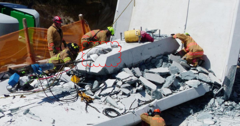

So there were two bars in #11? Not a central bar?
Correct, as per the attached photo:
It seems clear that the bottom chord was not attached to the pier, so it relied on attachment to the end diagonal and would have a tension equal to the horizontal component of the end diagonal (#11) excluding any prestressing force. The collapse is consistent with the bottom chord pulling away from Member #11.
BA

BAretired said:
If a member is prestressed, applying external compression will relieve some of the prestress (because of the change in strain) but not all of it. If a member is compressed by externally applied load and then it is prestressed, the two effects will be additive.
Is this not the likely culprit?
I know it's too soon to know, but:
[ul]
[li]Say #11 was prestressed to resist the tension caused by the temporary transport load (the end of the truss was basically being hung by #11). No numbers here -- just call that Tension Force A.[/li]
[li]The bridge gets placed on the abutment. Load reversal city as the temporary supports get pulled away.[/li]
[li]Now say #11 is carrying 50% of the bridge self-weight in compression. And, at that steep angle. Call this Compressive Load B. [/li]
[li]Compressive Load B >> Tension Load A. [/li]
[/ul]
Wouldn't those PT rods go "slack" in that case?
If so, wouldn't re-tightening them result in Compressive Load B + Tension Load A to occur at that node?
That'd far exceed any other conceivable design load demand there, right?
No, because the rods are far more highly strained (i.e. stretched) than the amount the column shortens under the self weight loading. PT rods/strands stretch a lot.
You'd include all the loads in the design.
This seems somewhat plausible. It is a rookie mistake all round but entirely plausible.

The relatively small amount of load that would have been applied by the stressing of one prestress bar in a diagonal should not be sufficient to cause the collapse if the overall design was ok. With normal factors of safety etc, the amount of force we are talking about compared to the overstrength required to be built into the design is insignificant.
There has to be some other cause.
