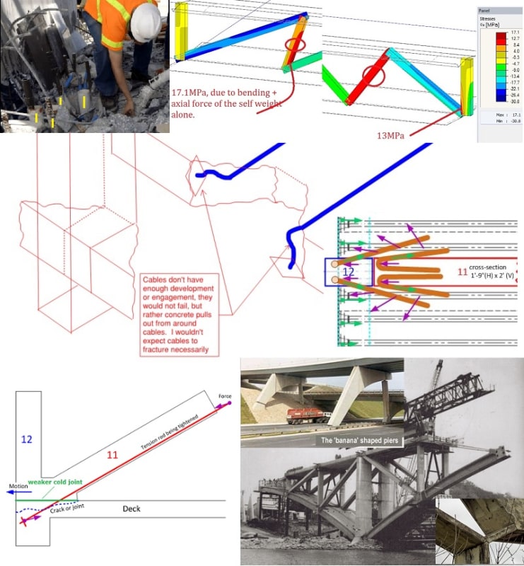

What's missing in the Toomas analysis are loads - I didn't ask him what numbers he used (he'd asked if I had centerlines at one point, but he soon sent the analysis), but may get back to him after I triple check mine (using new specs).

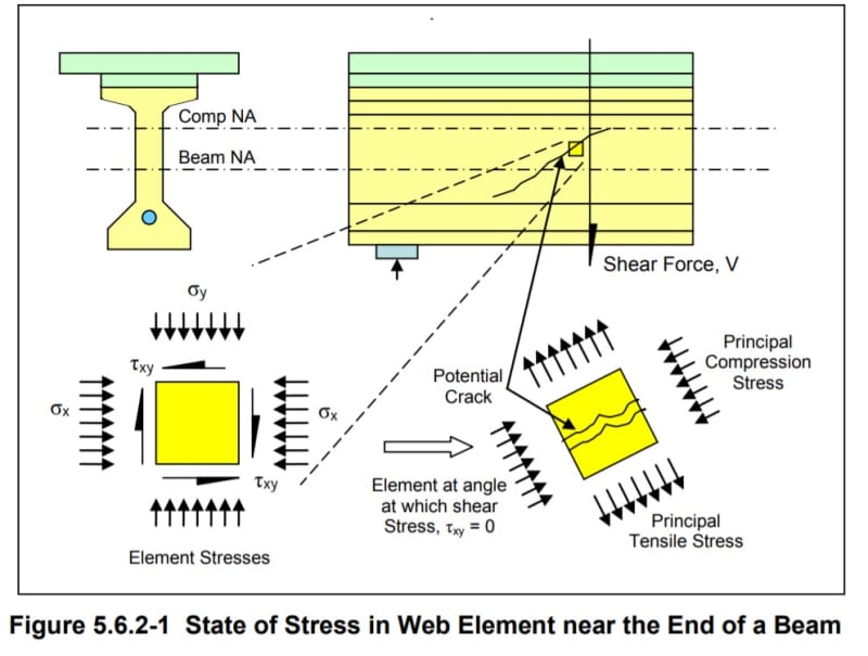

My question is why the stress is much different for #1/#2 and #11/#12 - is from asymmetric truss pattern, because #12 hangs off the deck, both, or ???. But he'd said 2D analysis wouldn't show this, and he's right - #1/#2 diag force shows ~40% higher than #11/#12 (they beefed up #1/2 but not #11/12). In final configuration, #1/2 would be floating on bearing pads (for expansion), while the pylon ends of main/backspans would be fixed, with some strengthening by being tied together and help from stabilizing pipes (but not as much as if this was a true suspension bridge).

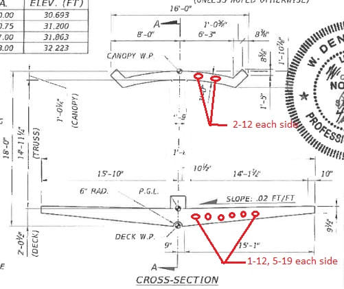

Would be good to analyze the strength of the #11/#12/deck connection (is simpler) - even within 10%. Estimated diagonal force is ~1350-1500 kips plus 560 kips PT tension (totals ~1400 kips horizontal) - the rebar is in the specs. This area has weak boundaries with the ~3" PVC pipes (two on each side of #12), rebar/other rods (which strengthens concrete, but would seem to create a "parallel sheer plane?", e.g. if many spaced 2" apart parallel to sheer force), and the ~8"/large drain pipe at the bottom through the diaphragm - plus the cold joint itself, which photos show had cracked. The #4 photo showed another hole near #11 in deck (that was later filled?).
Someone asked what may have happened to the rebar cage under #11/12. That's a good question (in the canal?) because the concrete was pulverized at the base of #11/#12 members, but may have held within the "cage". A chunk is missing from deck (seen in photo), but deck held the lower #11 PT rod. Photo shows the deck concrete broke apart at the east side of vertical PVC pipes as #11/#12 sheered.
