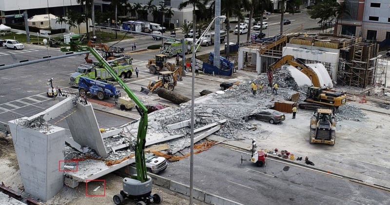

Bearing shims. (uncropped photo, circled in red) Note one is broken and the other one ended up on deck.

I don't have enough information, but, it may be that the loading from the web diagonals was not properly distributed into the deck... waiting for info... I'll then be able to see what failed catastrophically. The cracking observed may be related to the collapse.
