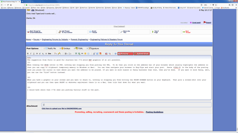

dik: "I converted the pdf to a png hoping to just paste the image into the reply"
I've used this pdf to bmp converter for years
Converted your doc, opened .bmp w/MS Paint (~6000x5000 pixels, 98MB), saved it as .jpg (after resizing to ~600x500 =>160KB) and it pasted quick/ok in reply (did not post, but used "preview" to chk)

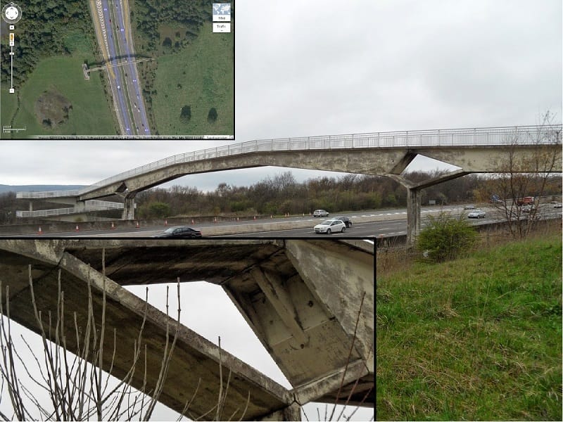

Wanted to learn about concrete hinges and found this.
It doesn't look very strong, but gets inspections "regularly". 158' long over 6 lanes of busy highway, out in the middle of nowhere (with a road overpass ~1200' south). Built in the 1960s, it was "designed as concrete Wichert trusses, possibly the first such designs in concrete". This design was used as it's in a mining area where foundation settlement is probable.
Comments are interesting, esp this:
"the average engineers nowadays use suites of computer programs that “do everything” for them without the need to understand what is actually going on inside the concrete, or how to use Mohr’s circle". There may be be other issues, but it will be interesting if we learn how much attention was given to the 11/12/deck connection.

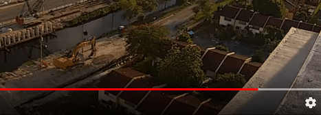

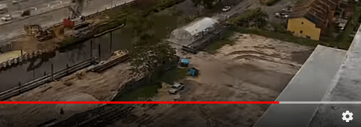

Yesterday there was discussion of establishing a timeline. I don't know if this video has been posted but it shows the percentage of completion up to Dec, 17 2017. Stars are on offer to anyone who can explain the need for the transparent quonset hut in the last third of the video. It just looks like a big waste of money. Link

Dik,
The suggestion from Chris is good for starters but I'd avoid BMP graphics if at all possible.
(1)
When viewing the NTSB letter in PDF, nothing was stopping you from posting the URL. To do that you click on the address bar of your browser which usually highlights the address so that you can copy to clipboard (temporary memory in Windows or Mac). You can then navigate your browser to Eng-Tips and start your post. Paste (CTRL-V) in the body of the posting once you place the cursor in text where you want the address to be placed. If you want no more nuance or fancy business than that, then you're done. If you want it more fancy, well, you can use the "Link" button instead.
(2)
When you have a graphic on your screen and you want to share it, nothing is stopping you from hitting the PRINT-SCREEN button on your keyboard. That puts a screen-shot into your clipboard and you can then open PAINT or whatever equivalent there is on a Mac, then trim that down to only what you want.
(3)
I would have sworn that I've seen you posting various stuff in the past, and assumed you knew already.
Now that I've said my piece, be warned that there are on-line file conversion websites that offer lots of convenience, but in the background the server is keeping a copy. Word-search algorithms and humans can "review the contents" at will. I recommend you keep your work on your own computer, rather than in miscellaneous single-purpose downloads.

epoxybot - I've looked at the video several time and see no Quonset hut. Any hint on where in the video it is?
The green house is in the lower right just north (edit: toward the viewer) of the canal:
(link will start at the correct time to see the greenhouse)

Thanks - the original video pops up a "next video" over that area for me. I need to find a way to shut those off; it's irritating; a number of videos are not quite over when those block the view.

I'd say the hut is for whatever project involved removing the houses.

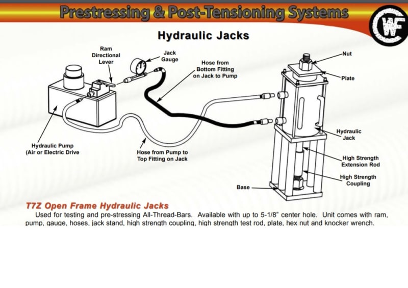

Epoxybot, thank you for your great post. Do you have any information on how the ram works for PT bars? I know how they work for cables, but not solid bars. Is the plate and nut shown part of the bridge? Is the long tube a trumpet or part of the jack?

I think this image answers my own question about jack.
The one used on the Miami project was similar to the graphic you posted above (from Williams Form), except it was an enclosed-type (similar to the photo below), where the offset plate at the base of the jack has an internal racket/chain wrench and socket that enables the PT bar nut of the STRUCTURE to the secured/loosened. There is usually a short pull-bar and coupler within the jack/trumpet length to 'grip' the assembly. The nut/washer/bearing plate assembly at the top of the jack is to transfer load between the jack and the STRUCTURE bearing plate/s. Sometimes a load cell is placed at the top of the jack assembly to cross-check gauge pressure/force to an independent reference.
