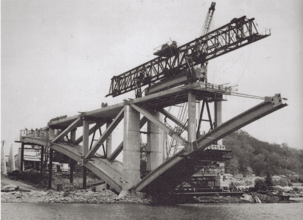

Jaun Brown made a comment about tensioning the web members would affect the camber; I'm not familiar with concrete trusses that are post-tensioned. Is this correct? I would have thought that it would have minimal effect.

If you look at it as a beam, the horizontal component of force of the PT in the web would create a couple about the c.g. of the cross-section. This in turn would generate a moment and impact camber.

You are correct, most of those bridges linked by dik are steel. There is one concrete footbridge in Austria, trusses each side, which is interesting architecturally. And there is one now abandoned footbridge in California, which is really an arch bridge. Concrete trusses are rare, for good reasons.
...post-tensioned truss bridge from Australia that I previously posted in Miami Bridge Collapse Part III (or maybe IV) - The Rip Bridge, north of Sydney:
Cantilever of 240' each side of the Rip crossing, that supports a 120' drop-in central-span. Constructed in the late [EDIT] mid 1970's.
