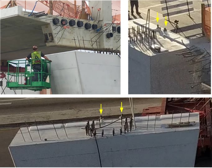

And finally, if the shims at the pier are not directly undet members 11 and 12, OOOOPS!!! The transfer of vertical force at that node it is done thru vertical face shear friction and strut-and tie which potentially creates a horizontal force in the diaphragm (in the plane of the diaphragm) to mess up more the force situation at the node 11-12-deck-diaphragm.

The Mad Spainard said:
FIU Bridge north landing shims (repeat post from another user):

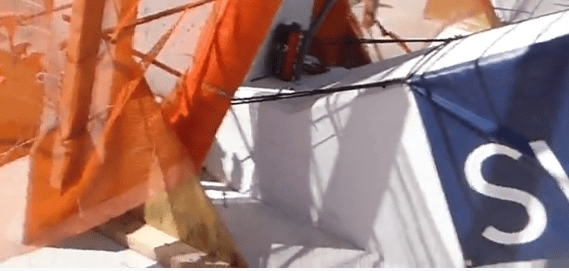

jrs87 said:
I'm curious if PT rods for 11 and 2 were stressed while span was suspended like this.
These videos are dated 9 Mar 18 (heading at top of page) - if accurate, the span was moved the next day but someone had already seen these larger cracks. I looked at all (nice hi-res) videos - #561 gets close to bottom of #11... starts a little above the crack, pans down the span, then comes back lower, and ends just before it might show the crack.
All reports have said the cracks were noticed after the span was moved so it's odd if the photos were taken before. #11 had already moved back almost 1/16", and I'd think cracks would get worse after moving the span (jostling as it traveled, set in place, etc).

FWIW, this is the very end (22/23) of #560 showing the base of #11 before the move. The progress bar hides part of the joint area for several seconds after pausing the video. I couldn't step the video frame-by-frame, so there may be more to see.
