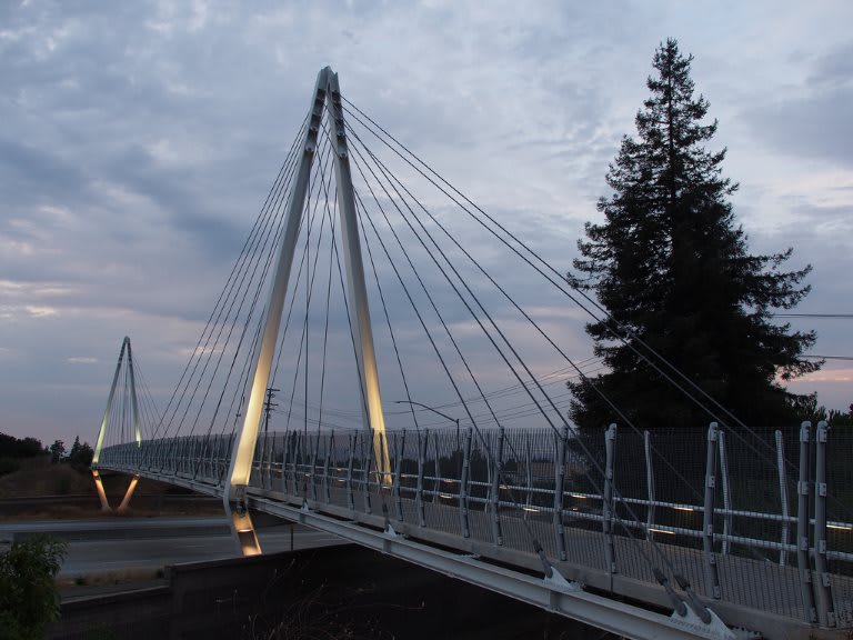

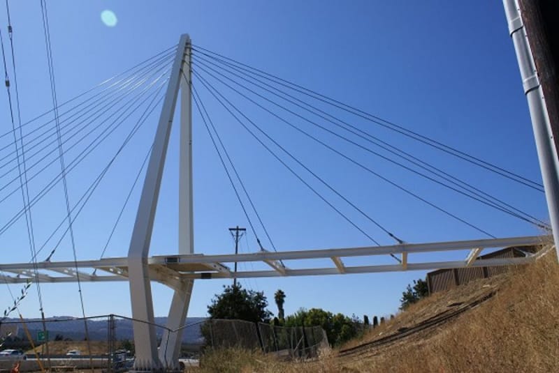

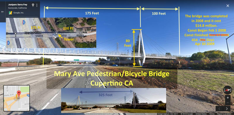

I posted this bridge in Part IV but I'm re-posting it because it demonstrates that the above premise is not valid.
Time Lapse Video: Link
The Mary Ave. (Don Burnett Bicycle-Pedestrian Bridge) is built to withstand SF Bay Area earthquakes. As the photo demonstrates they could have built HALF of this bridge and probably have had plenty of money to dress it up & make it the deck wider, while still employing a method of ABC. This bridge would have needed support briefly. The extra unused lane on the Tamiami Trail/Hwy 41 would have served nicely.
Yes, there are plenty of cable stayed pedestrian bridges built while the roadway below is in use.
And the bridge in Cupertino CA is structurally honest, and IMHO better looking than the Miami bridge was going to be.
I wonder about the difficulties of anchorage to support the asymmetrical weight of a pure cable-stayed bridge and the concentration of the weight on the one central pier that would happen, given the close proximity to the canal. It's also about 12 feet wide, or about 1/3 the width of the FIU bridge and likely a lot more elastic/jouncing making for a less desirable hangout spot.
