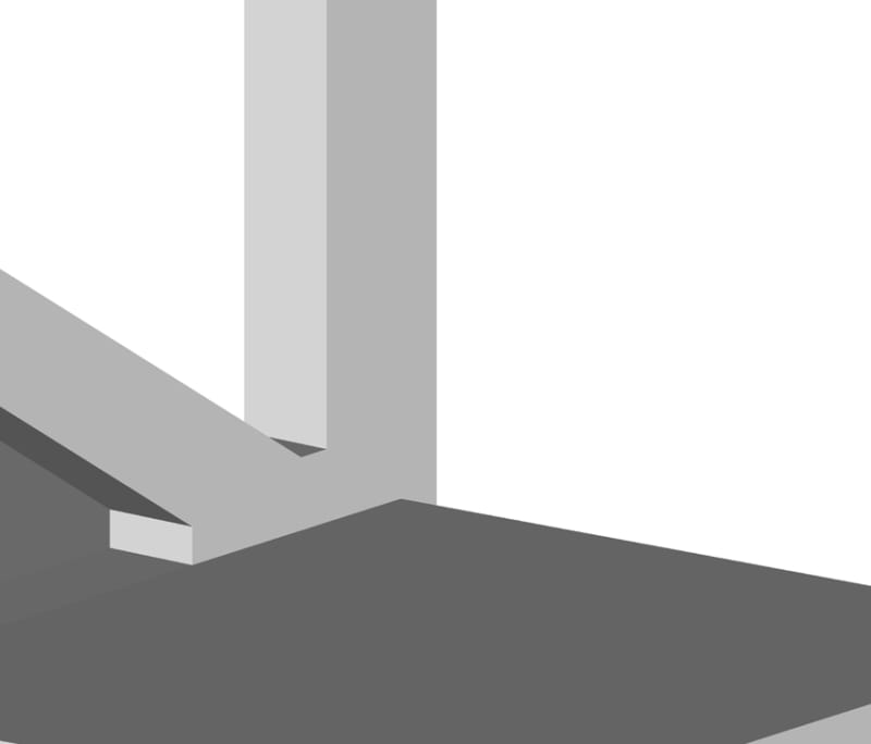

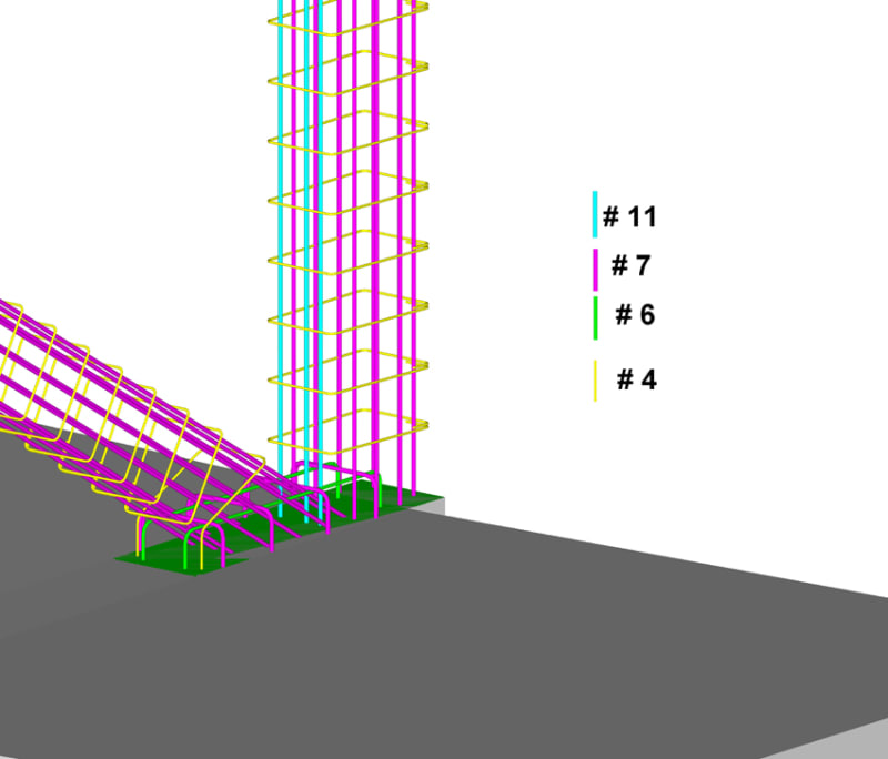

According to the plans that are available, is this all the steel that crosses the joint?
[URL unfurl="true"]https://res.cloudinary.com/engineering-com/image/upload/v1531928546/tips/BridgeII11_ifk6xc.bmp[/url]

I'm most curious if there are any calculations for connections. All are about the same.
Trust me, it is worthy to get the cals. They are in PDF and about 2000 pages. As they are the calcs for the signed and sealed drawings, they contain calcs about the connections.
