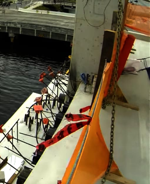

I was checking out the on-board video of the move to see if there was any indication of the deck cracking at that stage. Although it is possible, I've decided it's more likely just twine.
As I have always stated, #11 was not capable of shearing #12.
The latest releases prove that by showing it was structurally "unsound".
It appears to exhibit and exterior /outward force from internal to the member; this could be a result of reinforced "rebar" buckling once load was applied to it.

So, some time after the onboard video recording Linkhttps://www.eng-tips.com/postedit.cfm?id=8378200&action=edit
and before the March 13-14 photos, the fractures, represented as cracks, opened up far beyond those photographed February in the casting location post shoring removal. I wonder if it was a slow propagation or if they suddenly appeared after the PT rod tension was released from #11. The video shows the structure functioning as intended aboard the abutments without sudden failure. I hope more pictures emerge of the failure zone. Very interesting stuff. #11s force cone blowing out the deck and elongating the closest PT strand bundles indicate the failure wasn't as sudden as first thought and progressed over several DAYS!. The failure of the bridge pales in comparison to the glaring human failure. No one who saw the fractures warning of imminent catastrophic failure had the balls to speak up.
I am impressed by the composite concete/steel's lack of sudden failure as mentioned earlier in this thread as one of the material's properties. The span screamed out it's intent for days and no one heeded the call. I'd guess the tradesmen ironworkers, concrete men and operators saw and spoke out the obvious. Cant wait for the final report.

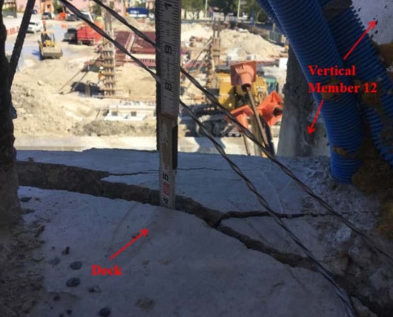

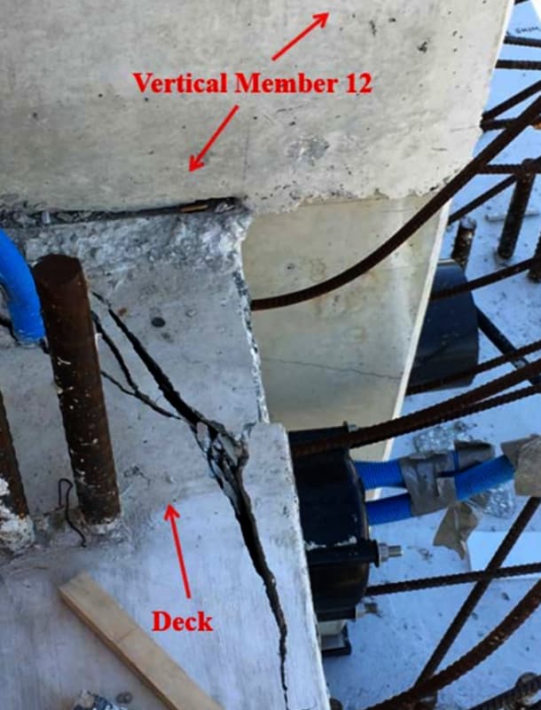

If you go to the following Miami Herald web page photos of many large cracks not revealed before can be seen. These photos were apparently taken on March 13 or March 14 at least one day before the collapse. This if true would indicate that the work on the day of the collapse did not cause the failure. These are the same photos shown in the second interim NTSB report.
Any engineer looking at these cracks could only conclude that the bridge had basically already failed as far as meeting its intended purpose and needed to be closed until a shoring and remediation or demolition plan could be made. The fact that the bridge was not closed in my opinion amounts to negligence, probably to the point of being criminal. Very sad but what else can I say.
The large cracks also appear to show movement of 11 and 12 together, splitting of member 11 probably due to inadequate confinement and shear styrrups at the deck and rotation of 11 and 12 together clockwise looking towards the canal and 11 rotating away from the deck towards the canal. It appears to me that 11 also appears to have moved along the deck face as 11 and 12 moved.
I only see the cracks shown in the NTSB preliminary report, nothing new.
However, that article does answer a few of my questions about the FDOT oversight where it appears they were not made aware of the extent of the cracking or even that it cracked at all. I wonder whether they had an on-site inspector but it sounds like they did not. If this is the case then they may be free from liability. I certainly hope so, any engineer who saw those cracks is going to be in the line of fire.

By definition in ultimate design member 11 and 12 had reached technical failure in strain long before the photos of the 13th were taken; the bridge should have been closed and shored until its final fate was decided. In my opinion 11 was overstressed due to axial load and bi-axial bending along with torsion under dead load alone with no applied live (including torsional load imbalance on the bridge) and wind loads. Torsional stability requirements placed significant lateral and torsional load requirements on 11 and joint rigidity placed biaxial moments on 11 and 12.
The only consolation here is that this was probably a more gradual failure than it appeared to be but nobody was listening to the bridge crying out and lives were lost.

I don't know if the following has been raised in the discussion yet (there is too much to review) but the use of PT rods in #11 to carry the end of the structure during the move seems to have been too clever by half and may have ultimately led to the disaster (if nothing else, they became a distraction). Use of external strong backs may have been a cosmetic blight on a heavily promoted project, but the additional compression to the already critical #11 and the poorly understood internal stress dynamics from the various stages of this construction process seem to have added a level of complexity that was not overcome.
As suggested by rebardan, the tension release may have resulted in the fracturing. I am curious to know what happens when you place a concrete column under an extreme and complex load and then suddenly introduce an eccentricity by releasing a compression element on one side or by giving a little tug so that you can back off the nut? If cause and effect were conspicuous but did not result in sudden collapse, I suppose some O[sub]2[/sub] therapy would be permissible as evaluations are made but if these fractures were observed developing over time, would you not come to a not to soon realization that the structure is yielding to gravity and requires immediate intervention (namely shoring)?
I noticed from the time stamp with the images in the Investigative Update that the west side images were taken two hours before the east side images. That's a lot of head scratching. And if I'm not mistaken, that was two days before a two hour meeting on the morning of the catastrophe. I don't wish to make light of a bad situation but rather to shake up the thinking of what was happening with the thinking. This brings me back to my suggestion that the PT rods in #11 were a distraction. Rather than the obvious intervention of shoring up the structure while properly evaluating the damage and conducting remedial work, the focus was on the PT rods. Unfortunately, entropy has a bite and you can't put the genie back in the bottle (See my previous posts).
From Figure #2 in the update, the diagonal crack on #12 below the deck level (and where #12 ultimately failed) indicates that the top of #12 is being pulled toward the centre of the span, perhaps from the structure sagging, though not much, and this too is a clue. Nothing moved much until the end when I believe #11 ruptured under a multitude of funky internal stresses.
