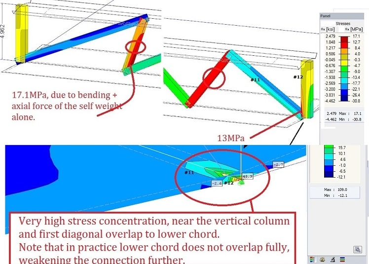

I believe the Toomas Kaljas calculations do not include the post-tension stresses, hence the high tensile stress numbers seen in 10 and 3. They also don't appear to include the pre-loads on the diagonals as a result of the longitudinal post-tensioning on the deck and canopy. I think those loads, carried via shear, were responsible for the cracks seen in some other diagonals spread along their length. I also think the canopy post tensioning was to match the strain in the deck so that the ends of the diagonals moved together, keeping the bridge deck straighter/level.
