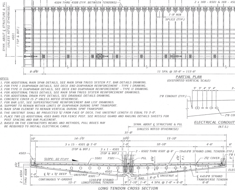

(d) This photo shows the the lower PT rod intercepts the last transverse PT rod, 4’-2.5” from the end, in the design. No transverse PT cold be installed to intercept the upper PT rod due to the obstruction by the longitudinal anchors. Evidently if the Lower PT rod were to be separated from the deck like the upper one it had to rip out the affected transverse PT rod and break up part of the deck but this did not happen.

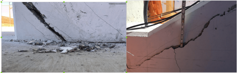

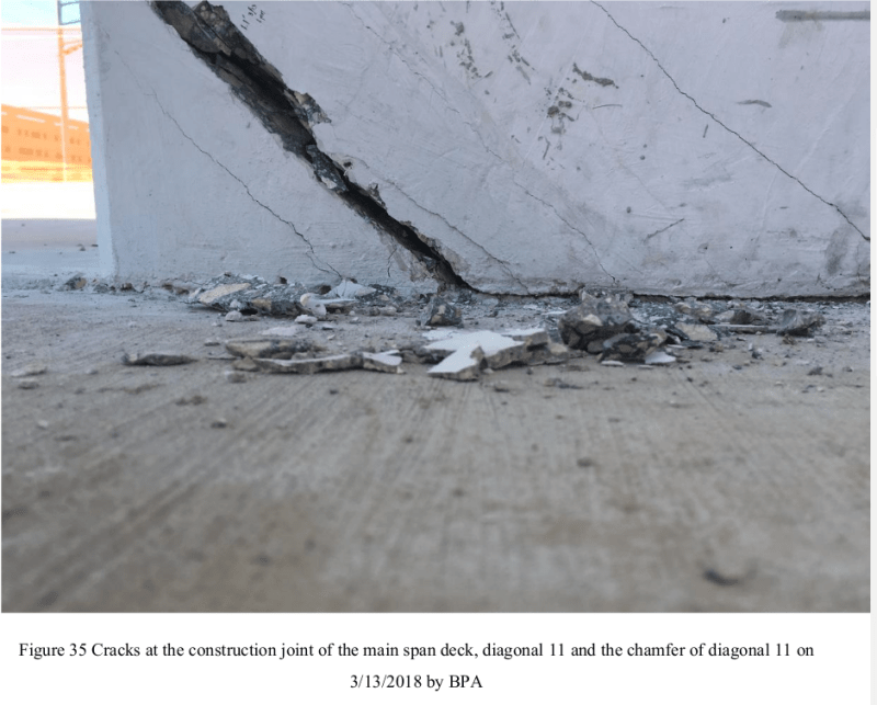

(e) An evidence showing the one PT rods effective on the deck while the other on 11/12 is OSHA report's Fig 35. Along the sloping crack in Member 11 the concrete on one side was still rigid with the deck but the other side was with 11/12 according to the condition of the construction joint.
My interest now is how the two PT rods were de-tensioned. OSHA report does not mention the procedure. It would not be surprising the rod tension was removed in a single operation instead of by stages of 50kips per rod alternately.
If the stress were fully released in one rod while the other was not then there would be a substantial stress differential between the deck and 11/12 due the fact one rod was effectively tied to the deck and the other to 11/12. The stress differential was also exacerbated by the construction joint.
The construction photos and the OSHA report have already confirmed the serious crack damage occurred immediately after the stress in 11 was removed on March 10.
Theoretically the stress release in 11, even in stages of 50kips per rod alternately, could still inflict damage to 11/12 joint with the deck because structurally one rod pulls the deck while the other 11/12 over a plane of weakness created by the construction joint. In stages the damage would be less.
When 11 was re-stressed again on March 15 every application of the staged 50kips to either rod could grind the construction joint if each rod was able to pull it own part of the span. The construction joint (CJ) between 11/12 with the deck looks increasingly likely to play a key role in the demise of the bridge due to the different effectiveness of the two PT rod anchors on either side of the CJ.

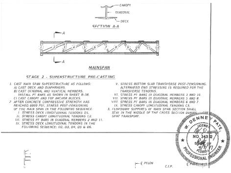

Does this open the door for FIGG to blame MCM for the bad CJ?
FIGG specified the casting of the deck before the "diagonal and vertical members"

SFCharlie (] FIGG specified the casting of the deck before the "diagonal and vertical members"]
So FIGG is good so far. (I can't resist) Unless ABC rules say you must cast it top down.

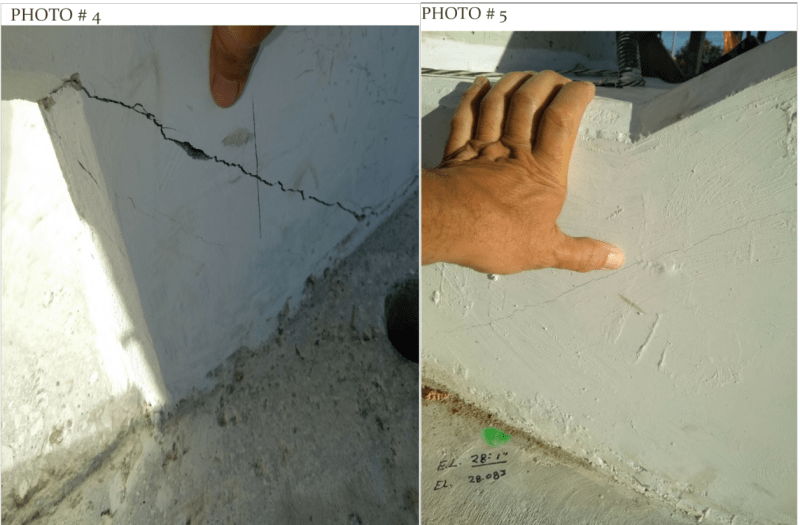

From the CBS timeline six crack photos were reported on Feb 24, 2018 when shoring was removed. There three cracks reported on Member 1 and three on Member 11. Here are the photo 4 and 4 when the span was fully stressed up and supported at the two ends ready for the transfer.
After de-tensioning on Mar 10, 2018 these two cracks grew to the condition below
The latest crack width of Photo 4 was measured 1" in OSHA report Fig 35&40 and the depth of crack of Photo 5 was 6" as Fig 39. I use Photo 4 and 5 because Photo 1,2,3 & 6 do not have later photo to compare.
Therefore we do know the de-tensioning has damaged the bridge and the re-tensioning caused it to collapse.
