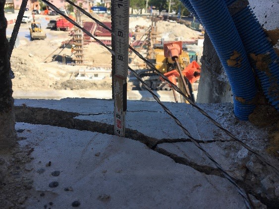

RE: The 2 photos posted.
I had not seen the left photo - am I correct in thinking that is the west side of member 11 and the tape measure is touching the top of the deck?
Both the member 11 in the right photo and the horizontal filler formed between 11 and 12 shown in the left photo are BURSTING. Not a good thing in a compression element, particularly when the stability of a 950 ton structure depends on that single member supporting that compression.
Judging by the exotic crack monitoring technique of an "X" across the crack, it appears the surface is ruptured outward also. Note the offsets visible in the lines. (What was the budget for construction inspection? We appreciate someone marking the "X" - it shows better in a photo than a glued on grid the size of a credit card.)
At the time the left photo was taken the failure was in progress, but the force in 11 was somehow being supported by the portion of the deck which blew out later.
I see the top of the fillet between 11 and 12 is 14", not the 15" called for on the drawings. MCM gets one demerit. It will be interesting to see how much a lawyer can charge to that variation.
Yes, it is the west side of #11, but the tape measure is penetrating the deck by about an inch. ( see the inset at the top right in that left photo.)

The photo is from Fig 42 of OSHA report which also shows crack depth of 6" to 7" by Fig 39. The deck itself has crack depth of 3" and 4" according to Fig 31 and 30 too. The entire construction joint between 11/12 and the deck had slid.
Presumably the cracks were full depth? The diagonal cracks on the top surface are the same failure surface as the cracks on the back side of diaphragm II?
Because the cracks are jagged and change direction the straight tape measure only go so far in.

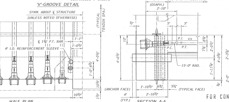

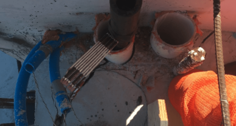

Fig 29 of OSHA, enlarged below, is probably the most significant on the fate of 11/12 joint.
The centre line of north south 4" ID sleeve is only 5.25" from the north south face of the 2' wide Diaphragm II but has a 1" deep crack according to OSHA Fig 42. After passing the south north sleeve the deck had totally sheared off by about 5 to 10mm (say 5mm on either side of south north sleeve). Concrete has little area and hence little resistance/bond between the two sleeves.
Thus on Mar 13 the evidence in the field indicated 11/12 was departing from the deck with 5 to 10mm outward deflection and crack depths of 1", 3" and 4". The cracks traveled possible 45 degree downward and eventually took out a large prism of the south North face of the Diaphragm II as indicated by OSHA Fig 62. The shape of the prism was already visible by Fig 25 and 27 before the collapse.
The failure mode was as predicted by FDOT engineer Andres who marked up a drawing on Sep 15 2016 when FIGG was still developing the design. Despite FDOT's alert given 18 months in advance FIGG only managed to arrange the diagonal crack shorter by diverting it to the 11/12 face with the use of two pipe sleeves.

saikee119 (Structural)25 Jun 19 00:43 said:
The centre line of north 4" ID sleeve is only 5.25" from the north face of the 2' wide Diaphragm II
I comment here only for the sake of clarity, not to be critical. Your posts contain much pertinent information and are helpful.
I think your reference to north face and north pipe sleeve is influenced by the OSHA report which was misleading. I suspect their orientation was influenced by the position of the deck segment in their yard and not as it existed on the construction site.
OSHA has their north and south reversed as it applies to deck segment at 11/12.

OSHA did not make the mistake. I made the mistake. Thanks for pointing out. I now had the north and south directions corrected in the post.

I agree OSHA Fig 30 shows the worst condition for the cracks. To me Fig 29 is more important because on its own I know the west side has gone and amount of movement can be estimated by the gaps around the north sleeve.
The bridge can have a small non-structural part broken off and still would not compromise the bridge's integrity. So Fig 30 on its own is not decisive until people notice the same pattern was being repeated on the east side with the same ferocity. Once 11/12 had serious 45 degree cracks on both sides the next concern is how much this most critical joint had moved.
OSHA Fig 30 is same as NTSB Fig 1. NTSB Fig 2 is also same as OSHA Fig 26 but taken at a different angle. The NTSB information, except Fig 3 which was used by OSHA as Fig 39, did not show how much 11/12 had moved. OSHA Fig 29 is the corroborating evidence on the 11/12 deflection movement. NTSB Fig 3 or OSHA Fig 35 is the confirmation 11/12 was separating from the deck at front or the last remaining side.
