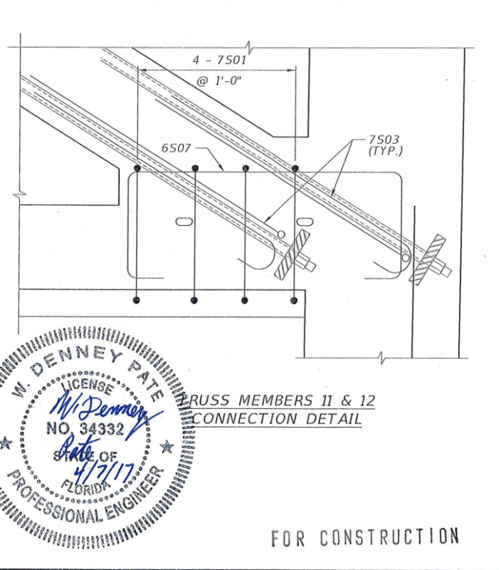

For the first time I have discovered what has bothering me about the detailing of node 11/12 and deck, as shown in your referenced post. At least two things, there are more remaining.
First, the 4 - #7 hoops designated "7S01". The bottom cross leg of those hoops is shown to pass through the formed channel for the drain pipe below the deck. Am I not correct in thinking these are closed ties? This would have been sorted out during the placing of reinforcing, I am sure. Regarding same 7S01 hoops, the one in the fillet between 11 and the deck explains why that small fillet stuck to the deck in the early cracking of this joint. The fillet was anchored by the southmost hoop.
I admit it is hard to tell from the cropped drawing , but the drainpipe is outside the bottom of the deck in a channel.

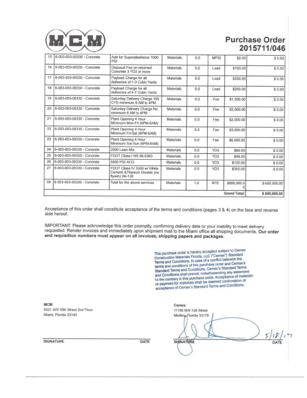

For the record, Structural Technologies, a subsidiary of Structural Group was the subcontractor responsible for all the formwork, reinforcement & place & finish. VSL, a subsidiary of Structural Group was the PT subcontractor. MCM seems to have been mostly construction management.
I've been exploring the TiO2 issue with respect to the pristine rebar. Even the corrugated PT sleeves came away without even tiny scabs of concrete attached. There doesn't appear to be research regarding the bond strength of TiO2 modified concrete to rebar. There is a lot of positive research about nano-TiO2 and a resulting increase in strength. This seems to be the case with many "nano" constituents. Wonder of wonders, filling in the empty spaces between the sand, cement & aggregate makes concrete more solid.
The "Environmental" hype about TiO2 and NO2 conversion to an NO dust & subsequent "self-cleaning" has me wondering about how TiO2 may be modifying the surface energy of concrete. Epoxies have a surface energy of 35 to 45 dynes/cm. Based on the information I can find, TiO2 has about the same surface energy as epoxies. The thing about surface modification is that sometimes it doesn't take much of an ingredient to completely change the performance of a mixture. Epoxy coated rebar require greater development length. Maybe there needs to be some research done to determine if the addition of TiO2 isn't affecting rebar strength development.
Thank you - that detail shows 7S01 is an open bottom with legs turned out and clears the drain channel. All is good.
A diamond is pretty solid - and shatters easily. I wonder if the introduction of TiO2 is reducing the ability of the concrete to accommodate strains?
A new industry on the future - using TiO2 to clean used rebar. All the visible rebar appears to be a lot cleaner than I expected. No adhesion?
Did the TiO2 affect or totally defeat "cohesion " in the cold joint? Seems possible as a side effect or unintended consequence, considering it reacts with things that contact it and paints itself white (grows a white coating). Should cohesion be a no-no if TiO2 is used? Development lengths increased as you suggest?
I have mentioned before how brittle the concrete seems to appear. What is the elasticity?
This may bring a rich chemical company into the nest of defendants.
"Surface Energy" - I have encountered that term. Perhaps you could provide an explanation of how it works and might apply in this case?

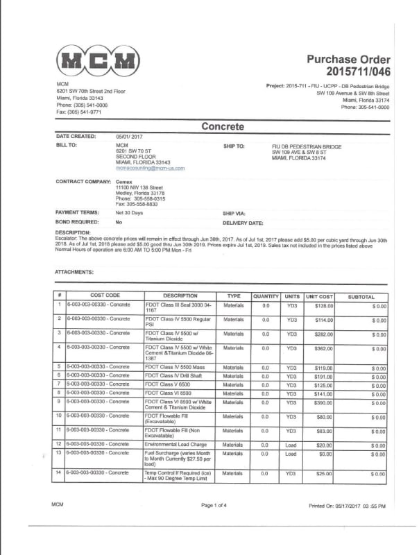

epoxybot (Structural) 25 Jun 19 20:04 said:
I've been exploring the TiO2 issue ...
Is it clear if "plain" Ti02 was used, or NT (nanotitanium)? Here's some info on both on pages 34-35 of this research paper (end page dated 2017):
To be effective, the nanotitanium needs to be at the ‘interface’ of the concrete, i.e. at the point where it can react with sunlight and organic debris (which then breaks down to CO2 and water). For this reason, and also to reduce cost, it is more usefully added as a surface coating or thin slurry rather than being mixed into construction concrete.
It also says
Titanium dioxide is also photocatalytic in its non-nano form which is considerably cheaper than nanotitanium, and potentially less toxic. This may explain why the use of nanotitanium in concrete is currently extremely limited.
In either case, it appears there is no practical reason to incorporate Ti02 or NT into the concrete-rebar interfaces, so is it known if the TiO2/NT was used merely as a topcoat? I remember several comments about a "white slurry".
ADD: If it's expensive and used primarily as a topcoat, that would explain why there's no literature about its effect on rebar, etc.
Titanium additive -
A surface treatment makes sense. Did they paint the diagonals white or is that a Titanium coating that has (had) already reacted? Is it to be sprayed on or surface applied to the bottom of the canopy and deck?
The diagonals look like they received a parging of additional TiO2 surface coating but integral TiO2 was called for in the design.

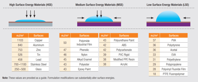

Surface energy is probably best understood by the contact angle of water on a given surface. Water being a liquid with a very high surface tension @ 72 dyne/cm.
epoxybot (Structural) 25 Jun 19 21:12 - So adding Titanium to the concrete mix increases the cost by a factor of 2.5 to 3.2, yet it has no known benefit. Hmmm.... And there also doesn't appear to be any literature explaining how concrete properties are affected by its addition. (...cricket noises...)
EDIT: I'm referring to my post of 25 Jun 19 20:48 which explains that TiO2 only has useful properties when it's used as a surface coating.
