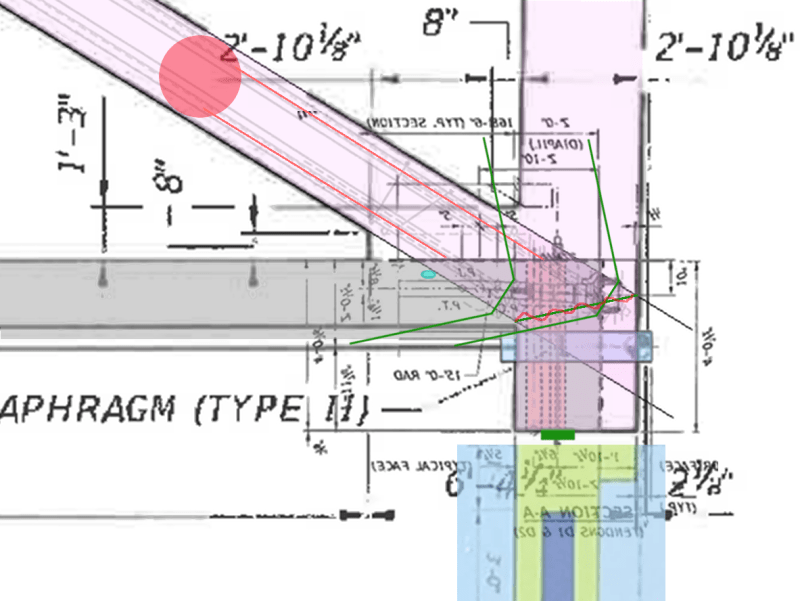

I'll throw in this mark up for thought. The 11 lower PT cable had the transverse deck PT cable to pull against (cyan). I think the node is more apt to be described as the 11/deck/diaphragm node. 11 had various longitudinal cracks and a number of longitudinal rebar had seemingly little deformation.

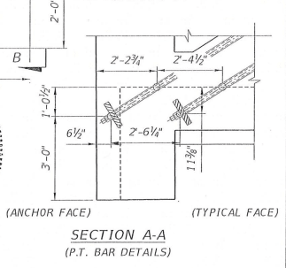

I think the 2 vertical plastic sleeves on each side of 12 have played a significant role in the demise of the 11/12 joint.
In Sym P. le (Mechanical) 26 Jun 19 01:22 sketch it can be seen the two vertical sleeves occupy about half the area the deck bonding with the Member 12. We now know the front and the rear of these sleeves have cracked through on both east and west of Member 12. Thus the deck was likely to have debonded from the two vertical sides with Member 12 after the tension in Member 11 had been released. The upper PT rod was therefore unable to distribute the stress into the deck and became more effective in compressing Member 12.
Lower PT rod on the other hand was able to anchor more effective into the deck as it is wholly inside the deck and close to the transverse PT tendons. Since the deck was likely to have debonded from Member 12 and so the lower PT tension would not be effectively felt by Member 12.
The above sketch shows if the deck were not monolithic with 11/12 then the upper PT rod will not be effective on the deck as it is nearly outside the deck area.
The photos after Mar 13 have confirmed serious movement in the construction joint and so the the two haves of either of the CJ would have been debonded too.
Thus the re-tension scheme was operating on the condition totally different from that in the casting yard. It is also instructive to note 11/12 had cracked CJ, at least partially, even before leaving the casting yard according to OSHA Fig 18.
The condition of the CJ prior to re-tensioning can be seen in OSHA Fig 32 to 38 inclusively.

I agree. A tear on the dotted line.
Consider that the force from each rod is applied to the top end of member 11 and it is 27 feet away. The forces have aligned themselves wherever they want to in 11 so both rods can apply their force to the cold joint from the top. The location of each is critical to events at the deck zone, and the upper PT may have influenced the splitting in 11.
So if we consider member 11 as extending into the deck and including the bottom anchor plates, adding PT force affects only 11 and nothing else if we ignore the integral nature of the deck. Likewise releasing the PT in 11 also affects only 11. But 11 is not isolated from the deck - it is intended to be a part of the deck. How well it is integrated into the deck is the thing that is/was undefined and improperly evaluated.
By failing and blowing out the end it has shown us where it needed reinforcing and where attention was lacking.
